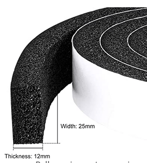

Yes that’s it!Here is the answer from Amazon with this query : fowong Foam Weather Stripping, 25mm(Width) X 12mm(Thick), Open Cell Foam Tape Adhesive Rubber Strip Maximum Compression SoundProof
Is it the product you use?

@BurntCoilHere is the answer from Amazon with this query : fowong Foam Weather Stripping, 25mm(Width) X 12mm(Thick), Open Cell Foam Tape Adhesive Rubber Strip Maximum Compression SoundProof

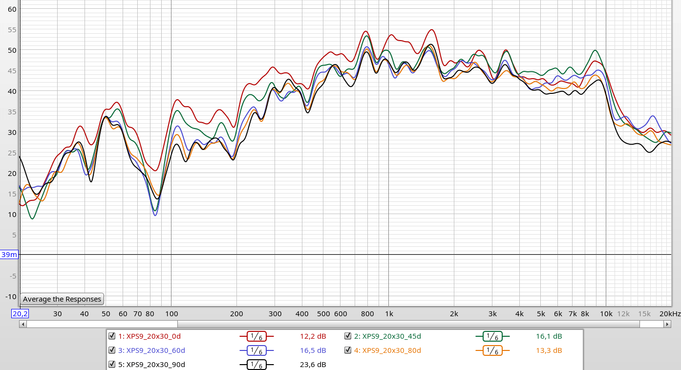

Here are some measurements. It was a 20x30cm 9mm XPS I used for test purpose. It was indoor measurements at 1m. If I remember well, the panel was in a fixed position and I changed the mic position.

- red = 0°
- green : 45°
- blue : 60°
- orange : 80°
- black : 90°

That is pretty clear, thank you homeswinghome. So it confirms there is in practice no drop off in output edge on for thin panels. I will share measurements when I make them.@BurntCoil
1/6 of octave smoothing, no frequency dependent window. Let me if you want another REW setting.
- red = 0°
- green : 45°
- blue : 60°
- orange : 80°
- black : 90°
