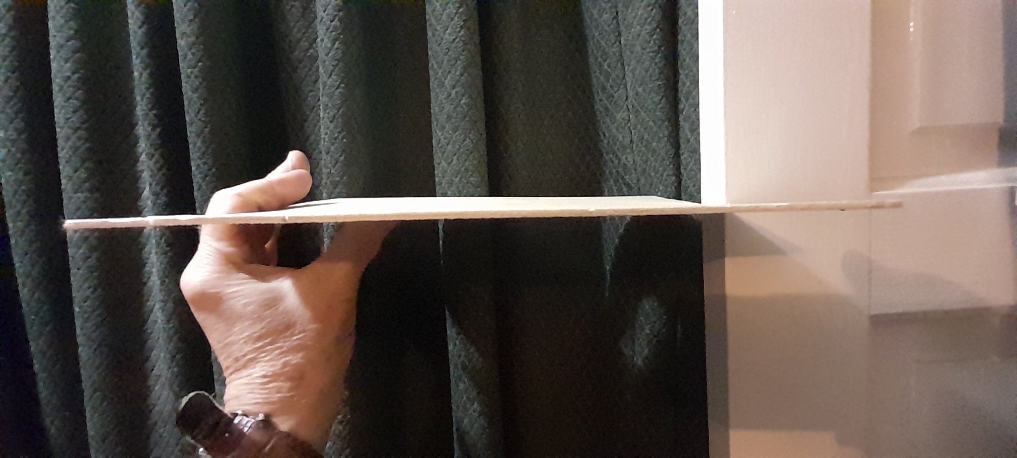

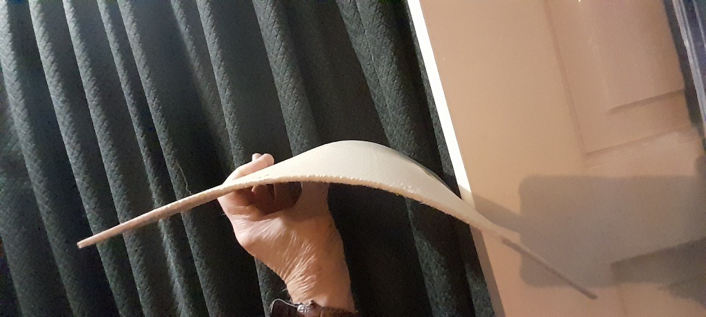

This is my( floppy ) crate ply, I have mentioned before, that it bands more in one direction than the other.Don't think so Steve - Its uni-directional ply (i.e. all layers running the same way) and you order it to bend either in the long or short direction
(It'd make a rather floppy crate)
Eucy
Steve.
Hmmmm ok Steve. That's pretty bendy...3mm 3ply is also much more bendy across the grain because it only has the central ply running crosswise ... Of you have bi directional layers then that would be more of a std 3ply I would think...Also depends on how thick each ply is.Using the same sort of pressure in the other grain direction.
Steve.
Eucy

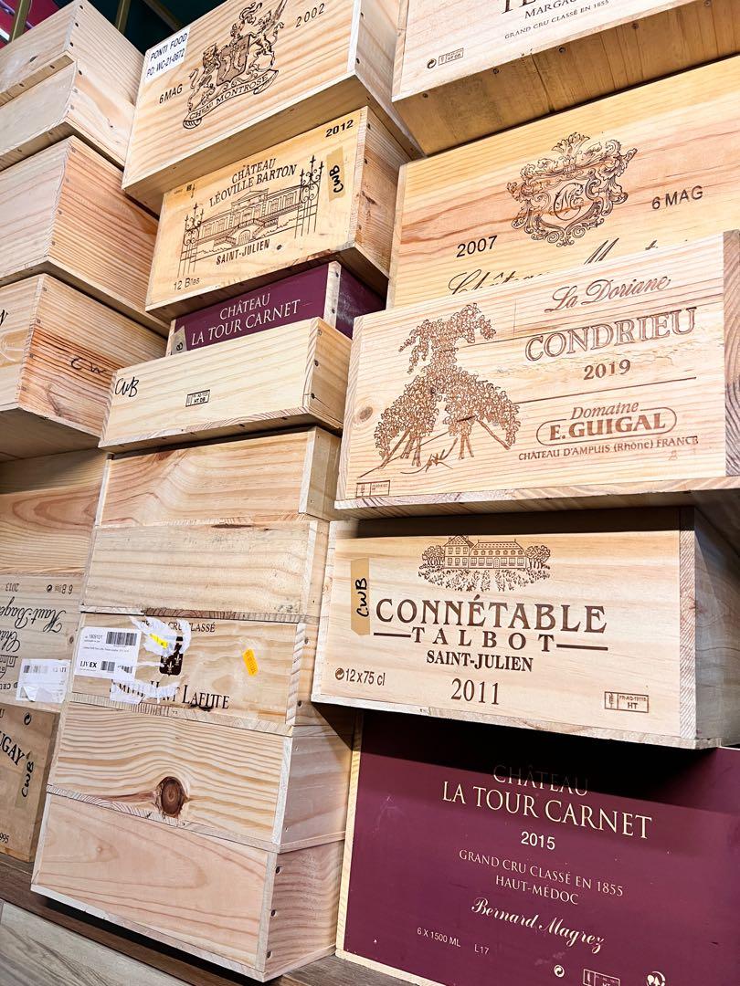

We use EPS or Plastic box to replace crate long time ago. The only crate I found here is the Wine box. I think it may be a kind of Pine?
However the Wine box wood is quite light weight but stiff, cannot blend like what you did. And mostly are 1cm or thicker.

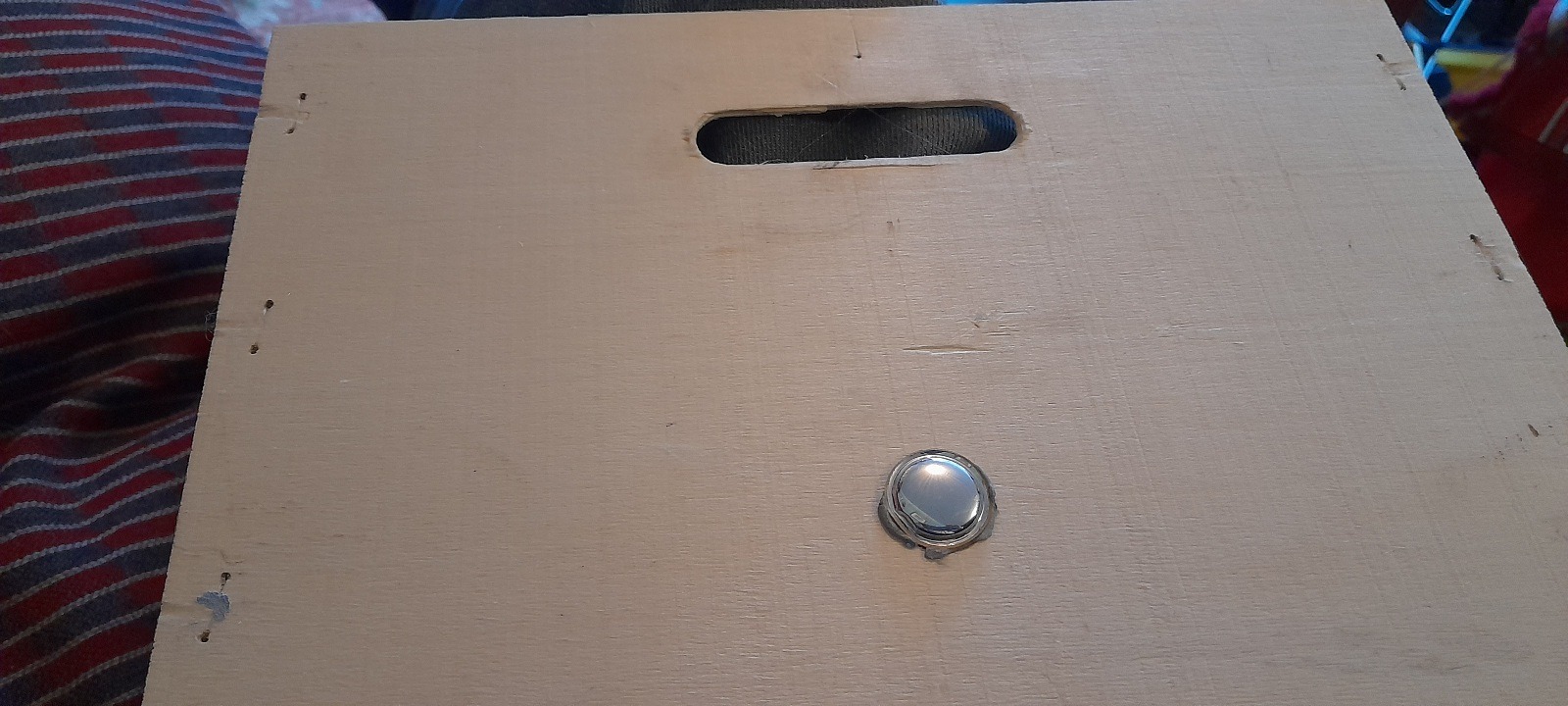

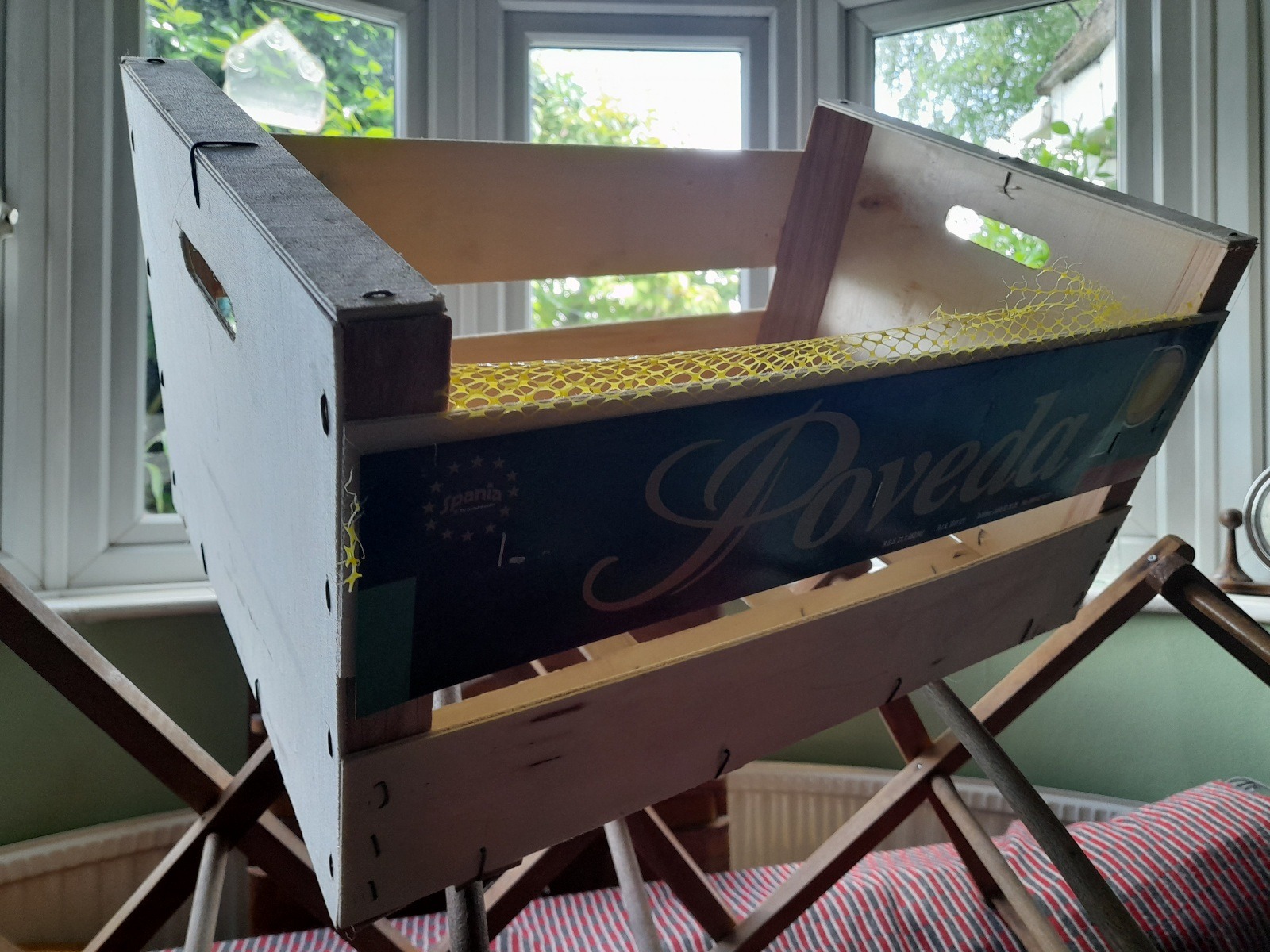

The ply is 3mm from this crate.
The second picture is of the end of the crate with a dust cover removed from a small cone driver, glued onto the exciter area.
The 4 thin sides I made into a single large panel by glueing them together with pva.
Steve.
Steve.
