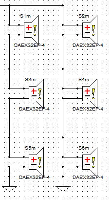

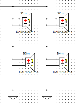

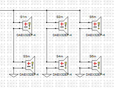

I'm assuming 90dB sensitivity (given 2Vrms @1khz into approx 3.5Re per driver)Lets say you were going to use (6) six exciters rated at 4 ohm\25 watts to drive a large 4x4 panel. Would you wire (2) lots of 3 in series then wire the lots of 3 in parallel to get 6 ohms. Or would you wire (2) units in parallel three times and wire the result in series to get 6 ohms? Which would perform better as each exciter is rated at 25 watts, which results in higher power handling and sensitivity?
I've added sketches for clarity where necessary. Loads highlighted in red are not a good idea. Numbers are as follows:
- 2 units only in parallel = 94.6dBSPL, 1.6r load, 2 x 25W = 50W nominal power handling.
- 3 units in parallel = 97.6dBSPL, 1.1r load, 3 x 25wW = 75W nominal power handling.
- 4 units in series-parallel = 93.8dBSPL, 3.5r load, 4 x 25W = 100W power handling.
- 2 string of 3 units in SERIES, = 93.5dBSPL, 5.4r load, 6 x 25W = 150W power handling
- 3 strings of 2 units in series = 97.1dBSPL, 2.4r load, 6 x 25W = 150W power handling
The most efficient is obviously the last one which delivers 97dB/W and can handle 150W
The "power handling" tell you what size amp you would use IF you were driving pure sine-waves into whatever load your configuration presents. But a music signal, driven at maximum output power, will only deliver about half that wattage into the driver. Therefore, you can safely double the size of the amplifiers AS LONG AS YOU DO NOT CLIP THEM.
Does this help?

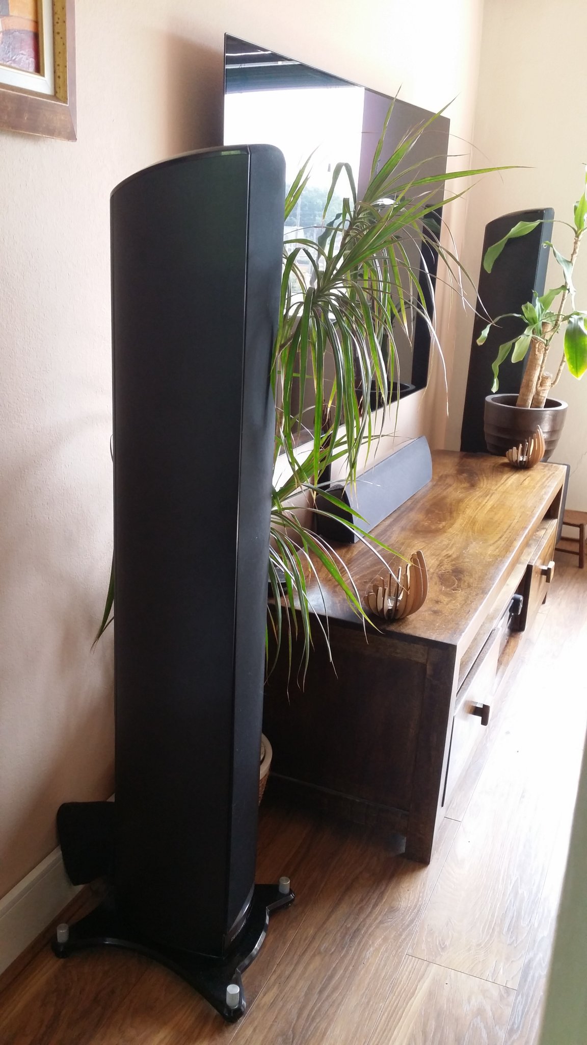

On page 304 post #6073 I explain how I made my center channel DML's to go along with my right and left DML's. The 2 centers are 8" x 14", over-under TV. The thin stretchy material I used to cover them to quell the highs a bit could be of any color or design of your choice. I made two short ones instead of one long because it just worked out best for mounting in my situation and it allowed me to wire my two 4ohm into a single 8ohm. I always wanted to try that over-under configuration anyway. Working great so far, voices sound very clear.Hi all 🙂
This has probably been asked before but I couldn't find an answer:
- Could a long and narrow DML be used as a center speaker, placed horizontally under a 65" TV?
Edit : ... with a subwoofer
On this post by unaHm he talks about his experience with the distance from the wall , while using the canvas panels.Well, this is another project that I've finally been able to get around to!
So this became a fun family project, where my daughter offered to paint the canvases with acrylic paint. We sealed it with Gesso, and then she went to work with her designs.
I noted in the thread that 'drum tight' was ideal, so I jammed sticks in between the frame and the canvas, and made sure that both were 'tuned' the same.
I also noted that they sounded best, I think, 6-7 inches from the wall. Initially, I had them mounting on picture hooks, and as one can imagine they sounded a bit strange, so fortunately for me my wife let me get a pair of 6"x8" shelf brackets that I could hang them from. In this case, 6" still wasn't right, but flipping the bracket to allow the speaker to hang 8" from the wall gave the best response.
They're perfect for a living room. Great voice intelligibility, and Bass that makes you think there's a sub tucked away somewhere. I'm using one of the Lepai LP2020A (if I remember correctly) amplifiers, so there's nothing special driving them. I'd highly recommend these for a listening room, and the WAF is very high...to the point that, dare I say, my wife was excited!

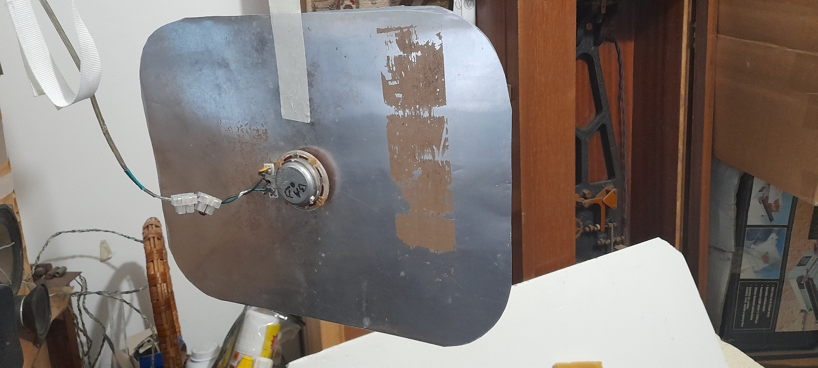

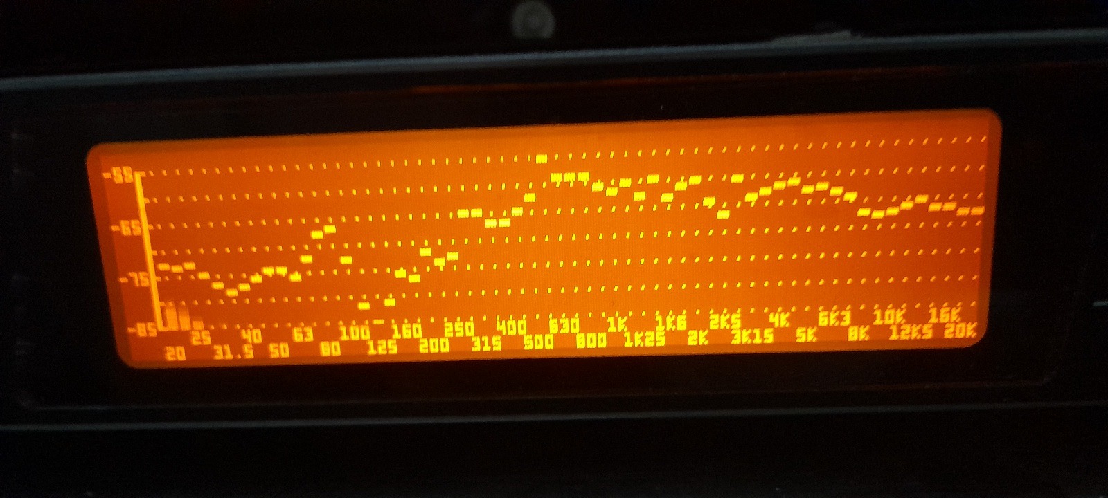

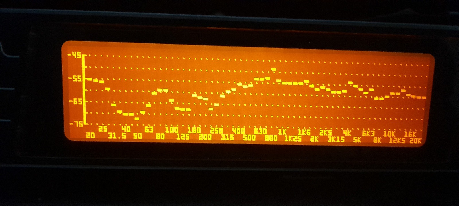

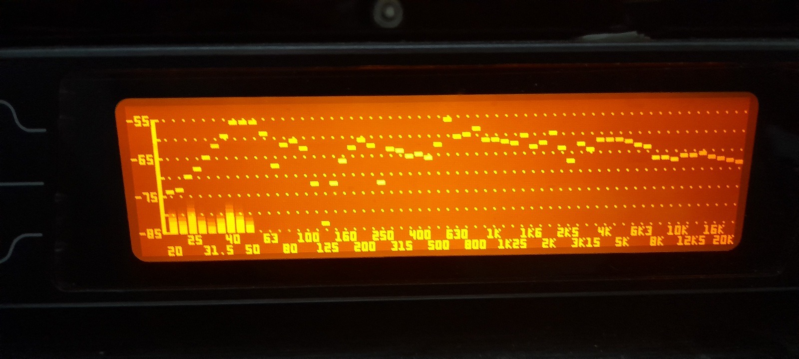

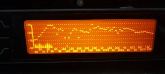

Late last night I suddenly decided to make up a thin sheet aluminium panel ,it is approx 10x13inches and less than 1cm thick.
I glued 2 sheets together with Evo-stik as the spray mount had gone off over the years .
The Evo-stik was getting pretty old as well and was not as thin as it used to be.
But it did the job.
I used it to glue on the exciter too, as I was in a hurry, it was getting late.
Pic 1 is the panel.
Pic 2 is the response at 3m.
Pic 3 is with the TLs xo at 220hz.
Pic 4 is the panel at 1m.
The panels will be xo at 90hz as this exciter has problems with rubbing coils.
You could get away with a 160hz sub roll off, I think.
In my room anyway.
Steve.

The response is not as smooth as the large sheet I used to have , but I guess there is more dml action going on on this smaller panel ?
