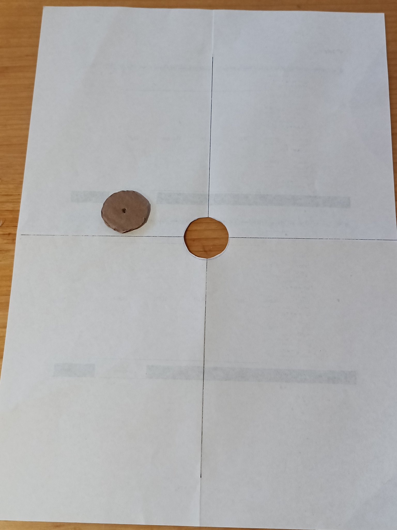

You will need to accurately measure your exciter voice coil diameter. Some exciters have quite wide mounting flanges so try and discern the actual bobbin diameter. Usually the specs will tell you the diameter but check anyway.
Then you need to make an accurate male template to the coil diameter from cardboard or other object matching the required diameter.
You will also need to make a female paper template cutout approx 2mm bigger in diameter than the coil with axes marked... The easiest way is to fold an A4 piece of paper in halves both ways, ink in the fold lines, scribe the circle and cut
Like this:

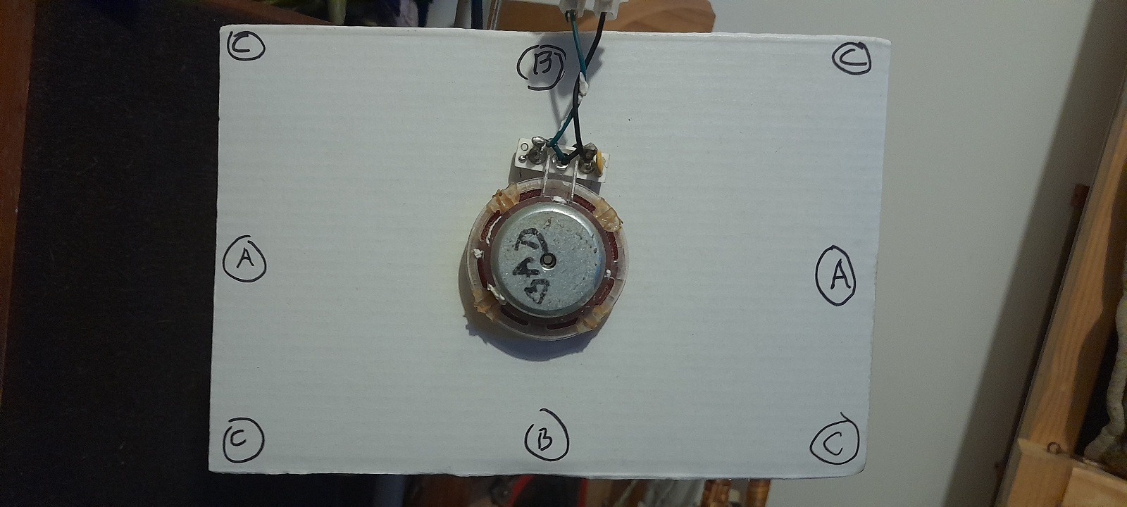

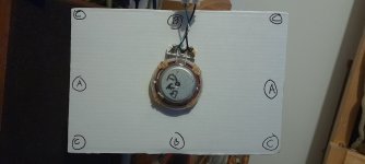

While I was playing around with different positions for adjusting panel response, I suddenly thought, why not show the difference in a recording.
The picture shows 3 different finger positions, the third is will my hands touching the 4 corners.
