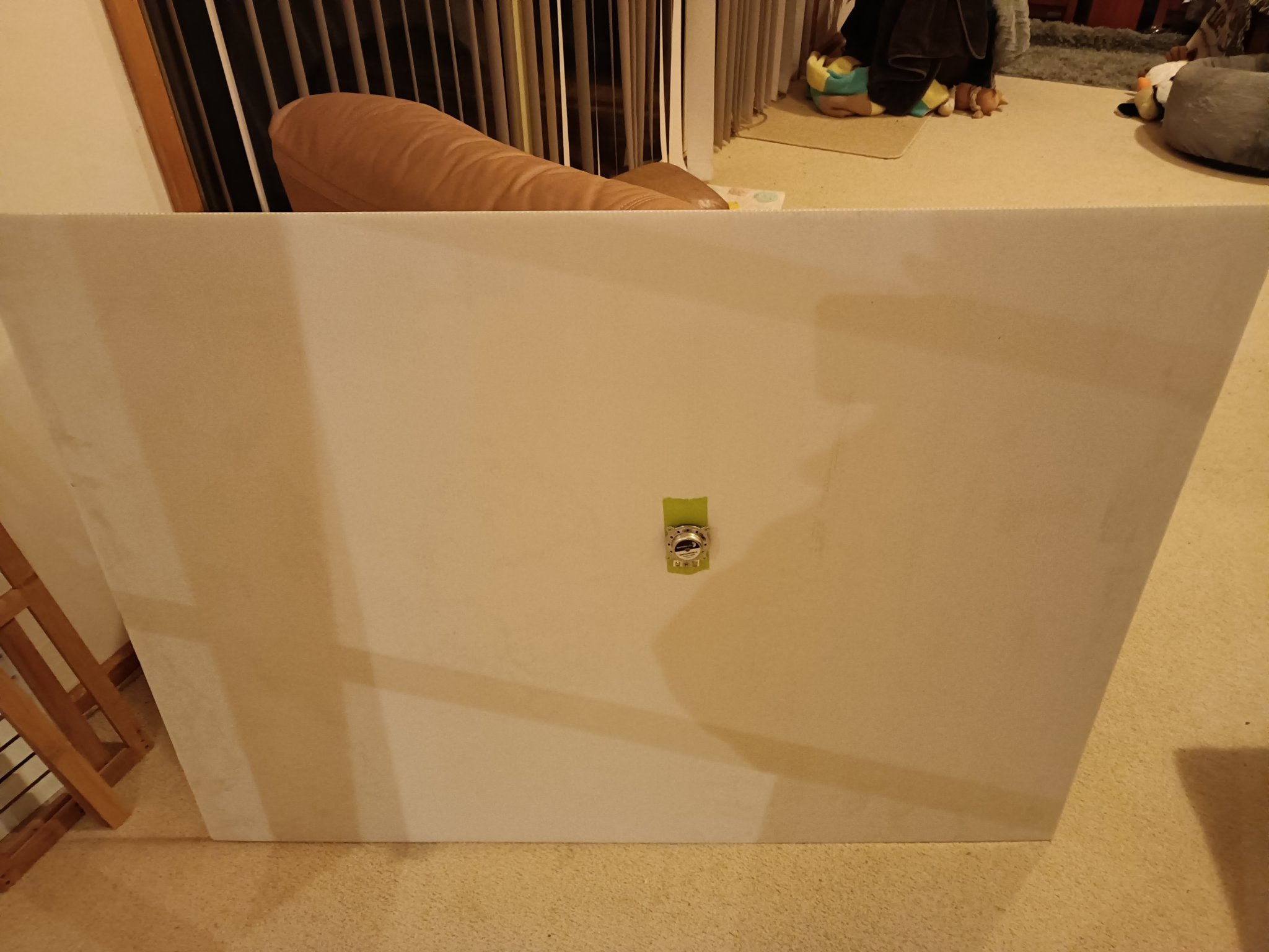

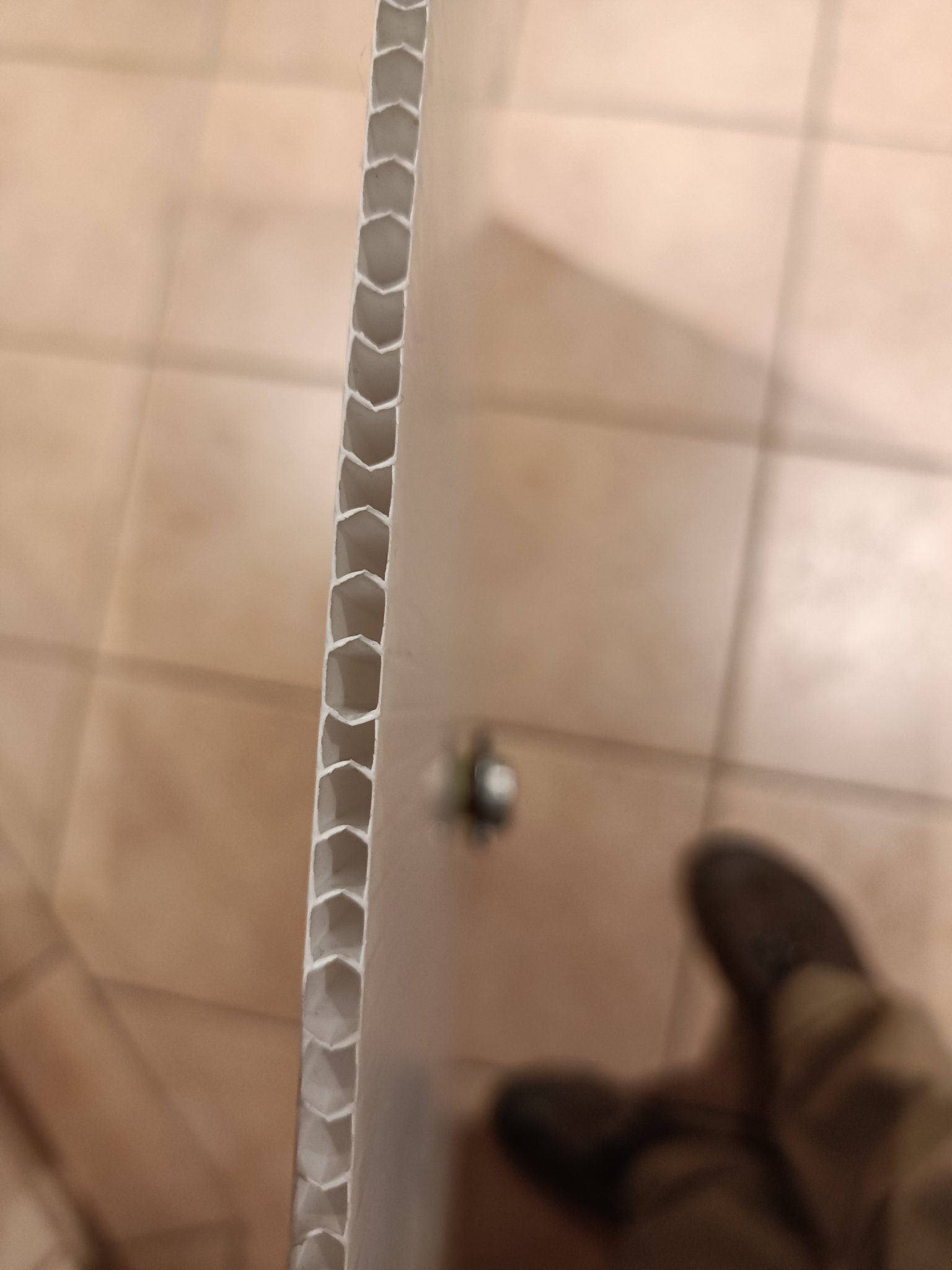

Any chance of a couple of pictures of the flutes and panel.
Steve.
Pics attached..I think the v shapes in the flutes at the end are from the cutting of the sheet.. It's still stiff despite the kinks
This is the 24w exciter
Cheers
Eucy
SteveThis dome is very thin and light, it will be interesting how it sounds and measures .
I will glue the second dome to an exciter coil foot ,without the panel .
I only used the 50x50 pva mix , but it still feels quite hard and solid.
I thought it might be a bit softer.
Like a fabric dome.
I may have to go back to the thin cotton sheeting.

Eucy.Steve
The flutes are square.
I believe it's important for the exciter to have as direct a contact with the front radiating surface as possible. There's a paper somewhere which examines the loss of hf through distortion in the voice coil former by compressive forces, and I think the same is happening in the thin ribs of these sheets in the coil area.
If it was possible to inject expanding foam locally it would work I think.. Have to think on it. Cutting a hole will damage the flexural properties I think, particularly given the ribbed structure and polypropylene's bonding properties
As for the hump, I ran my ear along the open flutes and yes, there's a distinct increase in volume at the end of the flutes along the line of the exciter. Stands to reason.. They're acting like an acoustic tube. Maybe it favours certain frequencies depending on the tube length (distance from the exciter to the edges). I taped up a section and it seemed to decrease it

The measurements I made of the proplex panel does not show any signs of any nasty peaks from the central area, so it is well controlled.
I have only tried domes on thin materials , except for thinned eps.
3mm ply should be OK.
I think the high frequencies are probably travelling along the flute struts as this makes the panel more rigid along the flutes , and why the frequencies are stronger on the struts that have the exciter on.

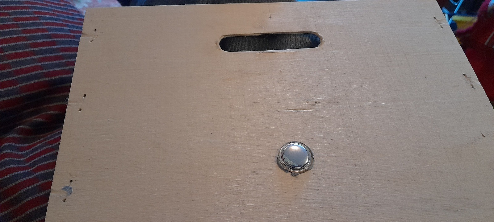

Eucy.
This is one of my crate ply panels with a centre voice coil cover off of a small cone driver, I stuck it on with bluetack, for quickness.
I have stuck various cone materials on different panels.
But have come to no serious conclusions.
