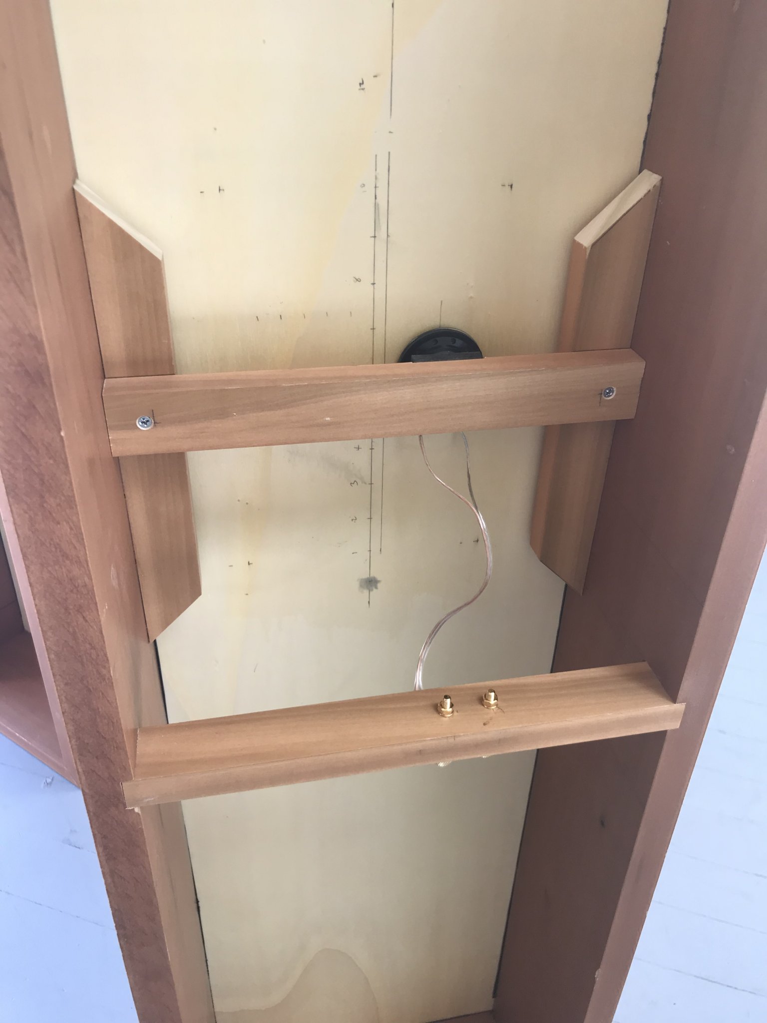

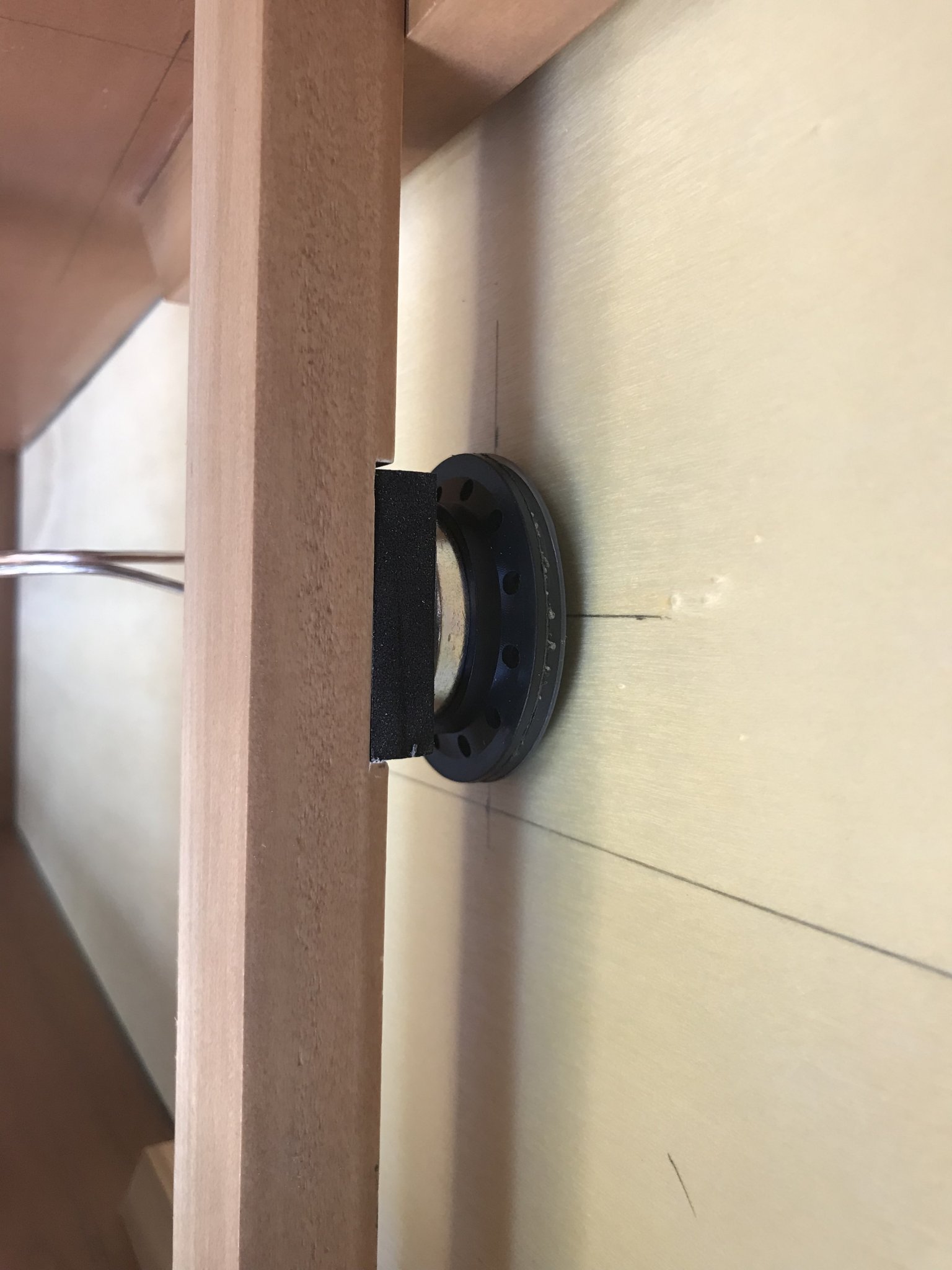

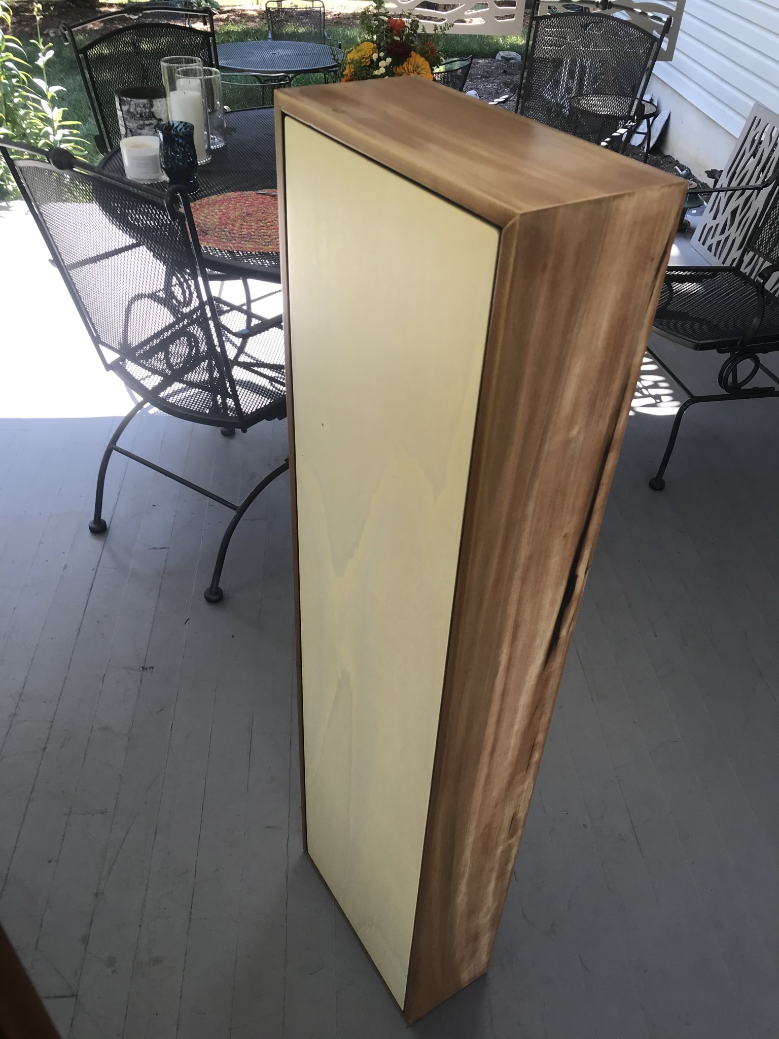

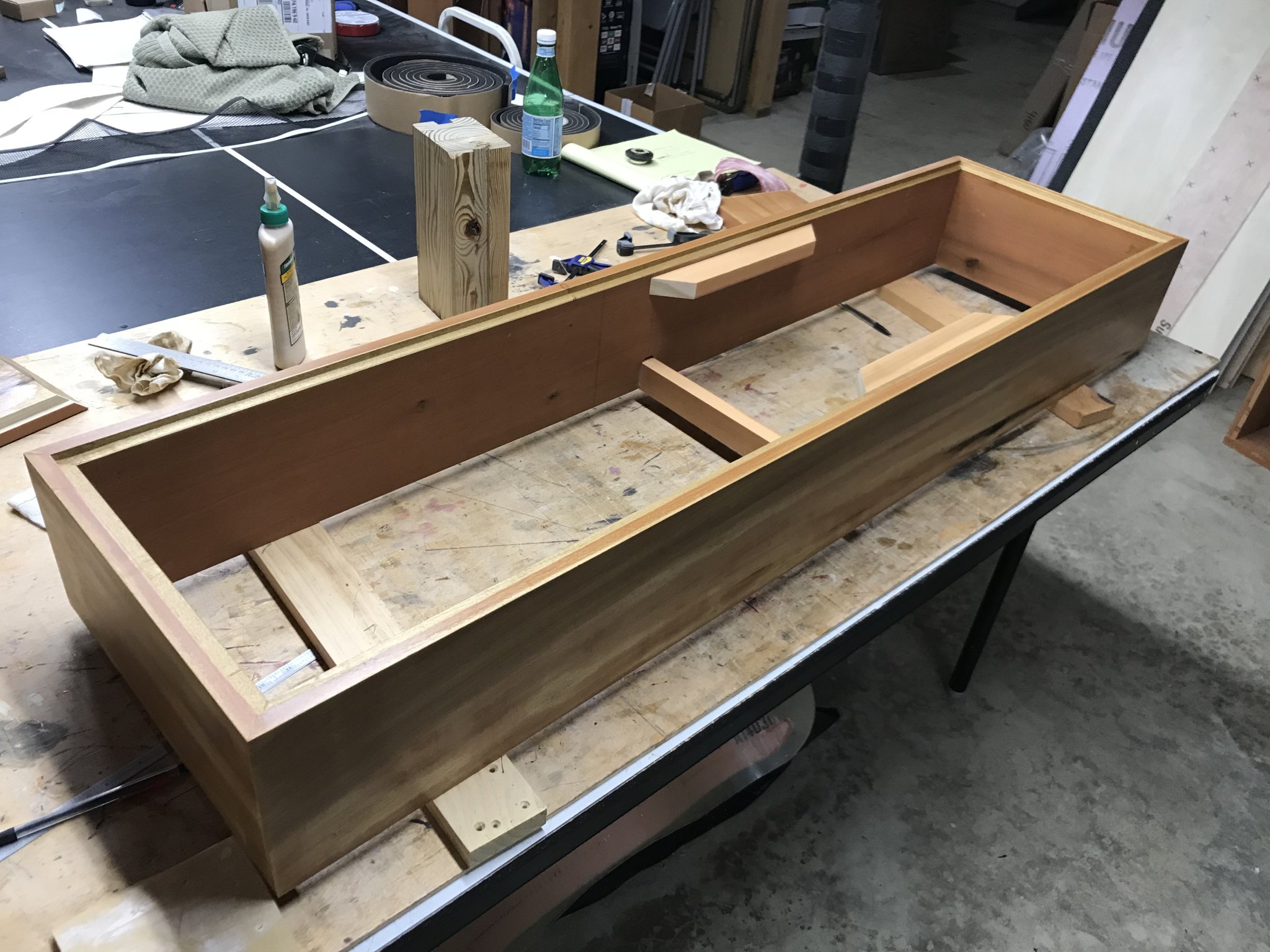

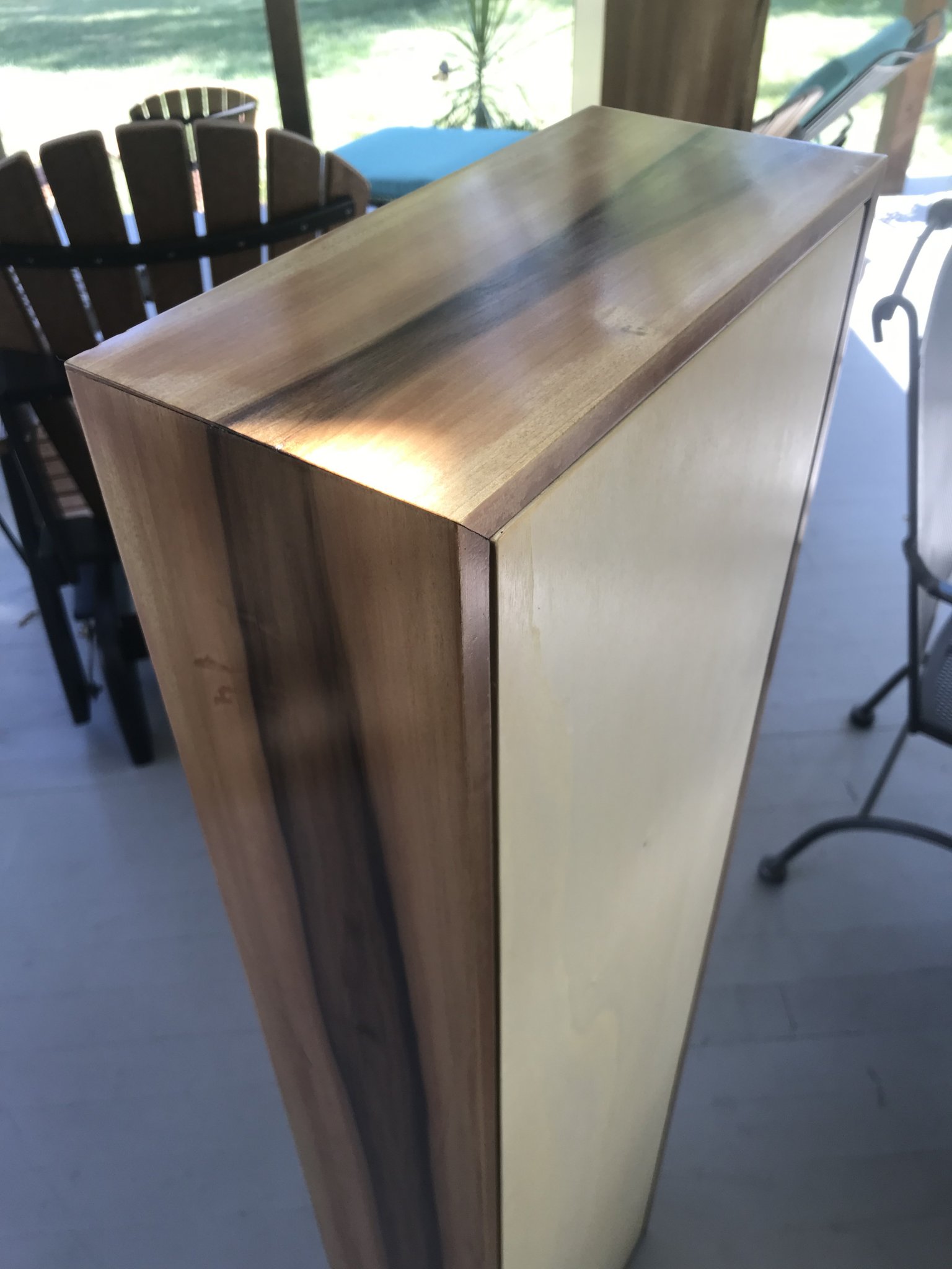

More details:
Panels are 12" x 48" 5-ply poplar plywood, 0.23" thick.
Frame is 1" x 6" poplar, and includes a brace on the backside.
Panel is mounted to frame with 3M Extreme double sided mounting tape, 3/8" wide, around the entire perimeter (except about 1 inch from each corner)
Exciter is DAEX25VT-4 (one each panel).
Exciter is offset from the panel center by 1.25" across the width and 6" along the length. A piece of EPDM foam is placed between the exciter support and the back of the exciter.

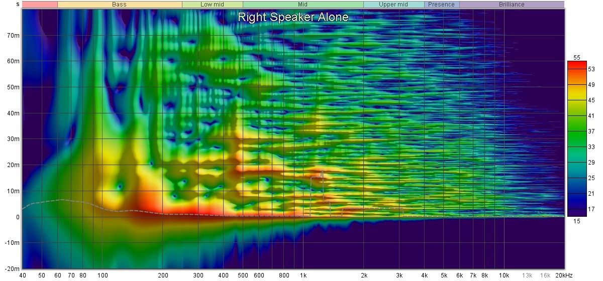

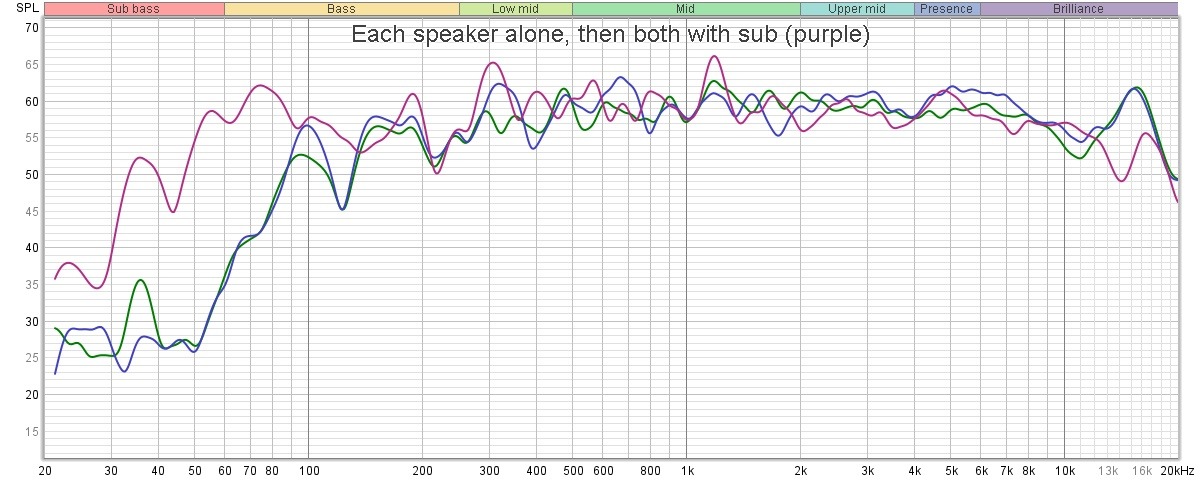

And some measurements:
Here are the frequency responses. For each speaker individually, and with a sub added (purple)
And especially for Christian, here is the Spectrogram (wavelet), for the right speaker alone, which I think shows that the resonances are reasonably well controlled, but not completely eliminated.

Great looking build Eric ! Thanks for posting all the info. Wondering what sub your using with them.And some measurements:

Pete,Great looking build Eric ! Thanks for posting all the info. Wondering what sub your using with them.
Thanks for your kind words. The sub is a Polk PSW10, about the cheapest sub you can get, I think. I bought a SVS 1000 Pro for the main living area, so the Polk was available for me to move downstairs to the lab.

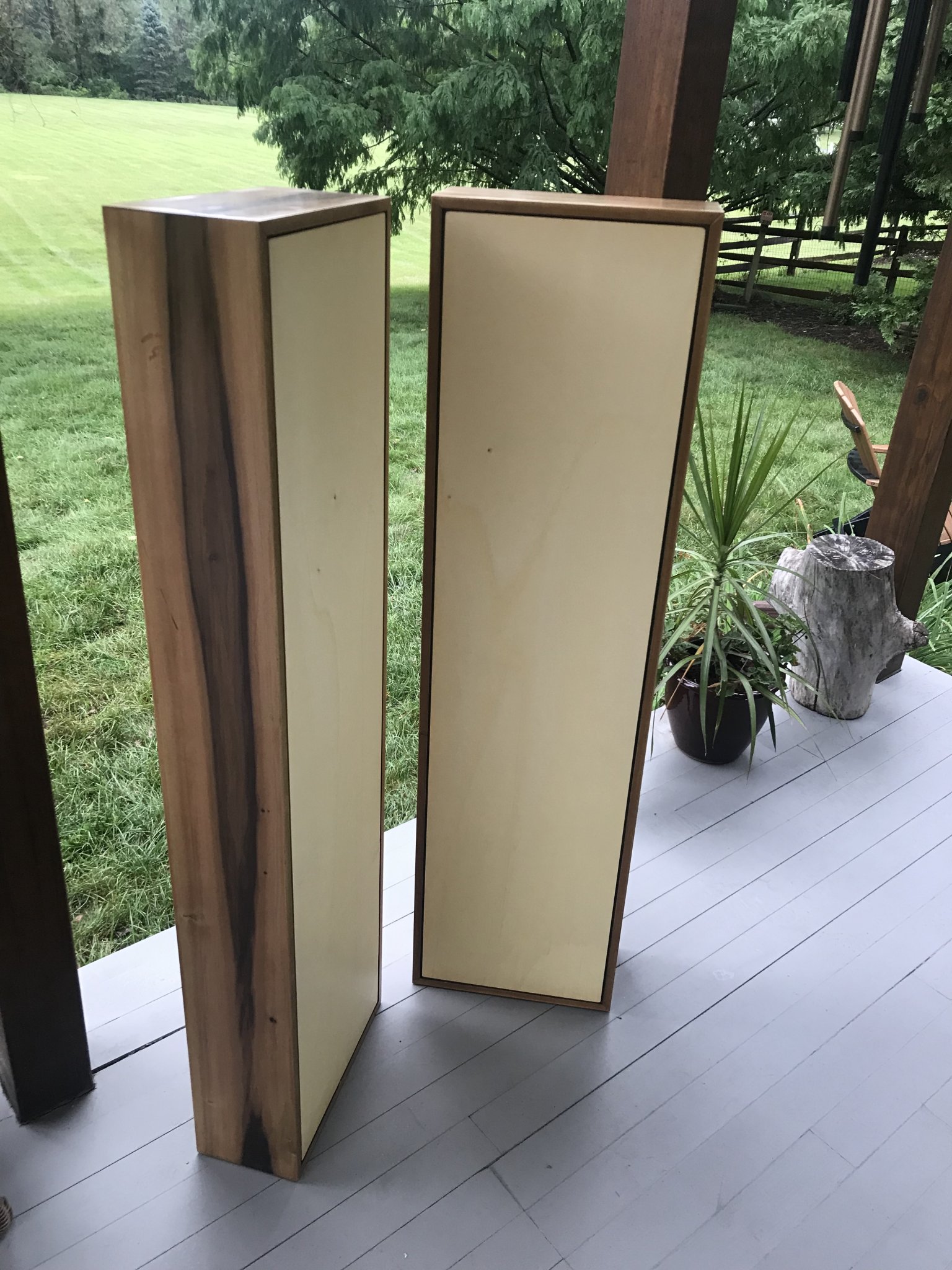

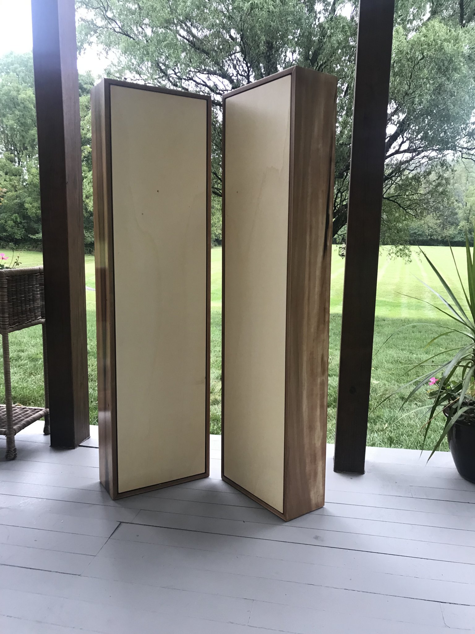

Very nice realization Eric. They might sit in our living room with no difficulty (I am allowed to have some prototypes here if not yo ugly of course!)Mostly I've been building individual speakers as one-off prototypes that get mesaured and then disassembled. But I decided I like the "high aspect ratio" concept enough to go ahead and build up a permanent pair. The main objective really was just to make a pair of working speakers for my basement speaker "lab". Since they werent going to be "on display" in our main living area, my original plan was to not work too hard on the finishing/woodworking aspects, and just kind of throw together a half decent looking pair. In the end, however, I spent a lot more time on the finishing aspects, and now I'm not sorry I did since I'm pretty pleased with how they turned out.
Eric

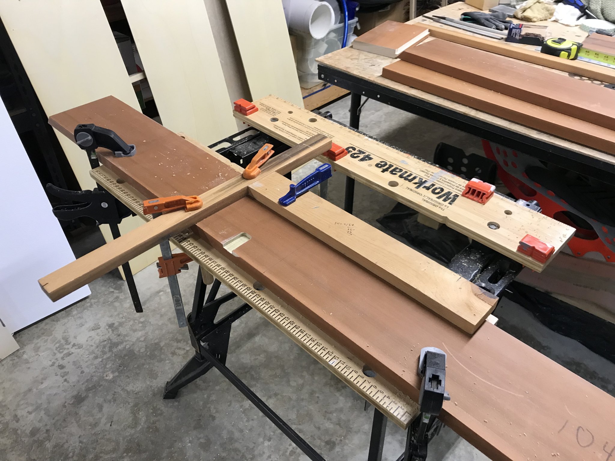

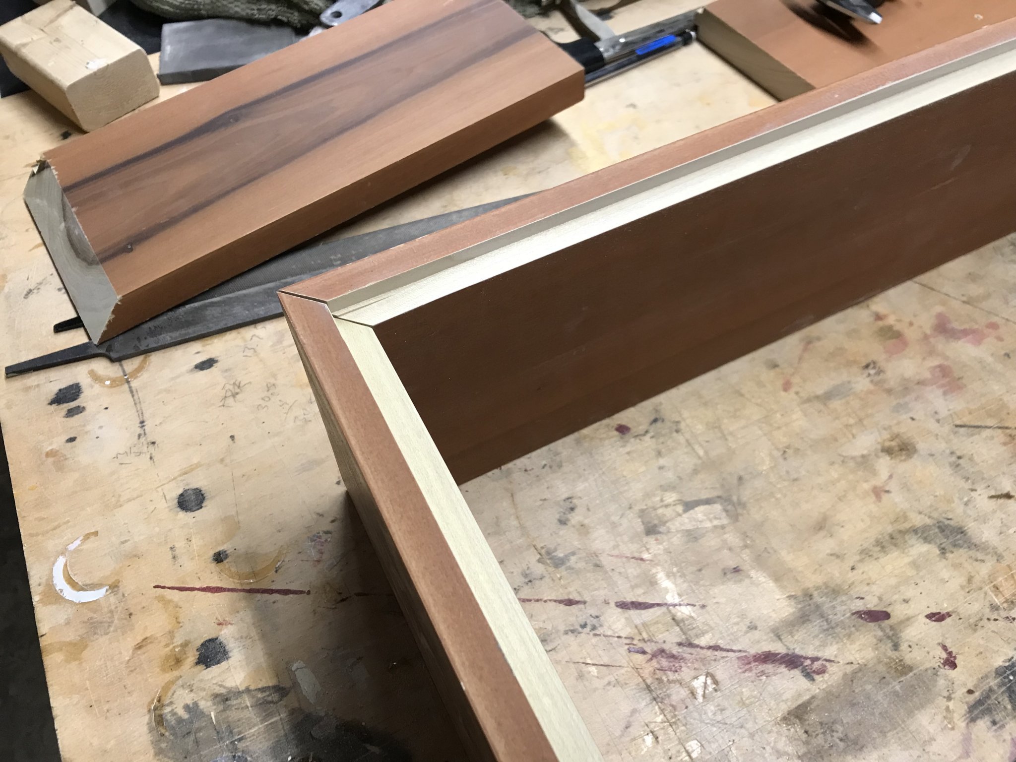

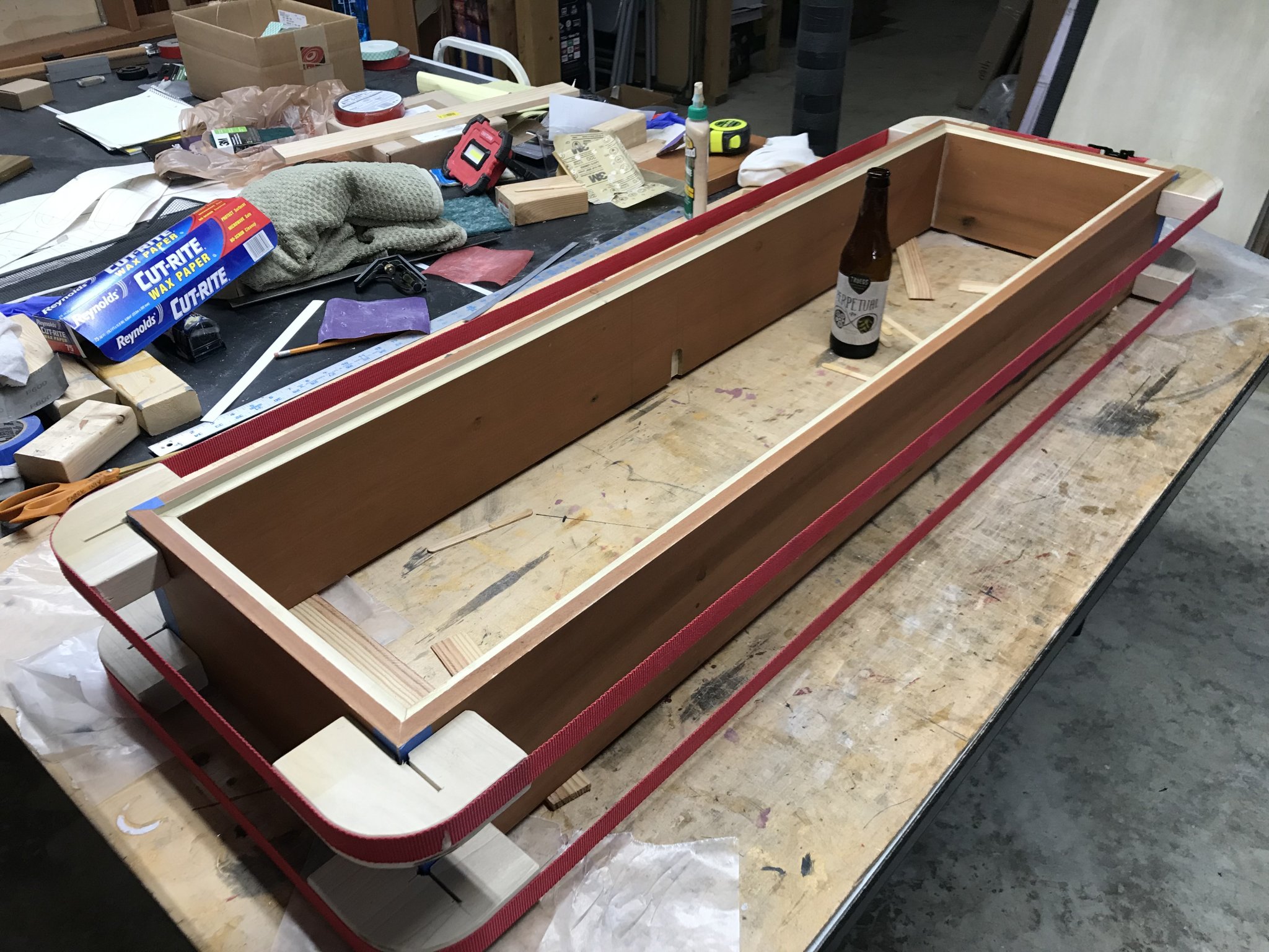

View attachment 1090213 View attachment 1090216 View attachment 1090214 View attachment 1090215 View attachment 1090224 View attachment 1090225

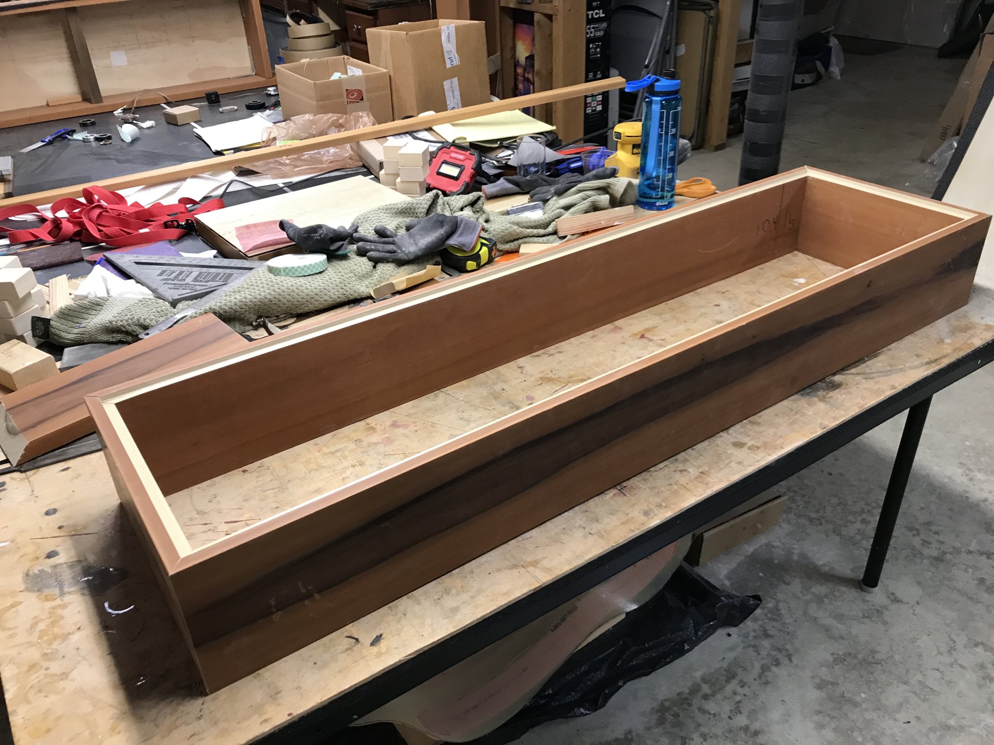

Here are a few pics from the construction:
View attachment 1090218 View attachment 1090219 View attachment 1090220 View attachment 1090221 View attachment 1090222
Would you mind to communicate some basic characteristics as listed in the "history file", any information that might help to follow your example, some measurements, listening comments?
In the history file : membrane (dimension, material, thickness, coating...), exciter, exciter/membrane interface (VHB, epoxy, PVA...), exciter position, frame depth... and what is my current main question : suspension (what, where).

Hi EricMore details:

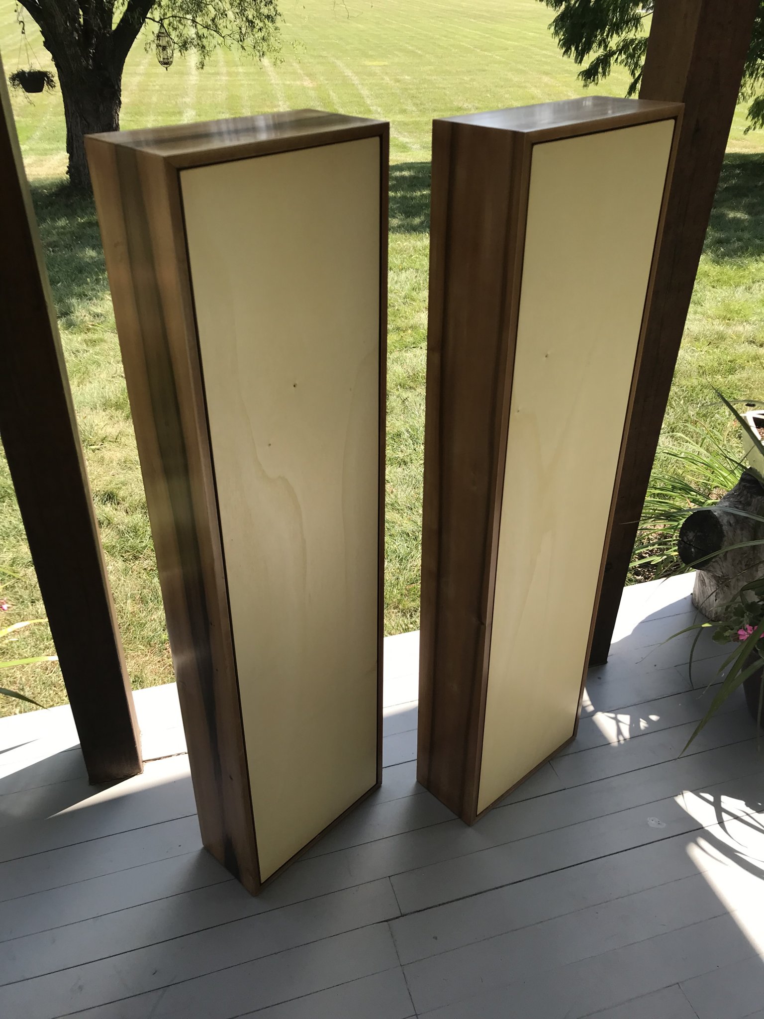

A very attractive build... Well done!
I like the contrast between the frame and panel, and the pale poplar looks great.
A couple of questions:
1/ The frame material is interesting.. We can't get poplar in frame sizes in Aust Was it pre-finished? ... Looks like it on your bench
2/ I'm interested to know if you tested the panels with and without the deep frames. I have found that such framing can have a noticeable tunneling effect on the sound which I assume is due to refection of the rear waves
3/ The exciter you chose is one I haven't tried... Looks quite good value. Have you used others, and if so, how does this one compare?

For the construction details :
- Is there a coating or a finishing layer on the ply? front and rear?
- How the exciter is linked to the panel? Original VHB?
Christian
