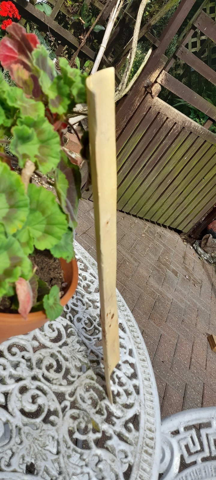

Last night I applied some egg White to a strip of 1.5mm wood from the crate.
When I applied the egg White the wet surface eggxpanded 🤣 sorry I could not resist 🤗 and bowed upwards.
But when it dried it had bowed the other way.
This morning I coated the other side which made the wet side expand the other way as in the first picture.
But when it dried it pulled the strip of wood back into place as in the second picture.
So egg White does cause tension on the surfaces, a slight stiffening.
I should of weighed the panel first 😱
Never mind.

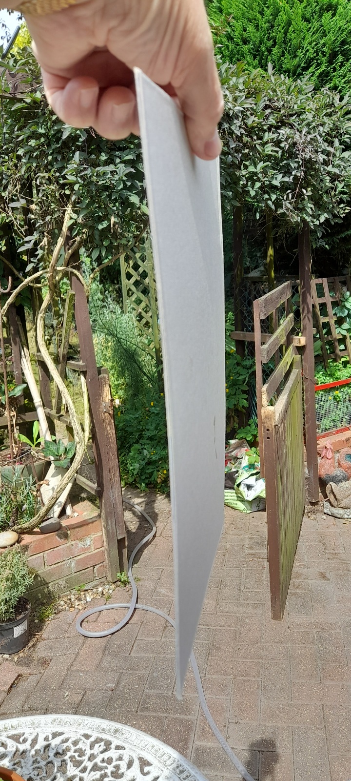

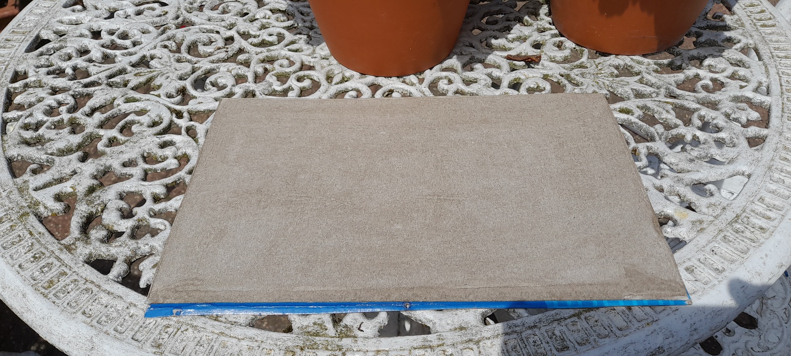

I applied a couple of coats to two small pieces of card before trying to egg White them together, it looks like it has stuck but I'm not sure it is a good enough bond all over ?

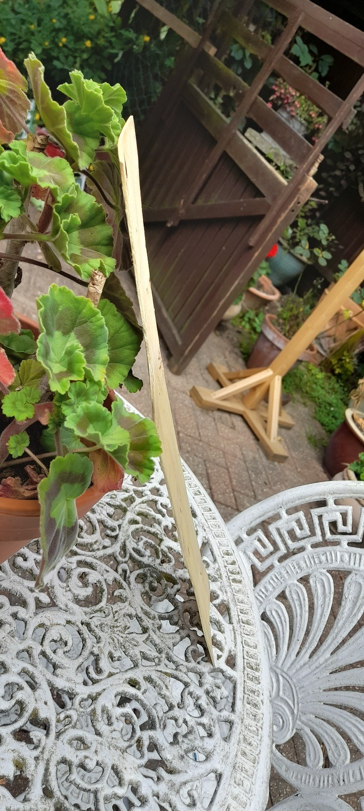

Hello SteveLast night I applied some egg White to a strip of 1.5mm wood from the crate.
Never mind.
Steve.
Funny experiment. The tension seems high.
I just had a look at the possibility of egg white as glue ingredient... not convinced by the performance even the need.
Egg white appears more has a binging (correct binding? ingredient that links the other ingredients) agent in painting but it is the yolk which is used (tempera)..
Have you tried the grain filler property of egg white?
Christian.
The strip of wood I use was pretty rough and the whites just soaked straight in .
I must admit I started this , and I am wondering why ?
Just thinking about it, I have coated one of my crate ply panels in pva, and I could coat the other in egg White and see if it sounds any different?
Then maybe I will leave it there, and move on .
Steve.

Hello Steve & Christian:
Please don’t get the impression that I’m stuck on only the large panel size. I’m open to all. While I wanted to do my first build with 3mm Baltic Birch, it seems it will be unavailable indefinitely. Thus, the search for alternate materials. Today I found Marine Grade Meranti 1088 ply in 3mm. The price is affordable. I’d like to know your thoughts on this material?
If it is not stiff enough, I could always try the egg was? Also thinking I should stay with the 3-4 width to height ratio?
Maybe 24 x 32 in. or 60.96 x81.28 cm?
