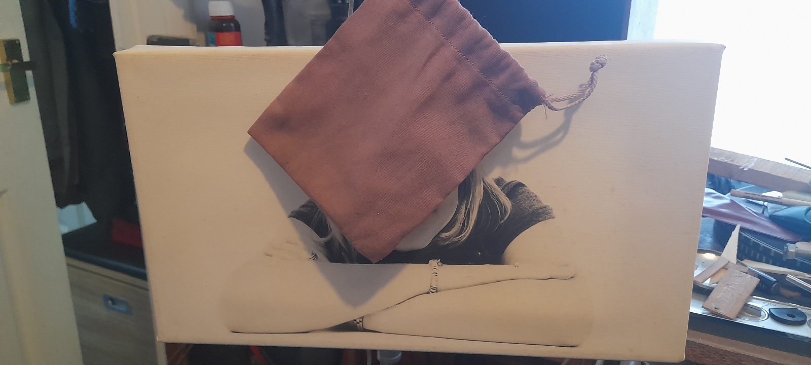

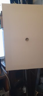

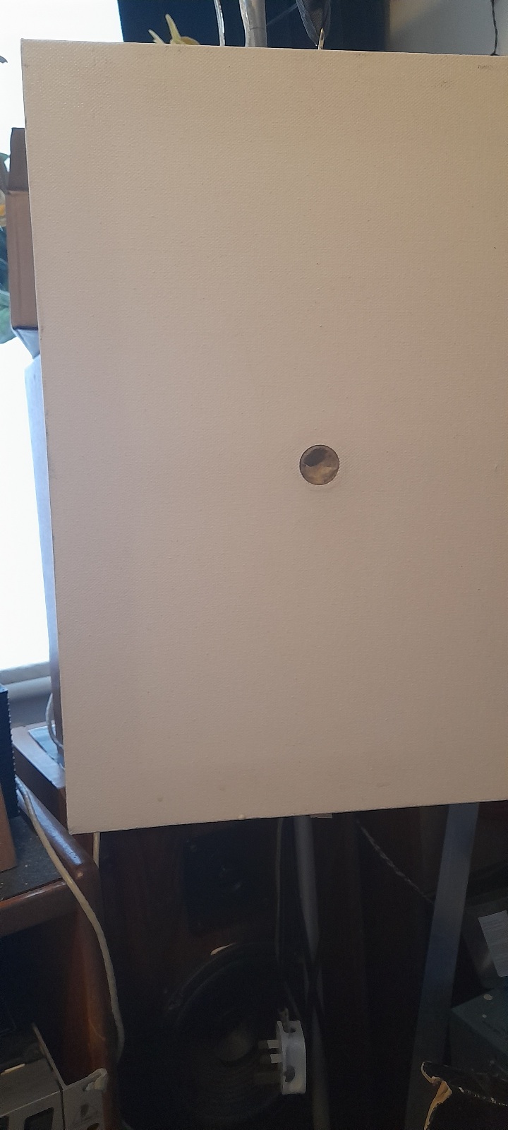

while waiting for the exciter glue to dry on my card panel, i put up my canvas only panels(no ply) and thought i would make a recording for comparison to the other two recordings of another cup of coffee.
there was a dent in the larger canvas panel ,from leaning on another panel i wiped it with a wet sponge and it tightened strait away .
the other smaller panel has a very loose canvas , i did try and tighten it but it was not easy with the exciter already attached !
these both roll off below 300hz but i let them go down to 120 as there is still some useful output .
the TLS roll off at 300hz as usual .
steve.

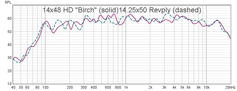

Pete,
As it turns out, the 5 mm Revolution Ply is quite well suited to the "high aspect ratio" approach that I have been investigating. The dashed green line below is the frequency response I got using a 14.25" x 50" revply panel. This is among the best (if not the best) response of all the hundreds of DML responses I have measured.
Revply is unusual in that it is stiffer in the direction perpendicular to the face grain than it is in the direction parallel to the face grain. That results in a particularly high density of natural frequencies when used as a high aspect ratio panel with the face grain running in the long direction of the panel.
The panel is mounted to a frame with 1/2" wide 3M 411 tape around most of the perimeter.
I'd be happy to share more details if you are interested in building something like it. The image below is of a similar construction, but using a different but similarly sized panel.
Eric

The larger of the canvas only panels in the left photo has had its dome dust cover pushed in somehow?
The smaller canvas panel in the second photo , which has the looser material .
This was an old canvas picture frame my daughter gave me many years ago , I think it is more a plastic than canvas ?
On the recording this is on the left.
It is only 14x8inches.
Steve.
