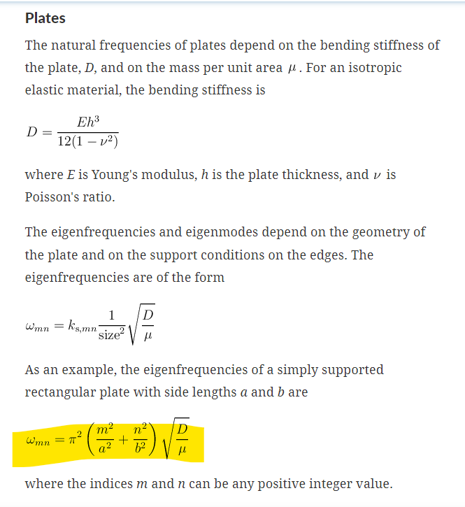

Eucy,
You can do it yourself I bet. Here's the equation:
This snip comes from here:
https://www.comsol.com/multiphysics/eigenfrequency-analysis
The f0=Pi/Area... version of the equation which you mentioned actually applies stricly only to a square isotropic plate and is a fair approximation for a "squarish" plate but as you get farther from square the approximation gets worse.
Note if you set m=n=1 (fundamental), and set a=b (square plate), the expression above simplifies to the "Pi/Area..." expression that you referenced.
Eric

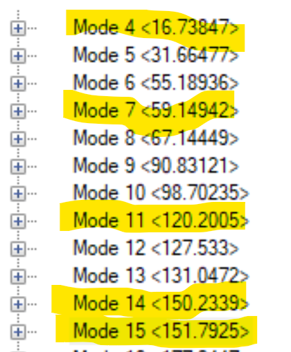

Hi Eric
900x300x3mm poplar 3ply..don't have the properties to hand...apart from SG which is 0.4, Et/El .05 approx
Eucy
Eucy,
Here are the lowest eigenfrequencies predicted by LISA based on your numbers and assuming El is 10 GPa.
Highlighted in yellow are the predicted odd,odd modes. But without having strong confidence in the elastic properties (especially the transverse modulus), I would not put much stock in the model. And to be honest, I would guess that Et/El is closer to 0.1 than .05 with the 3 ply.
Do you have another sheet of the same or similar that's not mounted? You could do some tap tasting and we could probably come up with pretty good estimates of El, Et, and Glt.
Eric

Hi Eric ..
Thanks for running the model
I can do static deflection testing on some ply offcuts... Won't be for a while as I'm 1500km from home
I suspect you're right about Et, esp after some coats of shellac.
This is a good discussion with some useful feedback from all involved
Cheers
Eucy
