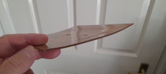

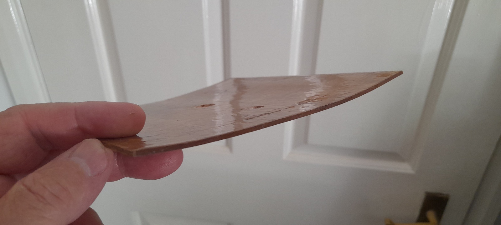

I'm back home and thought I'd take a picture of the warped 2mm veneer .
It was coated with epoxy on one side only, I removed the exciter to use on my crate ply panel.
Steve.

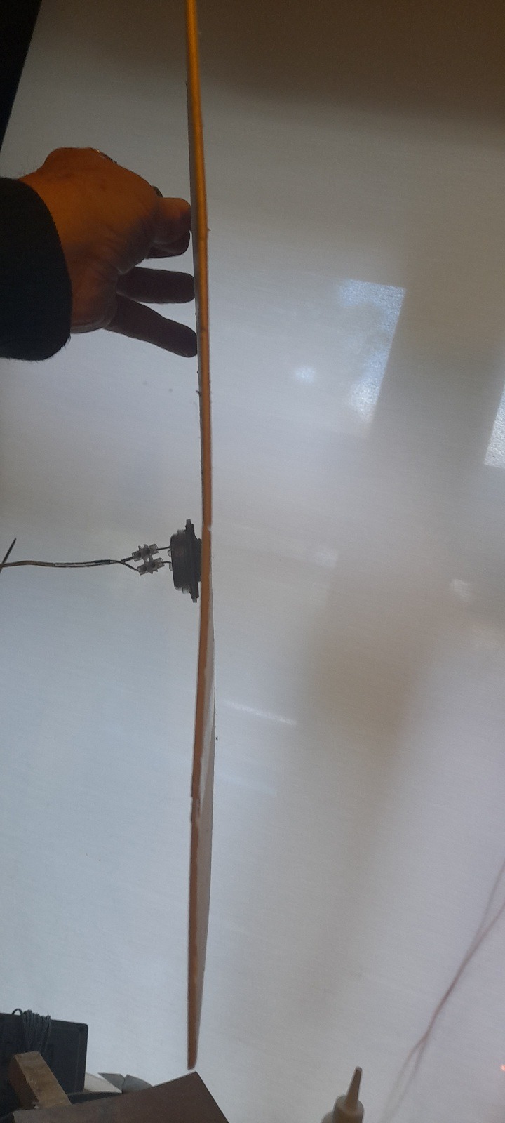

But in the meantime, this is a picture of the slight warp in this panel, not that bad considering it was 4 strips of badly warped crate ply glued together 😁
I'm not that bothered by slight warping.
And i have done nothing to this panel yet, so no coating ,no dust cone in the centre ,no weights , nothing!
Steve.

WOW, that is one hell of a precautionary tale !
I did think the epoxy fumes made my eye a little sore , but wasn't sure if it was my imagination.
I'm also suffering bad hay-fever and itching this year.
I'm now turning into a hypochondriac 🤧
