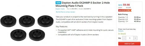

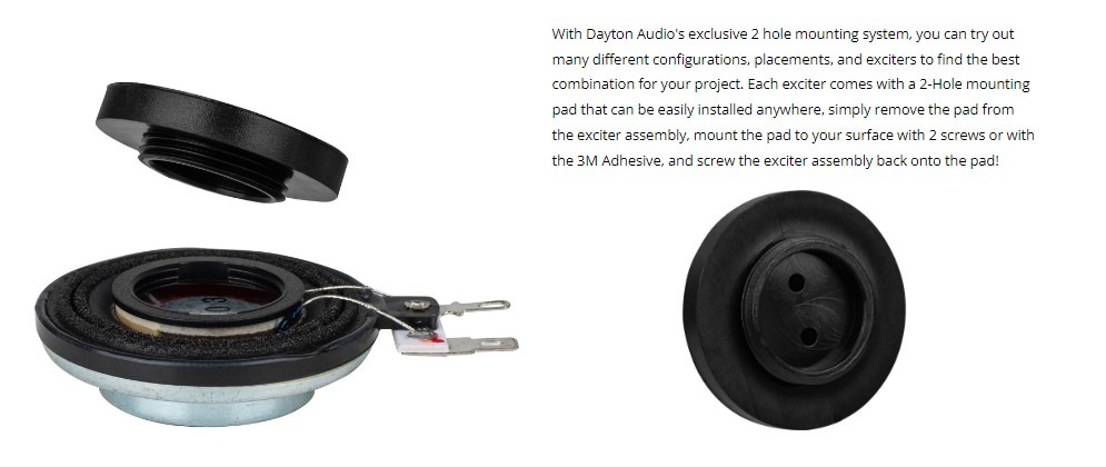

I just got the Parts Express ad, featuring exciters, and this is being offered. Sounds like a good way to test different materials using the same exciter, and the price is pretty good, too. All of their 25mm exciters come with one of these installed now
Hi Jaxboy.
As you say they are handy to swap a single exciter around different panels, although the panels will have 2 screw holes in them or glue?
But the sound will be impaired by the block of plastic between the coil and panel ?
So I sort of don't see the point ?
From my point of view anyway?
Steve.

Steve,
I wonder if you could shave the puck down so the pad is 1mm or so thick if that would improve their characteristics. That might make them so thin that they would snap too easily, though. Maybe if you shave the pad all the way off then glue on a thin pad of ply to the remaining center circle. Just brainstorming. I am satisfied with my artist canvases, so I am done experimenting.

Mmmmm, that sounds like an improvement to me.
The thread when glued to the panel , would get its strength from the panel, instead of the puck.
Problem solved.
If you had the time and patience, and the skill, that is 🙂
Or a 3D printer.

Steve,
Or were good with a belt sander. A person with a 3D printer could use very lightweight filament and copy the pitch and size of the thread, but making it much thinner and lighter, with a built-in thin pad, maybe made from a stronger filament.

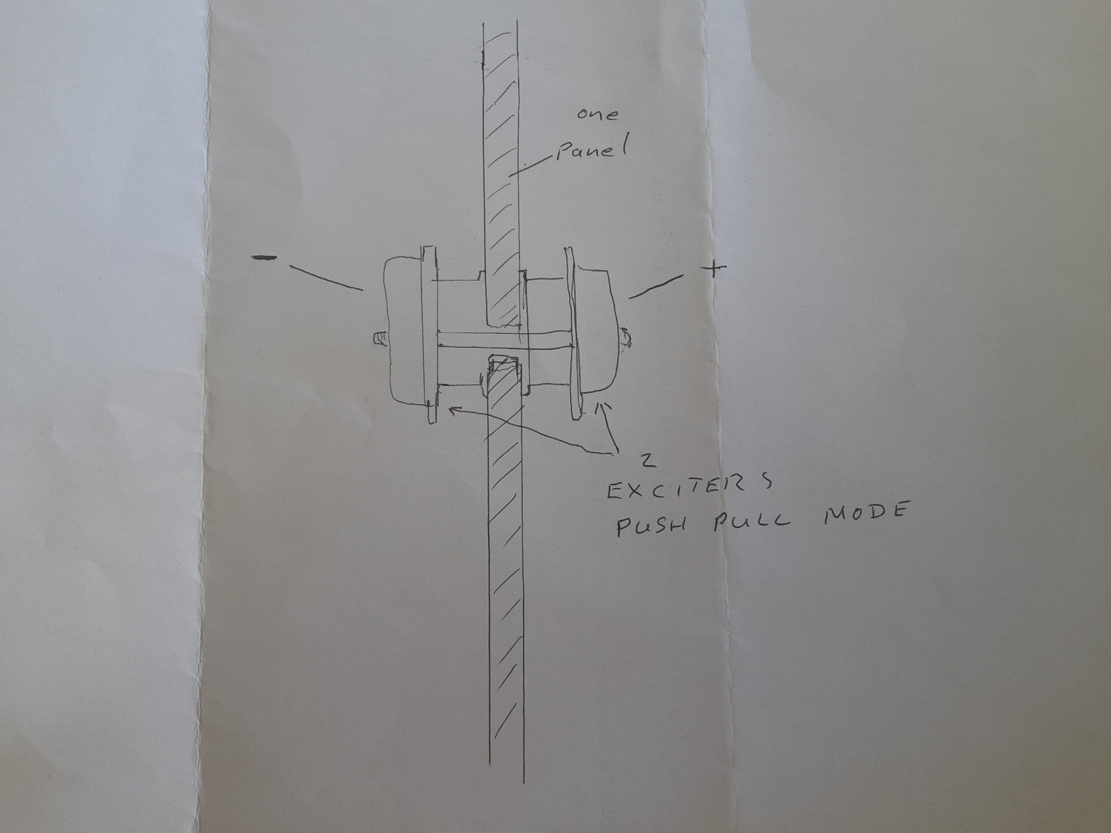

With the reference to Dipole I was referring to a Front and Rear mounted Accelerator, both in direct centre line with each other on the Panel.

I am not to intrude on your Holiday anymore, but yes, Push Pull Mode is the correct description for what I am referring to.

That's OK ,I'm just chilling out by the pool😎
I was thinking of this push pull method for my rigid ply panels to increase the power handling but never got around to it.
