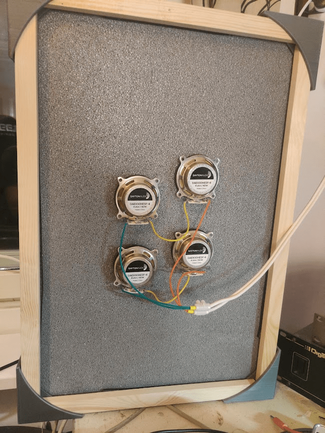

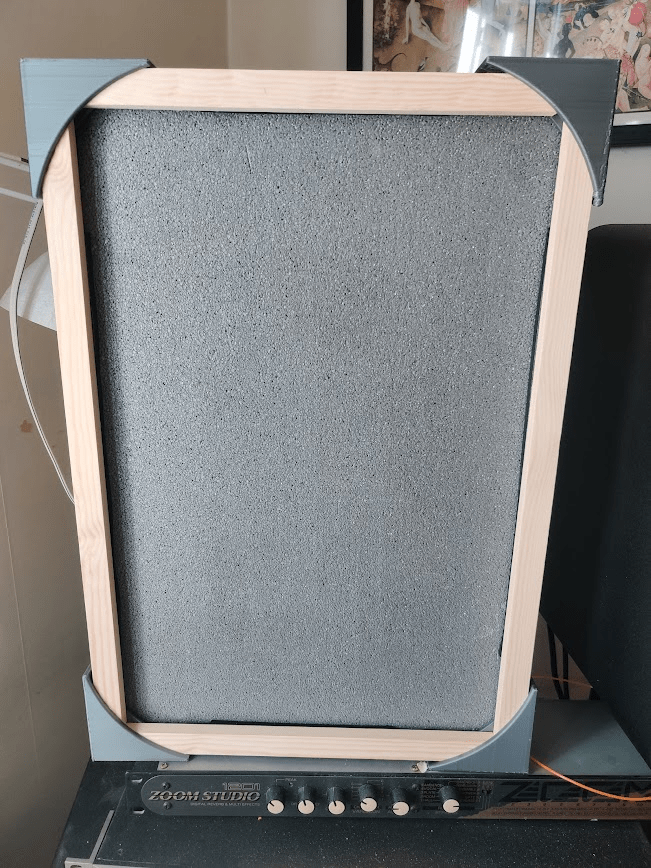

Working out really nicely with the frame with printed corners. Sounds even tighter and with much better bass and mid presence. Haven't screwed or glued anything, but holds together anyway and no rattling at max volume I can produce with the amp I have now.
Will work on the look a bit, probably paint the wood orange or something:
Leon.
How many exciters and what configuration are you using.
Can we see the back mountings.
Steve.
Steve.

I have not completed the mounting yet, and just have the exciters attached with the original adhesive, so this is how it looks on the back:Leon.
Steve.
So 4x DAEX30HESF-4 in a Tectonic style configuration.
No graphs for now since my space is a bit chaotic with various ongoing projects :\
But did some more careful listening and playing around with EQ and the framed plate.
It seems like response below 90hz or so is much lower then the unframed plate, which I hope is not an issue since I plan to high pass them around there anyway. The foam strips I'm using are quite soft, but the plate is pressed quite tightly between them, and think I will need looser suspension if I want them to go lower.
Apart from the sound being much tighter and clearer also at low levels, sensitivity is radically better on this plate. Just tested with a mobile app, which I don't trust the absolute values from, but should should give somewhat useful relative values, and I'm measuring 8-9 dB more!
I did not do the same measurement before suspending the plate, and the plate I'm comparing with is using 4x DAEX25FHE-4 instead, so cannot say what can be attributed to the exciters, plate treatment or suspension, but will do another plate with same exciters and treatment, but free hanging, and see how it compares.
