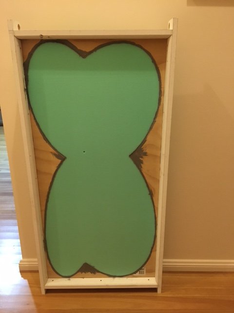

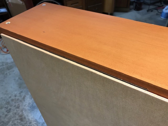

Those look really nice.Sure. The frame is a bit overdesigned, but maybe not as much as you might think. The exciter position that works best is about 5 inches above the center, and 1.5 inches to one side. Two exciters works well with the second one 1.5 inches to the opposite side. With two placed thus, the frequency response is almost identical. But (for reasons I don't understand), the impulse response is slightly cleaner. The opposite is true if the exciters are much farther apart.
Last picture shows the foam tape. In this case it's 3M Extreme double sided mounting tape, cut to about 1/2" wide. It turns out that the FR is pretty sensitive to the choice of foam tape. Even just the tape width. As you can see, this is pretty thin foam, only about 1.5 mm I imagine. I usually don't run the tape all the way to the corners, mainly so I have a chance at separating the panel from the frame for another trial. This is the highest damping foam tape I've used. It works well for this panel, but may not be the best for every panel.

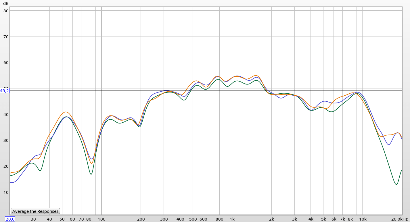

I agree it would be an improvement to add arrows or boxes to help to focus on the area I point... I hoped the text will replace it but seems no. This needs additional time I don't necessary have... but seems the condition for a more useful sharing. It goes also in the way to build a better documentation.
About the positions, my experience currently is from one day to an other one; placing the panel and the mic at "about" the same position, the changes are not very important. I remember we don't have perhaps the same reading; I am not looking for change in the range let say 2dB for now but more 10dB as it happens with suspension.
Each day I start, a first FR is done to check something not link to what I want to test has not changed.
Have a look to the FR below : 3 days (25, 28, 31 march), same panel. Mic at 1m. The panel ant the mic are put away after. I would say not too bad for measurment in a living room (litteraly where we live!). The FR shown in the previous posts are from those days.
To avoid a question... I don't focus so much above 10k.

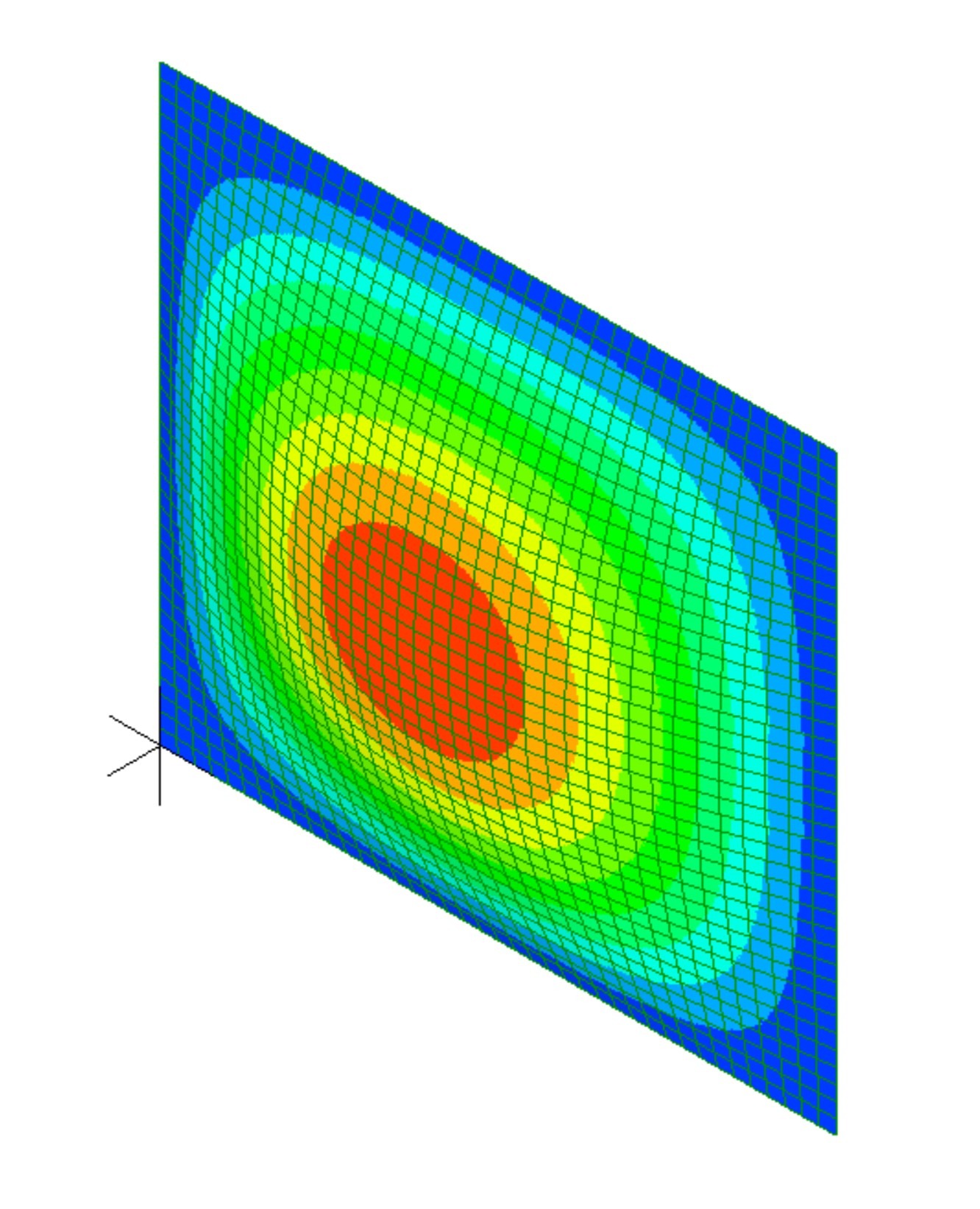

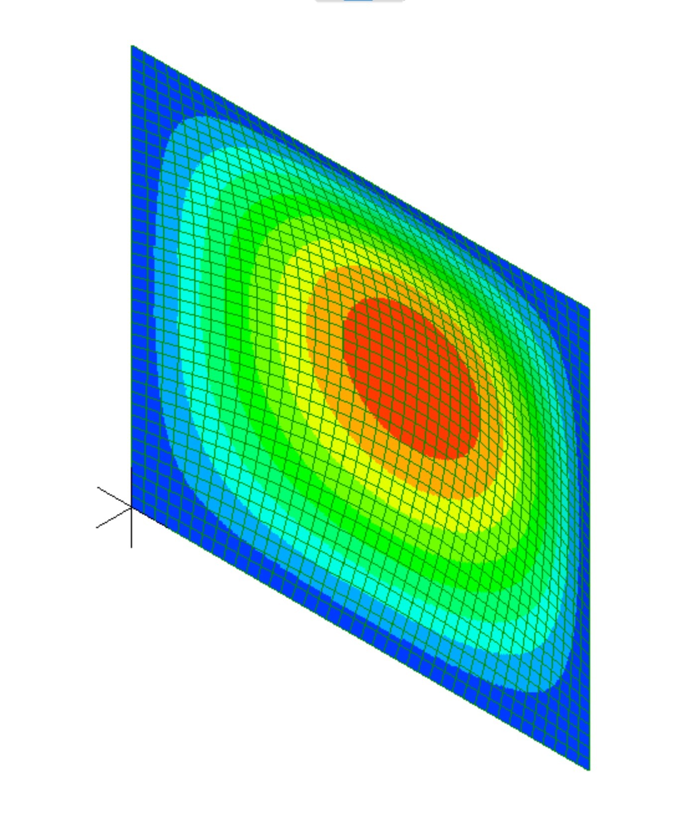

I am curious to know practically how we can determine objectively a panel is in one the 3 modes you list.
Pistonic is a model used in acoustic to allow some calculations based on the hypothesis all the points of the surface move from the same quantity at the same time (like the piston of a gasoline engine).
When some points of the surface are fixed, it is no more possible. The panel works in flexion.
The only clear possible case is the free floating panel but here the 1st mode of flexion is so low in frequency that, if there is, the frequency range for a pistonic mode which occurs before the 1st mode is very low in frequency, if it can produce enough SPL It is exactly for that cones are cones : the shape gives enough rigidity to reject the flexion at the end of the target frequency range. A flat membrane can't do that.
For the art panel as the edges are fixed in position with frame, it is a typical (1,1) mode that occurs first.
My understanding is that sometimes, "pistonic" is used to say all the points of the surface go in the same direction, not necessary the same value, which is not pistonic but the 1st flexion mode. The word "pistonic" is in this case perhaps more efficient in a general communication even if not completely true... which is I think you do speaking of the Tall Blond.
The area within the coil diameter is also submitted to modes. The best proof of that is the change in the FR when adding a mass at the center to stop the resonance which occurs in the 10k area.

Thanks NaRenaud,Those look really nice.
I wasn't really going for looks on this one, I was just looking for one step up from "prototype", to use in my basement workshop. The frame material is leftovers from a work project, and was prefinished, so I did not chose the color. But the contrast between the frame and the light birch panel does look nice, I think.
Sadly, so far there is only one, not two. I planned two but the panel I got for the second speaker turned out to be different from the first panel. It was from the same bin at Home Depot and identically labelled as "birch plywood" but one panel was 5 ply and the other was 3 ply! I didn't even notice until I went to build the second speaker and noticed a difference in weight, and then, upon closer inspection, the difference in the number of plies. I've since gone to four different store locations looking for a panel that matches the first one, but no luck so far! The first one is more efficient than any of the plywood panels I've used before, so I'm really bummed that I can't find a matching panel.

As promised, an image of my first experiment with shapes - in this case, ellipses, which I did last year. The exciter location (the dot at the centre left) is at the focus of all four ellipses. The 'baffle' is 1200x600 7mm ply (not rigid enough!) and the panel is 20mm XPS. At this point, the panel is attached to the frame with silicone sealant.
With an ellipse, any ray leaving the exciter would reflect once from the side of one of the ellipses, then through the other focus, then from the other side, or else (when the side is missing) move through to an adjacent ellipse. The ideas were to maximise randomness and asymmetry, maximise ray travel distance before reflecting back towards the exciter, minimise parallel edges and any edges perpendicular to a ray from the exciter. I also hoped that the four lobes would each resonate at a different low frequency, providing a (potentially designable/tunable) boost at particular frequencies in the bass, where modes are sparse. At the time, Id also read about acoustic black holes, and though that if you could machine an ABH at each focus, it should improve the impulse response and further eliminate reflections. Or just kill the sound completely :\
I used the term 'cusp' a couple of times above as a means to disperse a reflected ray in different directions, and people asked what I meant. The cusps are what I'm calling those pointy bits pointing inwards.
I believe that some of these ideas were supported by the tests and listening. I'll show some measurements tomorrow, not sure they show anything convincingly. Measurements were done inside. The best sound was with the panel supported as lightly as possible with little strips of foam squished into the 5mm gap between the baffle and the panel. Until it fell out, that is 🙂 There was a clear audible bass boost from the baffle.
Main problem was I didn't notice just how close the exciter came to the baffle edge, and being the 40W thruster, resonance from there was sort of inevitable. I will return to this one I think, smooth out those cusps (I think now a smooth curve is better anyway, as waves beyond a few cm would not 'see' the point anyhow), and mount the exciter more toward the centre.
