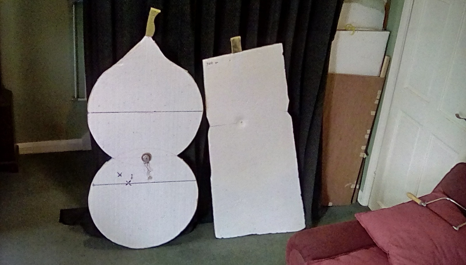

Yep, quite similar. Did you find anything interesting?Pway.
These are two very old panels I still have lying around.
Looks familiar 😁
Steve.

There is a picture on page 266 ?
This shows my two old panels with sponge foam mountings.
This makes it easy to peg them to my lamp stands.
They do not buzz(masking tape will sometimes buzz if precautions are not taken, but is only a temporary mounting).
Steve.
Steve.
What were the reasons you tried this shape ?Yep, quite similar. Did you find anything interesting?
It was a long time ago now, but I think I was trying to stop standing waves bouncing back and fourth across the panel and lessening or at least staggering ,the early reflection back to the exciter ?
There was a patent showing different shapes and their responses,but my wife deleted it from my tablet,and now I cannot find it again.
From this patent ,I placed an angled cross beam across the top of my 6ft clamped ply panel, this prevented the long decay of the low frequency resonance, or the oomph sound that carried on after the music was turned off.
I do not use a cross beam on my EPS panels but odd shapes can help.
What I remember, from the patent ,was that a panel with none parallel sides had a very similar response in the lower frequencies as the more complicated ear shape.
I think the shape you have was ok, but I do remember thinking the sound was a little thin, mainly because where the sides come in too close to the exciter , they reduce the width of the panel, hence the other panel in the photo only having small cut outs at the edges at early reflection points (even though the sides were not parallel already).
Steve
