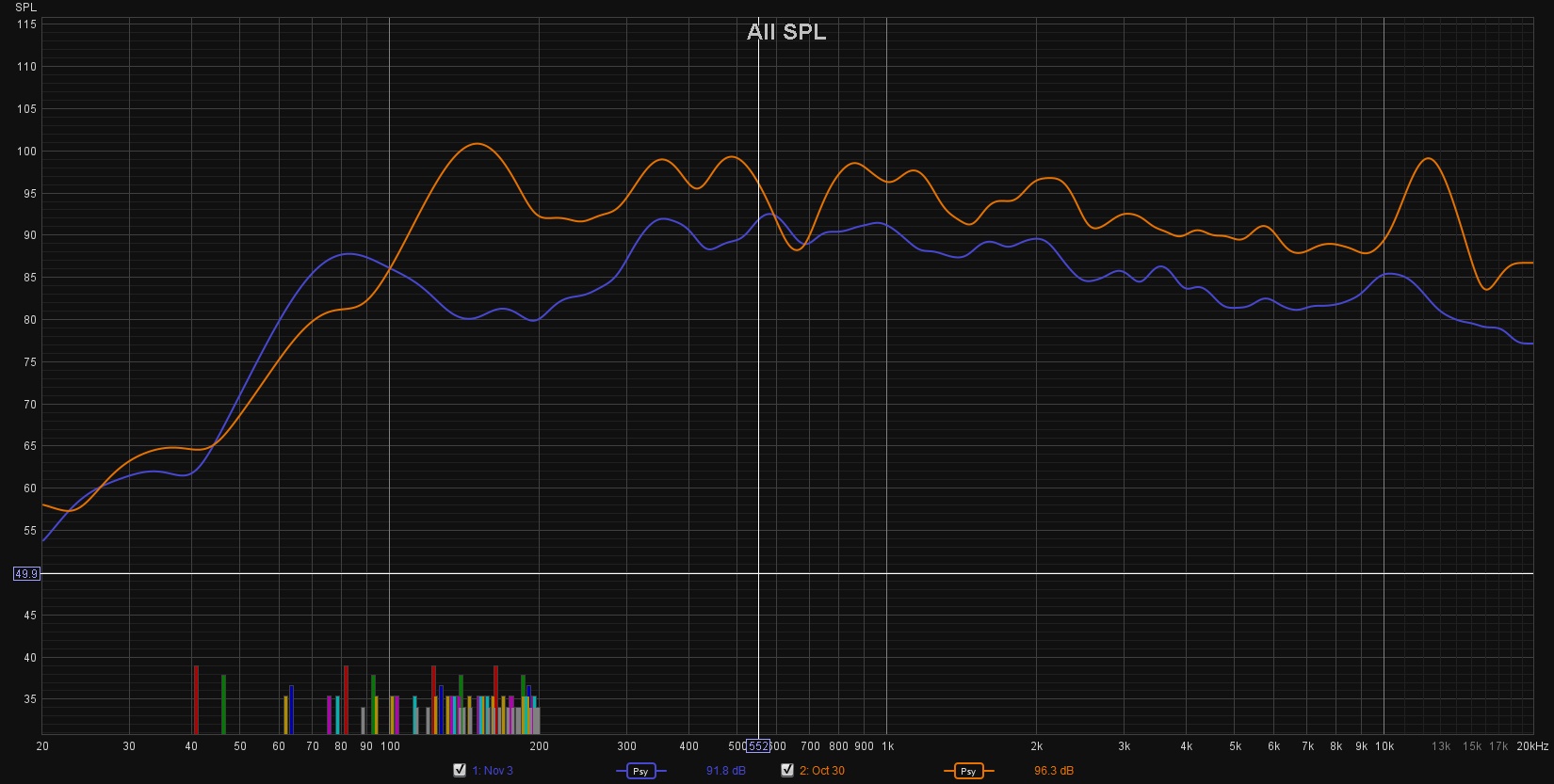

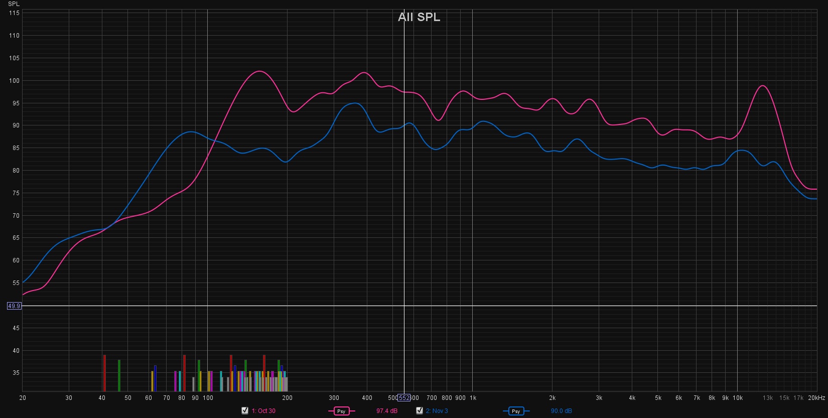

A tale of two panel materials
I just had to do it. I fancied trying 2mm ceiba plywood panels to see how they would compare with the ultra high density EPS.
There was something about the sound of the EPS panels that just sounded a bit 'off'.
So with broadly similar constructions (40x30 panel partially bonded to neoprene foam which in turn is stuck to a canvas frame minus the canvas, here are the plots. I measured the panels from a distance of 1.0m
The first is of the left, the second the right. The plywood is the less efficient one (volume control was identical for each).
Early days on the listening front, but the ply is very promising.
In your plots you can see the uncorrected massive peak above 10k in the eps panel , the ply panel is damping this a little bit but will still be heard especially from the rear, this is to do with the so called oil can problem.
There are also some bumps in the 2k to 3k regions which are probably caused by coil cavity resonance.
These are the two main problems I have found when using coil drivers.
These two distortions need to be sorted out ,for a good sounding dml panel.
Steve.
