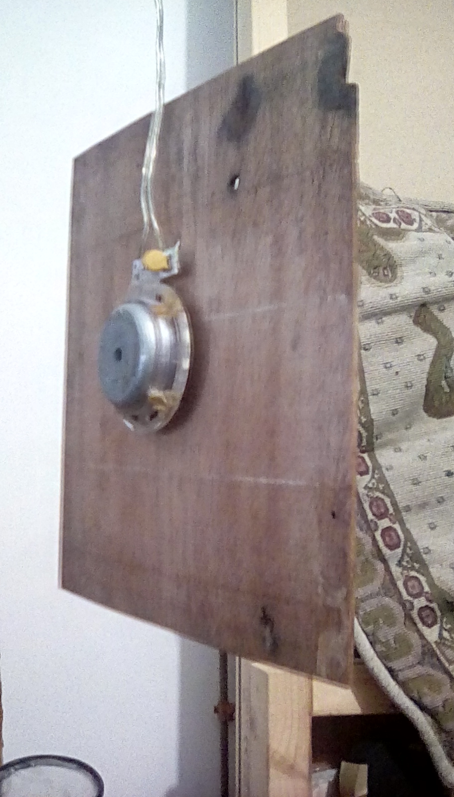

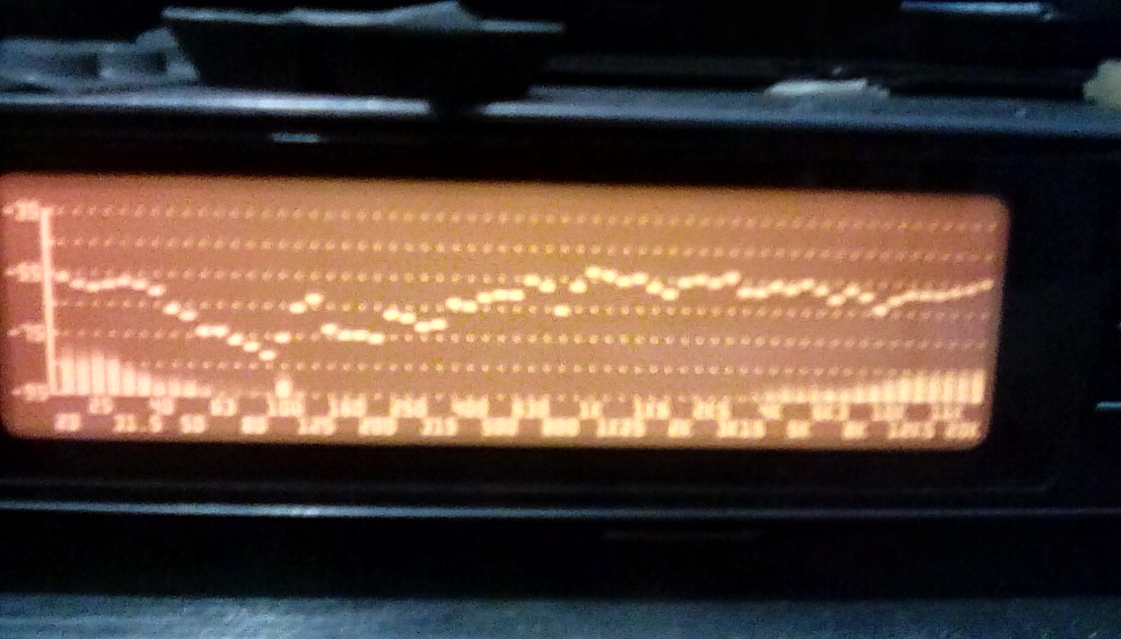

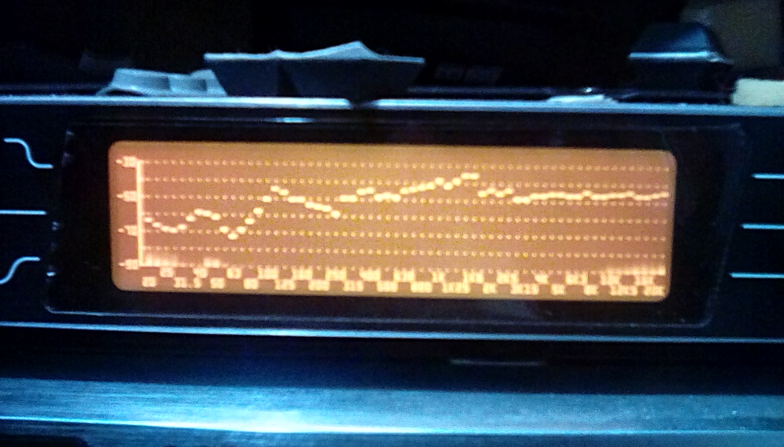

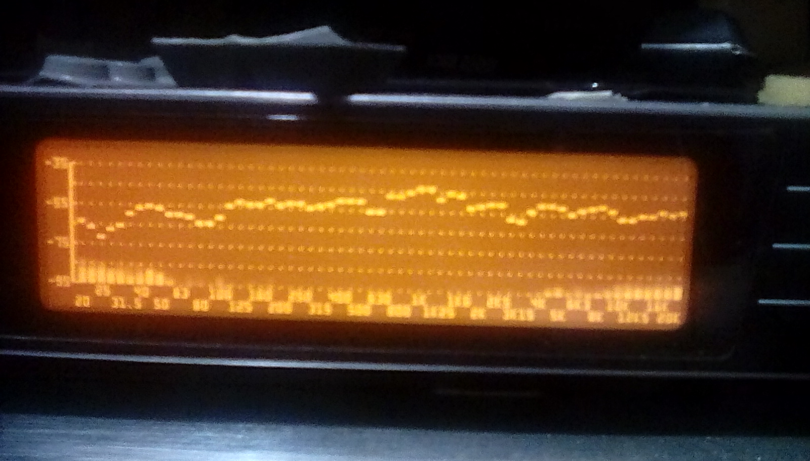

The first picture is of the 7inch 2mm wood panel I found in my shed .
The wood bends one way but not the other because of the wood grain.
Nothing done to it except glued the exciter to the panel with pva.

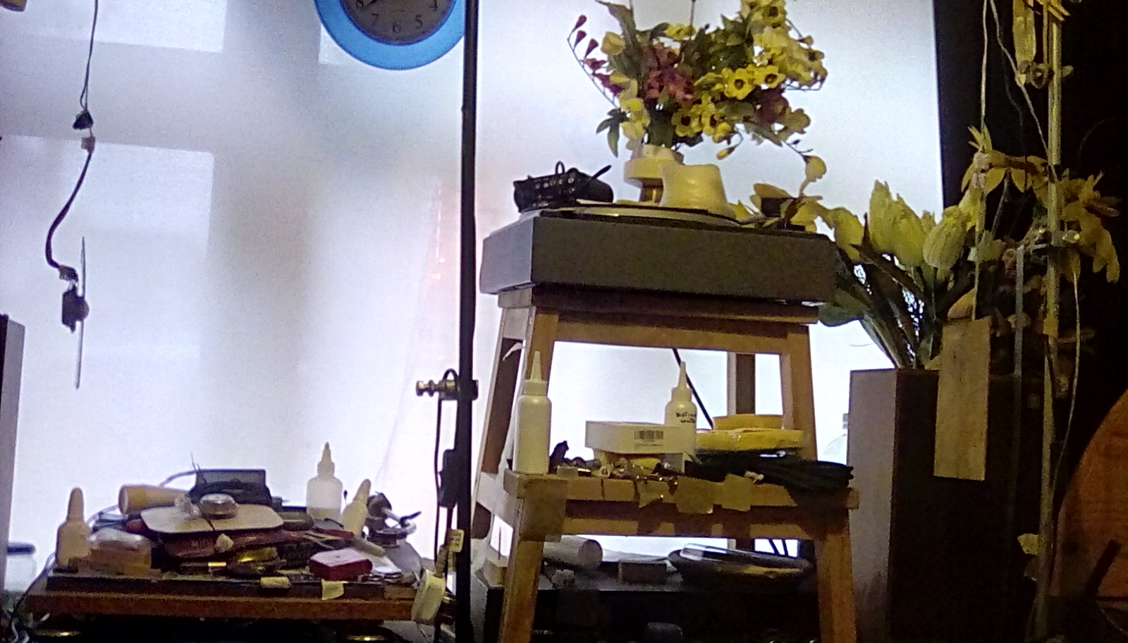

Pic 2 is the microphone at 30cm with pink noise.
Pic 3 is at 1m, as requested by some.
Pic 4 is at 3m.
There are some peaks at about 1.5k ,that is probably something to do with the coil cavity area.
This panel can happily xo at 300hz.
And sounds remarkably good,with plenty of headroom.
Japanese drums handled well at realistic levels in my room.
Steve.

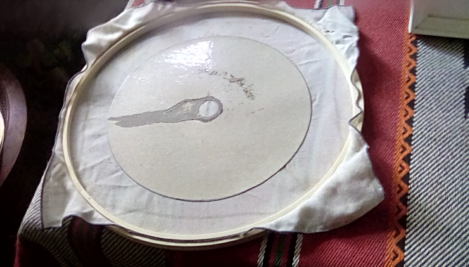

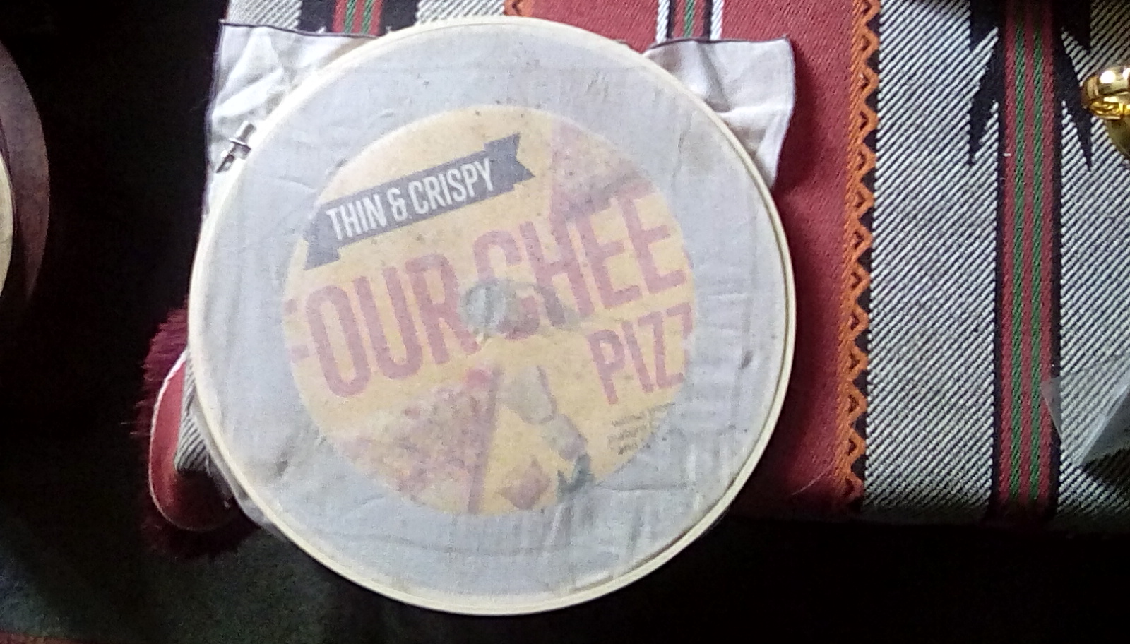

Talking of pizzas .
Yesterday I applied some epoxy to an old card and fabric hoop panel I had not got around to throwing away yet.
I just want to see what it sounds like ,when I get around to attaching an exciter ,that is.
Steve.
Steve.

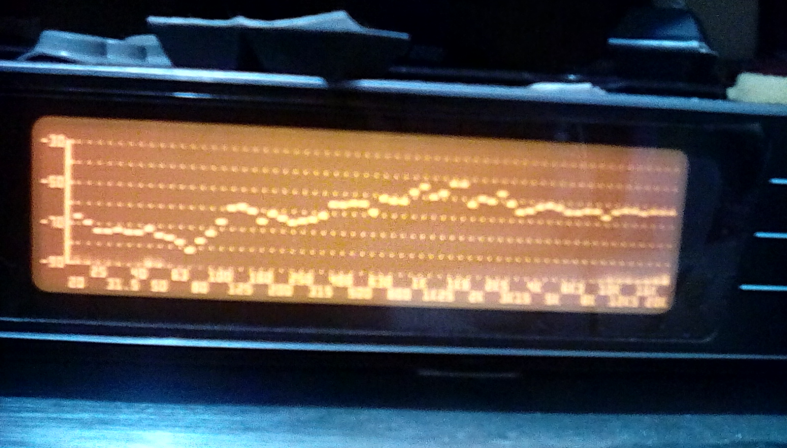

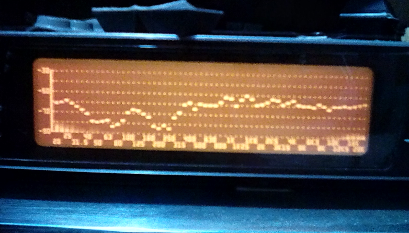

I took a couple of pictures of my two small panels facing each other, and the response 3m into the room.
Sorry again about the picture quality, but as you can see the response from the side plot, that is still very good from 300hz to over 20k.
In case anyone was in any doubt that dml is omnidirectional.
Steve.

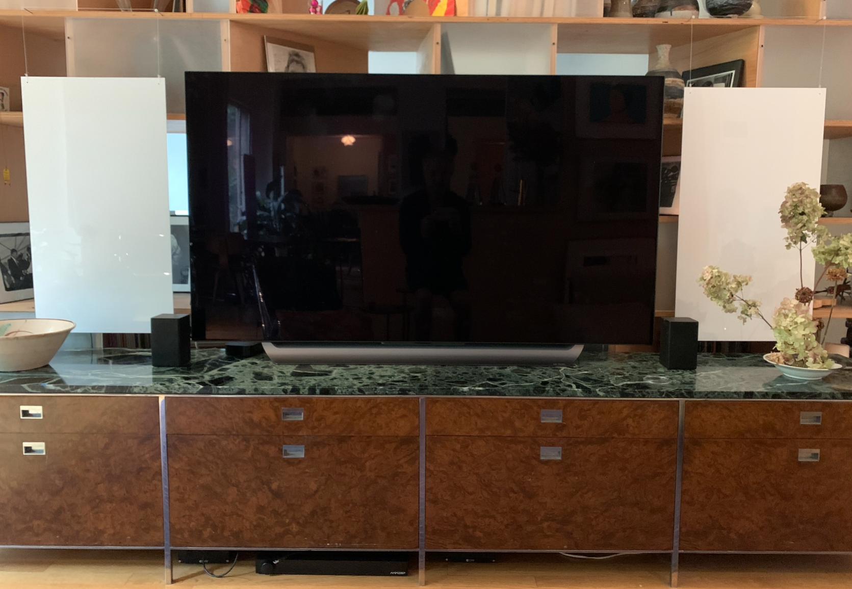

I've gathered materials for a specific DML application experiment.
I've written a bit about this on another thread, but thought this thread could provide some guidance.
I've begun assembling a pair of DMLs to flank a 65" TV (see attached photo).
I currently have one Dayton Audio Thruster mounted (at a 2/5 location) on each of two 1/16" thick pieces of plexiglass I had left over from a home project.
I haven't finished the panels (e.g., sanded the edges or rounded the corners) or done any measurements yet, but they actually sound very promising as left and right stereo channels.
A center channel presents some challenges. I don't have a good place to locate a center channel either above or below the TV monitor.

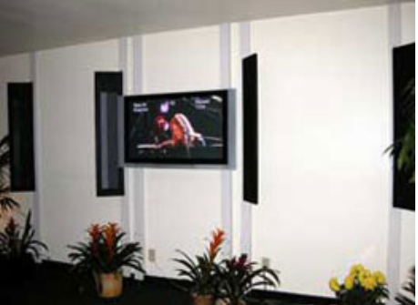

Magnepan dual center channel
Magnepan has developed the idea of a dual-center channel solution, which suggests a solution (see attached photo referred to in the following from Magnepan's website):
In the photo of my TV and DML panels you can see a pair of small conventional speakers I used to test out the concept. To my ears, this seems very promising.
While I can simply make a second pair of DMLs to serve as the "dual center channel", I think that DMLs may give a more interesting solution.
No place for a center channel speaker?
The photo below is of a demonstration in a hotel during a Consumer Electronic Show in Las Vegas. The on-wall models immediately flanking the on-wall video monitor provide a dual center channel array which can outperform a single center channel speaker.
A pair of our on-wall speakers achieves a center channel image in the same manner as a stereo system achieves a center image. By angling the speakers approximately 30 degrees to the wall, the center channel speaker on the left of the video monitor is on-axis with the viewer off to the right--- and consequently is louder than the center channel speaker on the right of the monitor (which is closer to the viewer). This "pulls" the audio image to the left and keeps the dialog centered on the screen better than point source speakers.
And there is a bonus for those willing to install this unorthodox concept. In blind-fold testing, listeners found that center channel dialog and information was easier to understand with a "Maggie" dual center than with a conventional single center channel speaker. Extensive research on speech intelligibility is available on the internet.

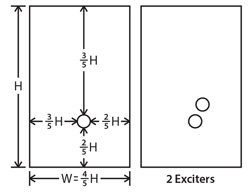

Given the placement of my current exciters (2/5 position), where should I consider mounting the center channel exciters?
Should I follow the Dayton Audio advice on placing a second exciter near the first (see first attached photo) or would some other 2/5 related placement make more sense?

aagas.
To be honest , I don't think having two totally different channels on separate exciters running on the same panel is a good idear.
The exciters will be fighting each other for control of the panel.
You could easily test this using temporary double sided tape and a little exciter support.
Magnepans are well known for beaming and tries to act as a piston.
Although dml is very good at keeping a central image when you move from the left to the right side of the stereo image, you are not crossing between two beams , they are very omnidirectional.
I had to have a bit of a think about this, but I don't think any of my ideas will go down well with your other half
your panels look quite large what frequency are you xo the panels at ?
Your surround panels are basically in the position of the centre channel according to magnepan.
The only thing I could think of that might please you and your architect , is maybe cutting the panel in half and using the lower half as the centre channel and the top half as the surround ?
It might be a way the way round this problem ?
I'm presuming you can't have the surrounds further out to the left and right ?
Steve.

Panels: 32.7" h x 18" w
I'll get the DMLs configured properly, measure them, then think about xo to a subwoofer if I think I need it (and I can hide it somewhere out of sight).
All of this just for TV viewing. I use my much larger aluminum DMLs for my main audio listening.
I've had the same idea. Easy enough to do, but I've thought to do it only if my original idea doesn't work out.
For now, suspending judgment, any thoughts about where to position the second set of exciters?
-- Andreas
-- Andreas
I managed to glue the damaged exciter to the epoxy card hoop panel ��
So I've had to remove it again.
I have now marked it as bad ,so it shouldn't happen again.
But before I did this I took some measurements at 1ft .
The response looks pretty good with a useful output down to about 30hz near field.
Would make a very decent near field monitor or computer speaker.
I had no complaints about the sound of the epoxy so I will be putting on a decent exciter for more testing as the main set of speakers.
Even if I still had my phone recorder I wouldn't have recorded the panel as the buzzing was pretty bad.
Steve
Steve

I'm still waiting for the glue to dry, but hopefully can do some near field tests.
My experience with dml up close is very similar to wearing headphones, this will be more so with the full range canvas and my hoop panel, I hope ?
I did notice that when I was using the hoop full range with my transmission line speakers they were helping under pin the low end at about 30hz , this was when I was sitting in my seat at 3m !!
Computer speakers usually need a sub, these panels go lower than most subs especially near field as you are not trying to drive the room.
You are basically in the full range power zone of the panel , very similar to headphones.
The microphones I use to do my recordings ,would not pic this up as they roll off sharply at 50hz and at about 10k.
Steve.
Steve.
Even normal speakers do need a sub, and I was planning to install a bandpass sub under the desk, using one or two 6.5" Madisound speakers I bought some time ago and didn't use.
So the same should be valid for the DMLs, if necessary.
Canvas boards should be better for that?
What did you apply the glue waiting to dry to?
Carlos
Carlos
