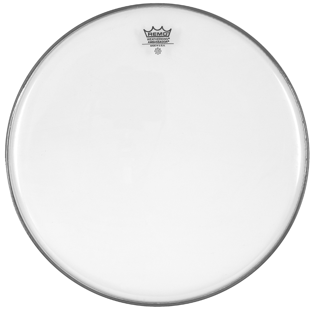

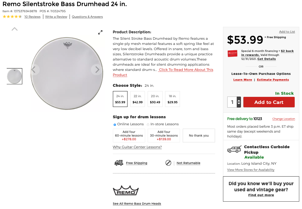

I know I've posted this in some thread on this site, but it seems timely:
Lots of variations available.
Seems simple and straight forward for a DML.
Readily available.
Metal or plastic frame.
Equal tension across surface of the drum head.
I'd think a drum head (usually some kind of plastic) would provide a good surface on which to attach an exciter.
Not certain what the circular shape would do.
Steve -- re:
At the end of the day the canvas panel is a drum , but hopefully a de-tuned drum?
Why "de-tuned"?
-- Andreas

I'm no expert but I notice, many times it is mentioned the best material is both light and rigid. A drum head is light but not rigid. Drum head surface oscillates when struck, waves roll across a drum surface, where as DML's entire flat surface should vibrate in a transverse direction without bending. I would think using the drum head would be a good edge of frame to mount a plywood or EPS sheet on but not as good for the transduceing surface it's self. Any opinions?
