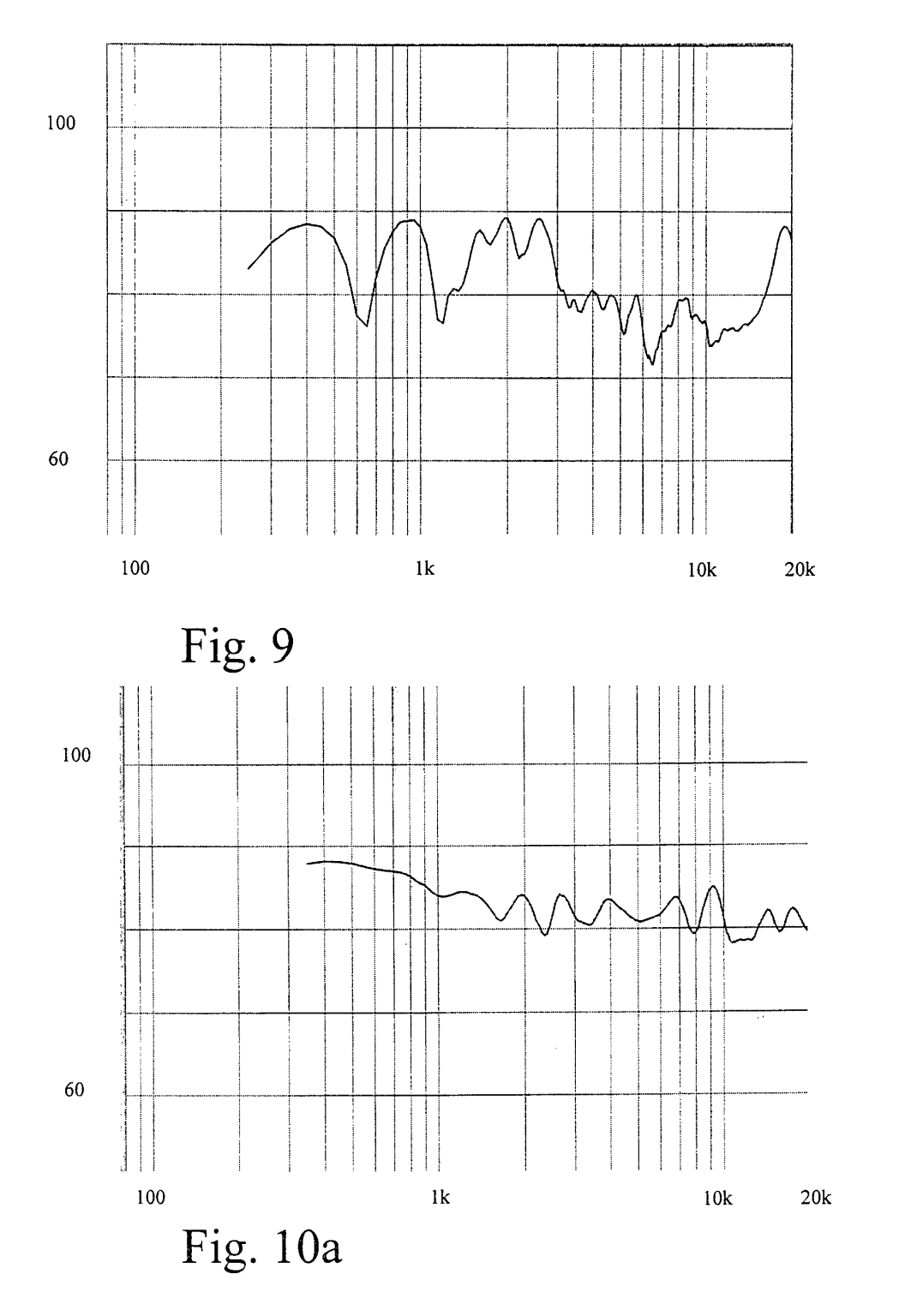

At this page Göbel describe "laser cut incisions are designed to eliminate any reflections on the edges". Looking at the picture (attached) there are 13 incisions on each long edge which are angled with random noise around 45 degrees to the sides. For the preferred length of 25.5 cm this corresponds to about 2cm spacing between incisions. The length of the incision looks to be about 2.8 cm. I get this by the right bottom corner showing a right angled triangle with 2 cm sides (so other side is sqrt(2x4) = 2.8cm.
Göbel has clearly gone to a lot of trouble to eliminate reflections from all sides, along with the back wave. This is a departure from most of the other DML panel designs out there. This would decrease efficiency and flatten response. Claimed efficiency of the Epoque Aeon Reference is 86 dB (1W/1m).
I have also attached frequency response. I think this is before and after edge treatments. He crosses over to bass drivers at 170 Hz.

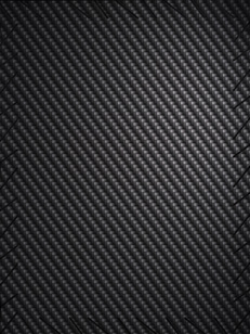

This is 0.5mm carbon fiber plate. It is expensive.
You can buy it here or a number of other places.
Double-Sided Carbon Fibre Sheet; 0.25mm, 0.5mm, 1mm, 2mm, 3mm - Easy Composites
It will not work well by itself.
It needs to be laminated to something. Göbel chose balsa, "pore filler", then epoxy resin, then the CF. He says other textiles also work.

hi.
im not sure if fig 9 is the same panel or a Elac patent using Rohacell ?
the translation by google is a little hard to understand.
looking at the patent ,i dont think you could damp the panel anymore if you tried,it looks quite similar to a bmr in that respect ?
DML , in his patent is heavily restricted , practically none existant ?
it would be interesting to hear these panels,but with all that damping im a little sceptical as to if i would like the sound ?
we have two totally different ideas on how to make a good sounding panel , i like to do as little as possible to the panel and he uses every damping method possible.
even the problems in the centre of the coils are heavily damped by a puck and heavy damping from behind by sound damping materials and fibre board with holes drilled into it, this is very similar to old open backed speakers from the 1940s ?
im sure they sounds fine but at an eye watering cost 🙄
i did listen to a youtube recording of these some time ago which sounded pretty good ,but it is not the same as being there.
steve.

hi.
steve.
I agree the translation looks like he was referring to the Elac patent but when you look at the figures they are virtually identical except all the peaks and troughs have been smoothed out.
I figure the only way that would have happened is if he had the same speaker he made using Elac techniques then applied all the damping that he did on the sides then took the measurements again.
I will have to look up the Elac patent.
I do not know which technique is better. I have not tried either. I am sure I will be one of the nutters I referred to and try both. I have ordered all the bits and pieces except balsa which is easy.
