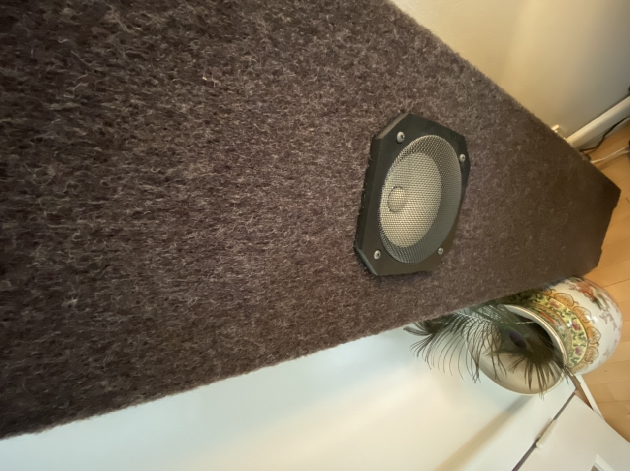

The main problem is picture quality ,I can't upload pictures from my phone, as the quality is too high for this site.
Same problem with my iPhone. Try this trick - it’s the only way I can post pix from my phone. Take a screenshot of your photo. It’s about the right resolution for uploading to DIYA. Works like a charm and lets you crop all in one.
It’s pretty lame when one has to take a screenshot to alter the resolution. Otherwise email to yourself and you can select the resolution. But faster to screenshot it.
This is all great stuff you and the others are leading in this thread. I am really far behind. Good to know about noise from transducers squeezing air through holes etc. anything near a tweeter will cause dips. Unless it’s a well designed wave guide.

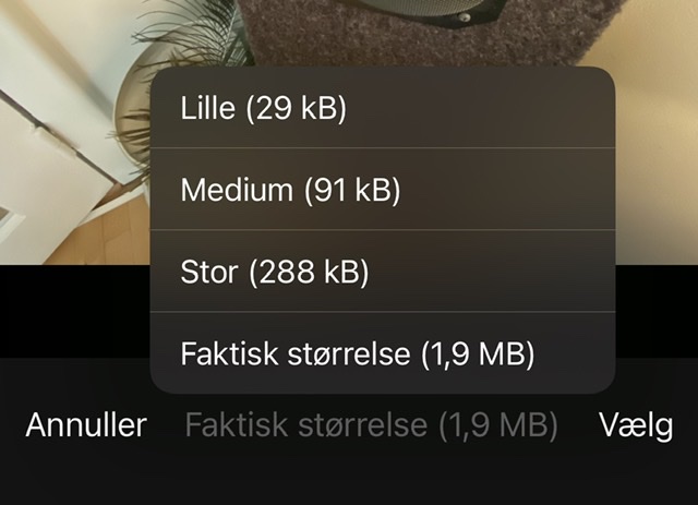

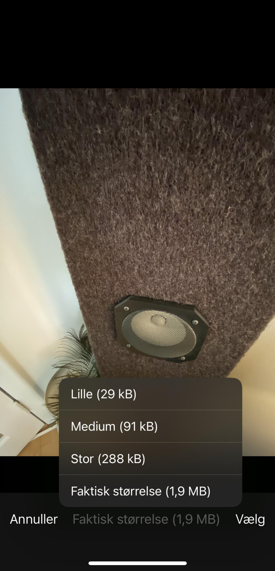

Just tested it.
Works fine for me.
You can choose the size at the bottom of the photo selection screen (“actual size, large, medium or small” I believe they are called in English).

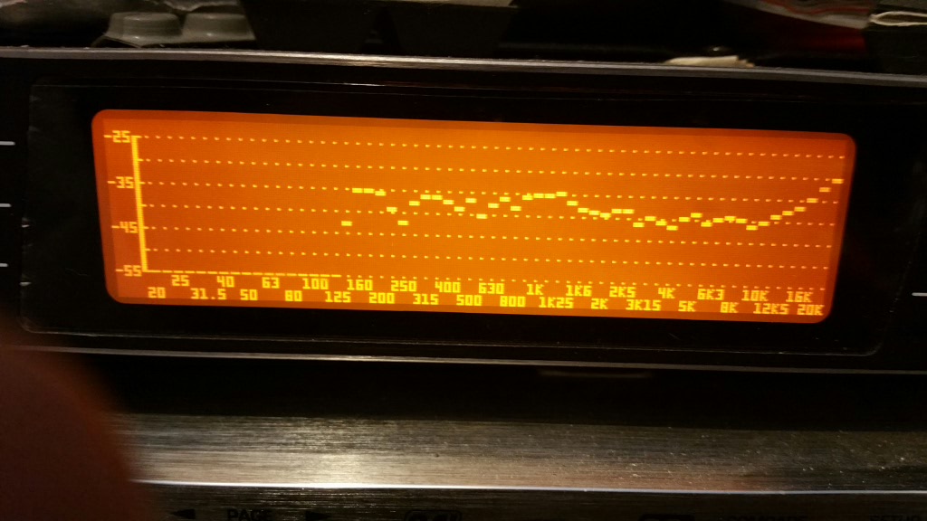

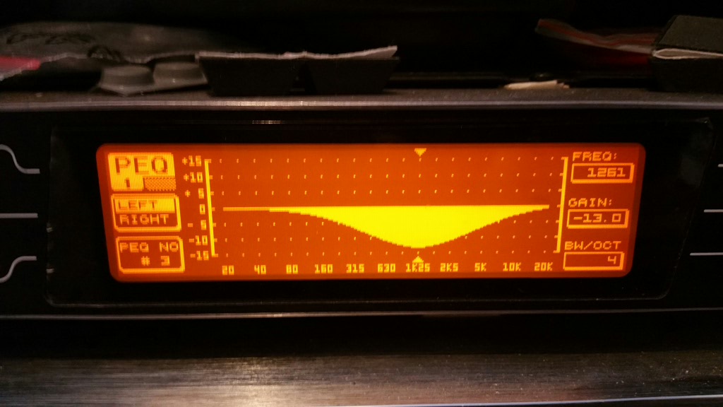

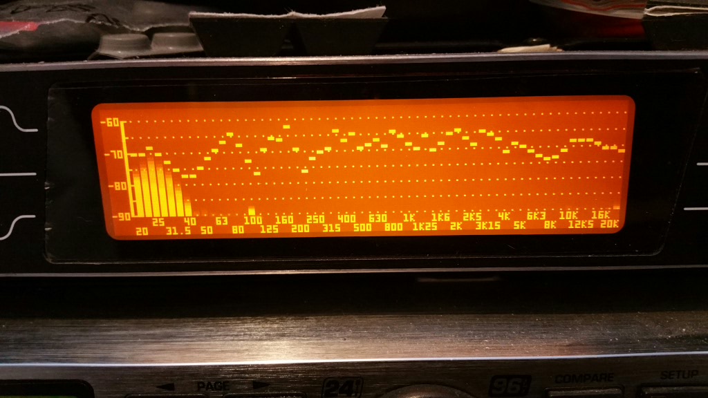

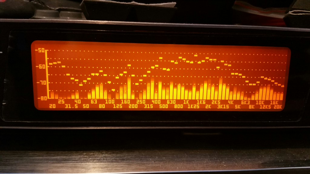

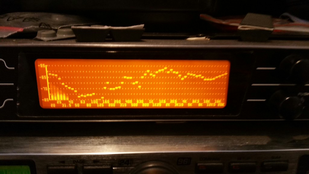

Just to show off my new sharp pictures :D
I was just playing around with different ideas on an old 14x24inch 1/2inch low density EPS.
Basically I'd cut out a hole in the centre and was using different materials to see what happened?
As you can see in the first picture I managed to create a midrange hump, and reduced the hf response, but not only reduced the hf response but extended it up to about 20k.
Should have taken a picture before doing to the damage to the panel :rolleyes:
In the second picture I added this EQ to reduce the midrange hump in the first picture shown as the lower portion of that graph.
The third picture shows the in room response about 11ft into the room.
Actually they are all at 11ft into the room.
From about 250hz up, apart from a dip at about 7 k ,the response is pretty much within + and- 2.5 db.
On my daq that is ,of cause,but it is still pretty good I think?
Below about 250hz the room starts mucking up the response, that's why I use low frequency drivers to help cover this area.
This took about five minutes to set up,and a hell of a lot longer to post:D
I could easily do it this way ,but prefer to design it right in the first place .
That's just me:rolleyes:
Steve.

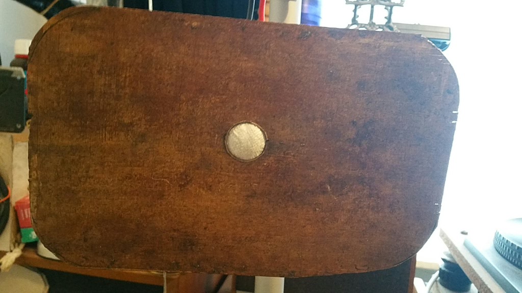

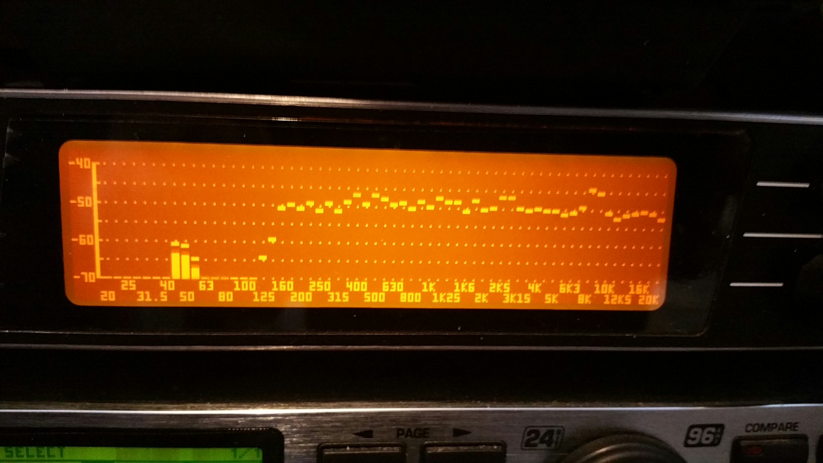

I have three panels drying at the moment.
This one is wood ply that peeled off from a 1940s draw in my shed.
I coated the ply in 50x50 pva.
It is 1mm thick and 9x6inches ,I've just glued the exciter with dome in position ,and cut the corners to reduce vibrations.
The first picture is about 4inches in front of the exciter.
The second is 3mtrs into the room,both are rolled off at 170hz to keep LF well away.
This is how easy it is to make a pretty good sounding panel speaker,wit very little effort of course I could improve on this with a little more effort, it's still drying so the response will change a little in a few days.
I could not use the panel without the dome as there was already a hole where the draw handle was :D
So sorry, no comparison.
But it's all about the sound.
Although it's pretty good fun too.
I will when I get time do a recording ,hopefully with a higher quality conversion rate ,for you to make up your own mind whether it' sounds good ,or not?
