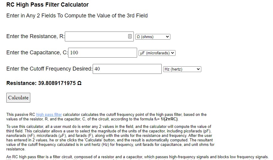

Spedge,
In the calculator, you put in 2 knowns, and it gives you the third, so I put in 40 Hz and 100 uf, and below, it gave me 39.8089 ohms in the dark print. I took 32 ohm resistors, which is what I had on hand, and put them across the DMLs and the 100uf capacitors in line, which gave me a high-pass for 50Hz. I tried it with Neil Diamond's 'Stones", which has a very strong bass thump at the beginning. That had totally bottomed out the panels before, and with the filter, they very slightly bottomed in a way that I could very easily live with, so I'm a happy camper. Thanks for worrying about it for me. Now I just need to find a way to hang/mount them that doesn't just look totally ugly.
Jaxboy.
Did you try using without the resistor?
Without knowing the voice coil resistance at your chosen frequency it's all a bit hit and miss.
I presume that the resistor will lower the output of your exciter,which could be good if it was a bass driver.
Sorry I've got to go!!!
Steve.
