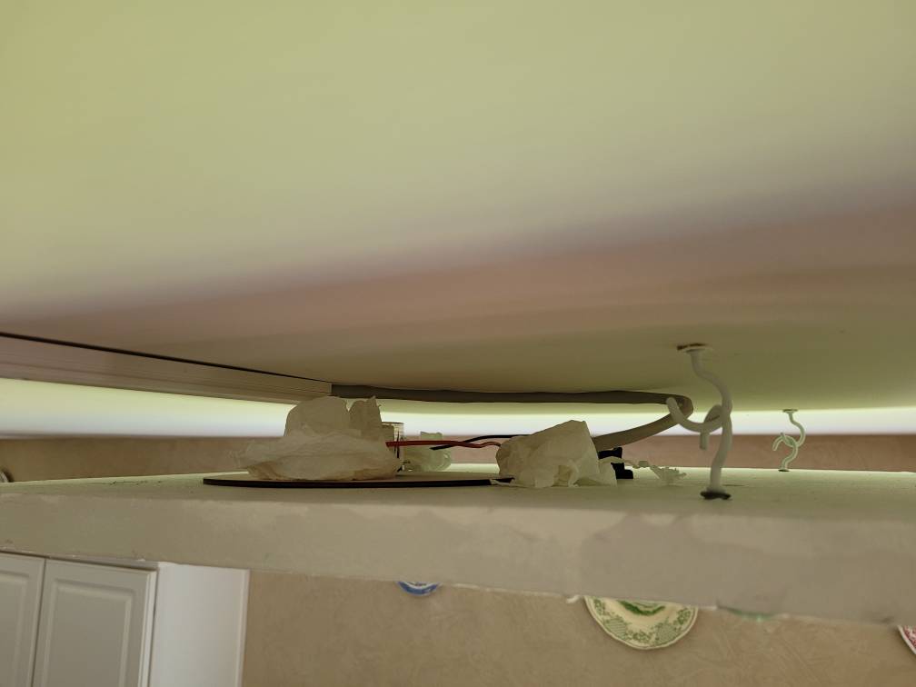

I have some DAEX25SHF*4s mounted on top of XPS panels facing down (hung from the ceiling). I'm getting some breakup around the ~100-400Hz range at pretty moderate volumes. Obvious thing to do would be to take them down and see if I get that breakup in a horizontal position but that's going to be a little bit of a hassle. I figured I'd ask and also ask on suggestions to deal with it.
I have some other exciters I can possibly add on to utilize in a 2 way setup but I'm not sure if those will be any better to cover the low end. So some recommendations on that end would be helpful too. I need them to be 4 ohm. Thinking about the DAEX32EP-4s as my "midbass" exciters (though it looks like they are out of stock until August)

A picture of The panel mountings and exciter in situ would be helpful.
How are the panel and wires supported from the ceiling ?
are you using full range with no roll off?
Does holding and supporting the panel change the distortion in any way ?.

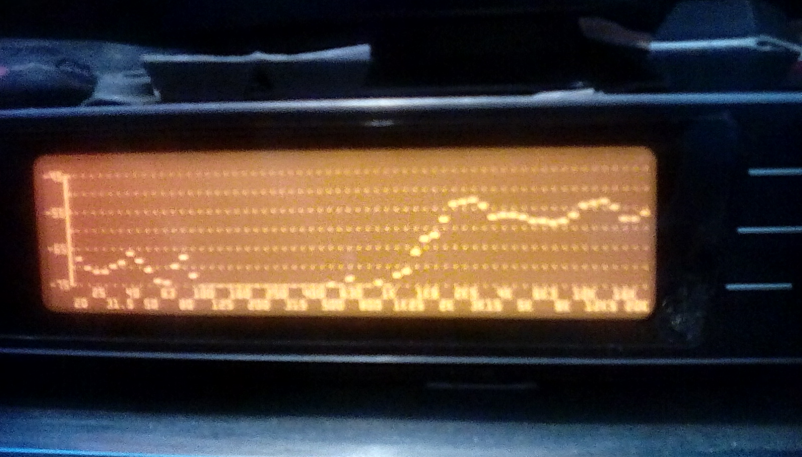

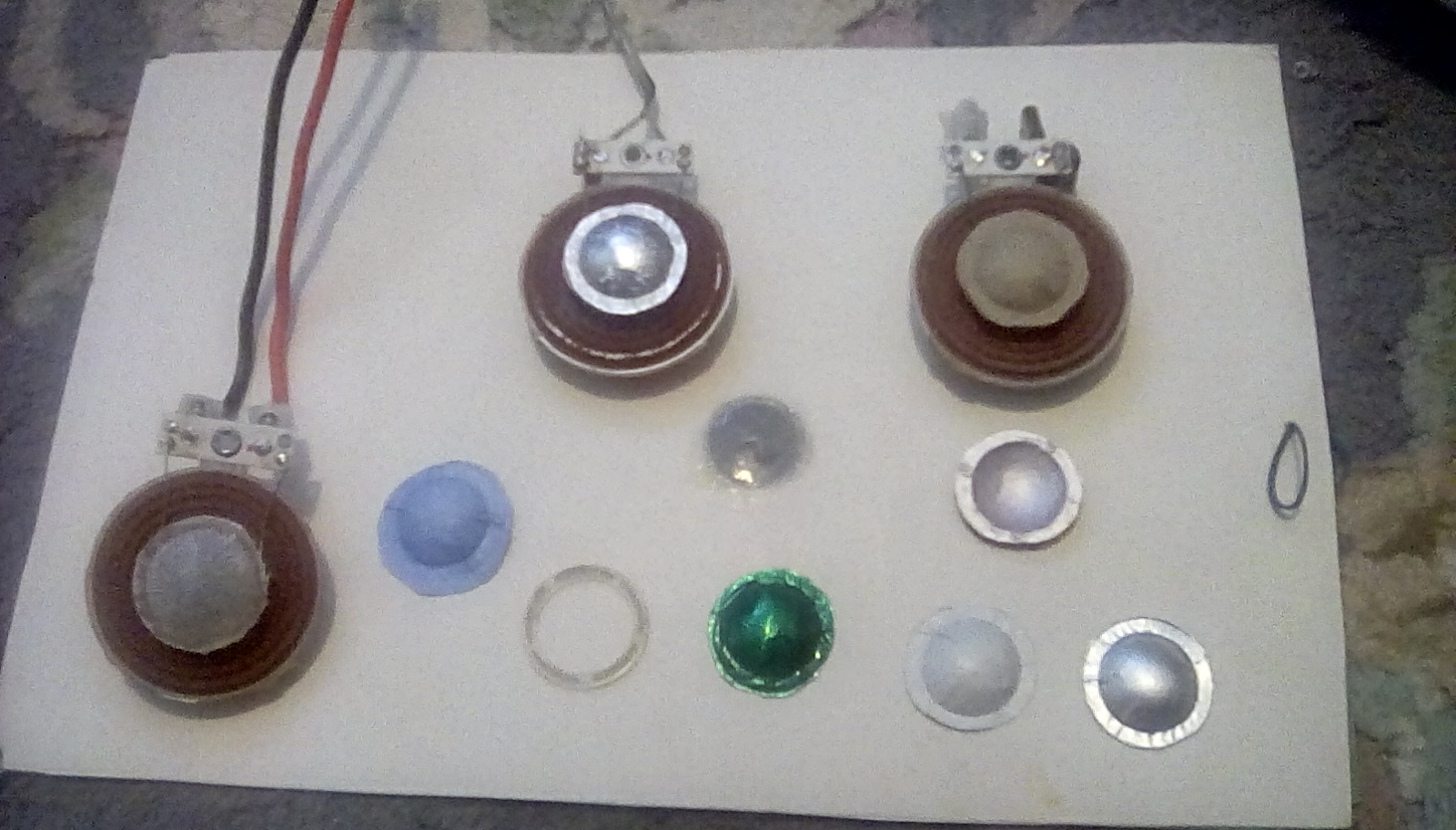

Tweeter measurements.
I was getting a bit bored with all the hot weather we have been having.
So decided to make a few tweeter tests using exciters.
Pic 1.
Is a selection of different materials and three exciter already installed.
Pic 2.
Is toilet paper soaked in pva while using peak hold and pink noise showing good response down to 1.5k,within approx +- 2.5db up to at least 20k.
Pic 3.

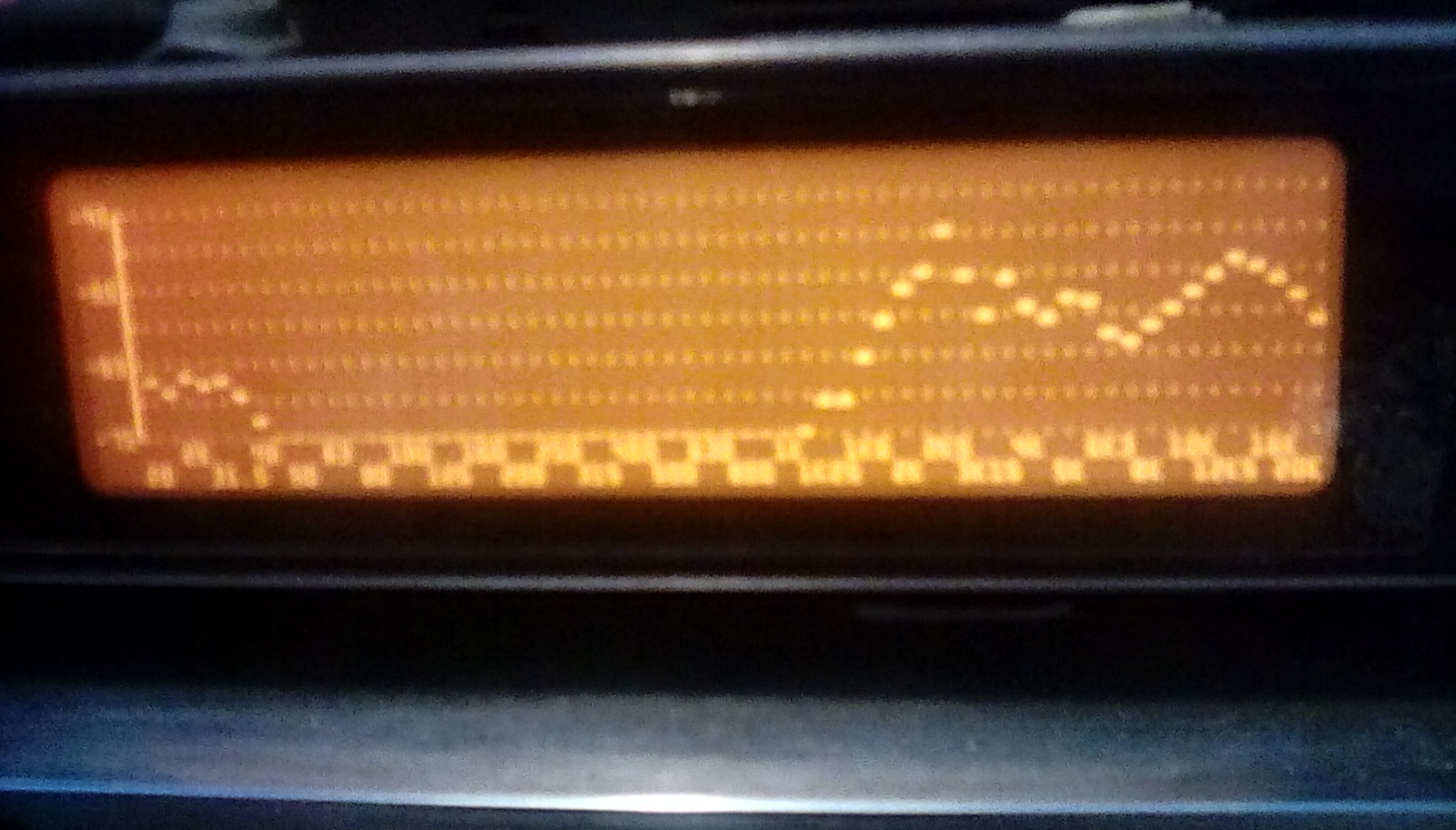

Is with the full panel from the side on the right to see if the levels matched.

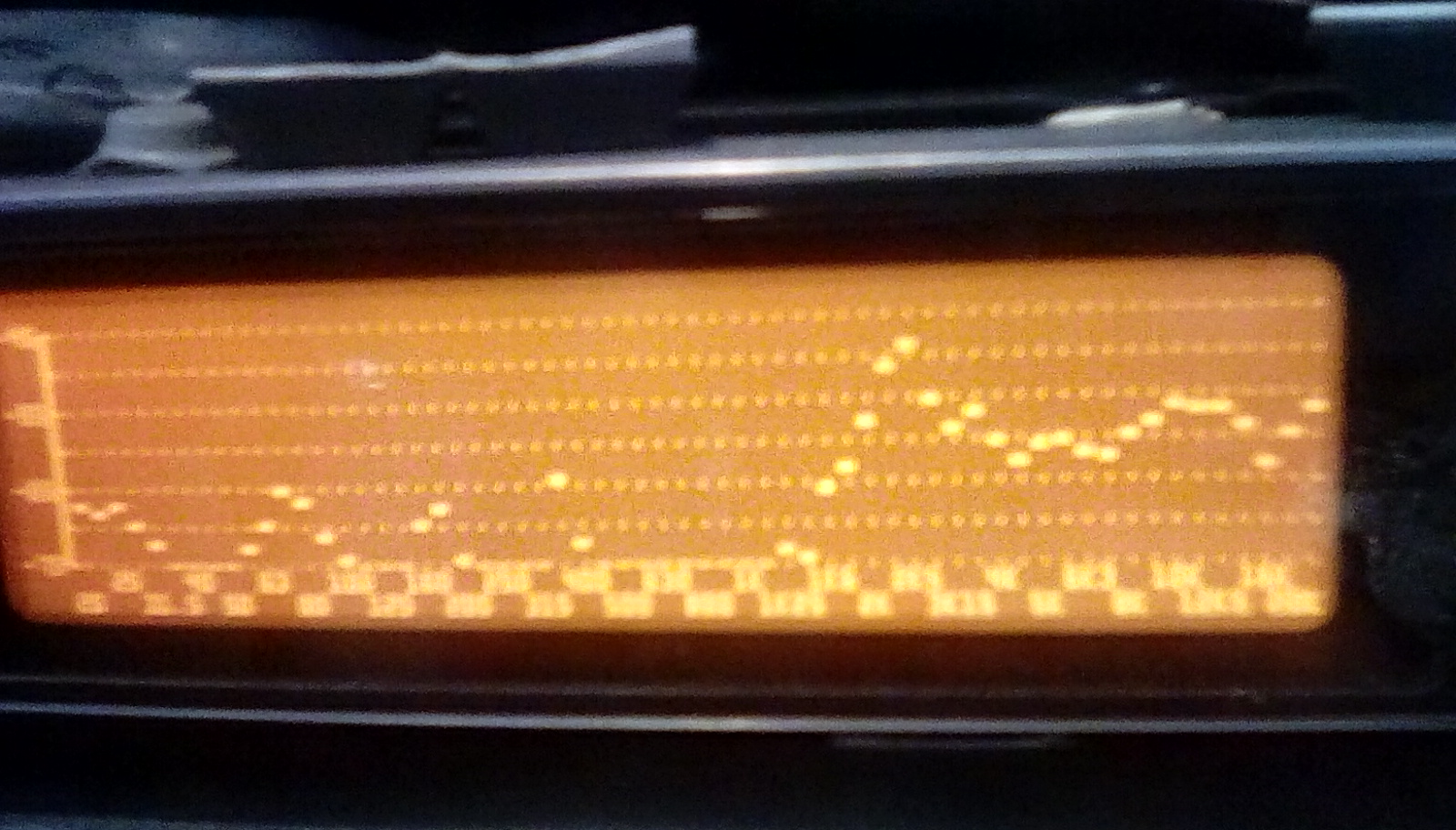

Pic 4.
Is a thin aluminium foil,peak at 2.5k and rolls off sharply, this peak is the spider I believe.

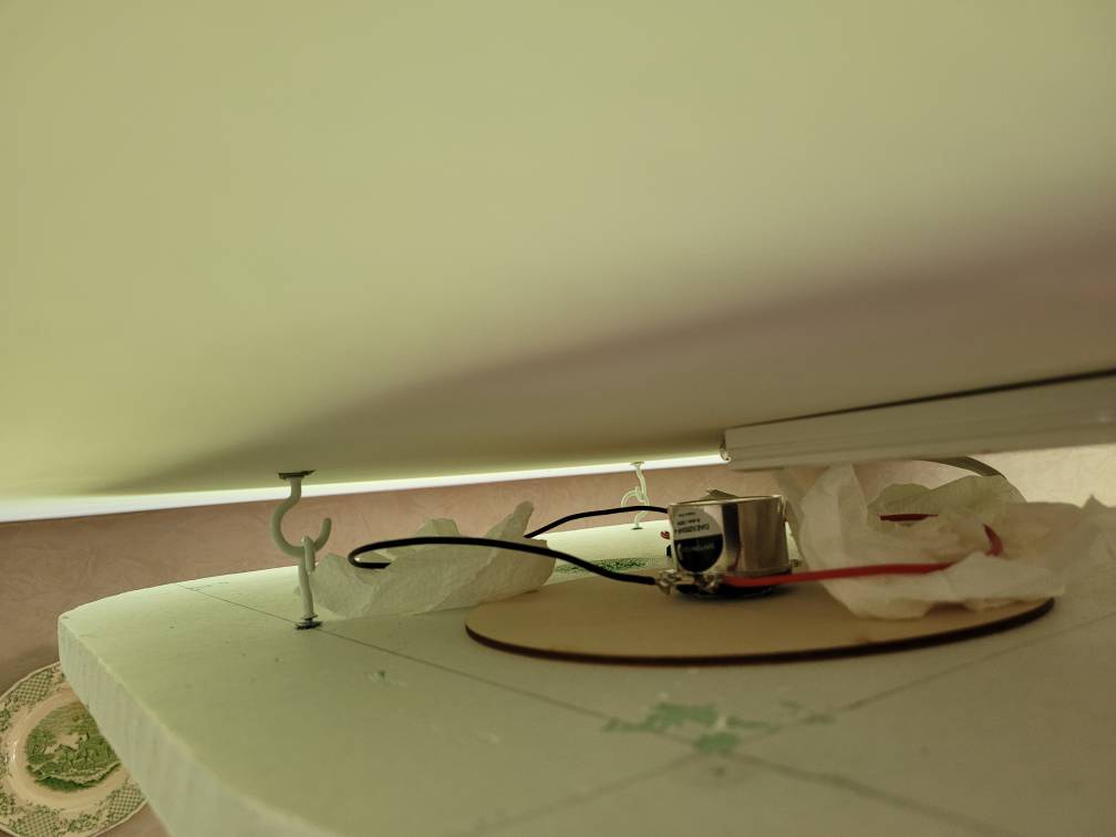

Pic 5.
Is brown wrapping paper.
Damping is only on the toilet paper so far,there is a general hump in the response above about 10k maybe this will sort this problem on the others?
It's good to see that the tweeter is still helping with the sound all the way down to at least 2k if needed.
This will work very well with thinner types of panels which have problems with hf.
It can also work with xps, if not too thick,or thinned a little with a cone shape ?
Care needs to be taken for good results.
This also helps sorts out problems within the coil area.
Steve.

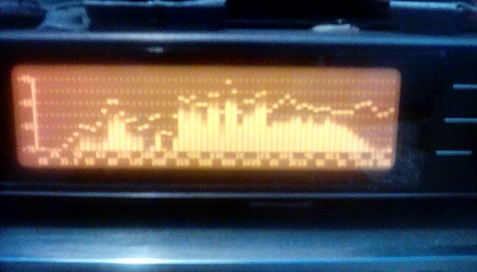

Hi Spedge,
Great work on making your own dome tweeters. So are you suggesting we make a round hole where the exciter is installed and put a dome tweeter to let the HF come through?
I know it’s convenient to use the spectrum analyzer display on your DSP amp but really hard to see. Have you ever tried REW software? It’s really easy and makes much nice clearer and more usable graphs. Check it out sometime. You have a microphone already. Any sound card can work.
Xrk971.
Having the inner coil area as a dome helps sort out a few problems.
1, less noise from within the coil area,as long as you take care to reduce the noise from the dome of course .
2, a clearer less distorted sound, and extended hf .
3, improve the primary wave to better blend with the dml.
Shelley Katz of podium thinks that using piston drivers with dml improves the sound,This I believe Does both using one exciter?
The problem with the way these exciters are designed, is the spider noise and the cavity between the magnet and the dml which also produces quite bad noise.
The first dome I made was concave,similar to a focal tweeter,it looked great,the cavity Noise from this was unbearable,from the back air hole and the front!
Noise is also produced in the central area by the inwards firing hf on a flat dml panel, crashing in the centre and bouncing around everywhere,causing peaks and suck outs .
Once the hf has gone through a thick ,hard or soft material it doesn't sound quite right to me.
I still wonder if a powerful peizo driver on the front of a light panel material might be a better option?
My microphone is an xlr ,so I would need to do a lot of fiddling about with computers ,soundcards ,and this wouldn't really help me at all and could start to get expensive ,let alone The time needed to learn how to use it.
It took me long enough to figger out how to digitize my LPs.
The main problem is picture quality ,I can't upload pictures from my phone, as the quality is too high for this site.
So I use my kindle camera for my deq photos as a rough guide only on this site.
Sorry.
Steve.
