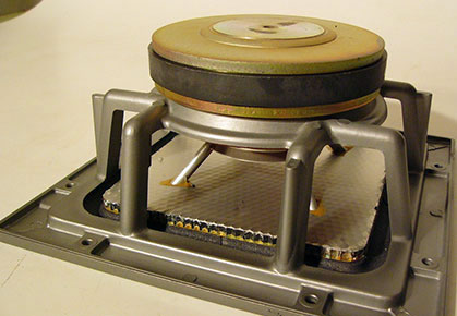

The earlier Sony APM-12ES bass driver appears to have a smaller cone between the flat panel and the coil. The fourth image.
The early APM-6 mid/low woofer had 4 coils to drive the flat panel.
Hope these photos give some ideas to DIYers.

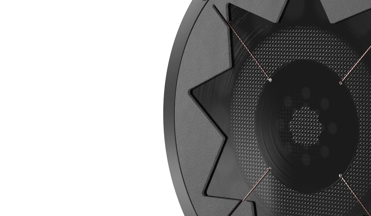

Manger Driver? Haven't read this article for quite a while, but it mentions, "Instead, Josef W. Manger relied on the principle of bending waves, which starting from the centre of a plate-like diaphragm, travel to the outside, like waves after a stone is thrown into the water" rather than pistonic motion of the diaphragm.
I have heard the driver, mounted in a box some years ago, and it was very fast and detailed from memory.
Manger(R) Sound Transducer — Manger Audio

It looks like Manger was saying the same thing as I was trying to say -- different materials in different sections in circles. You have to damp the further end to get the lows.

The 8 pointed inverted star on the Manger composite panel driver is just eye-candy. 🙂 It could be 96 pointed inverted star and so on. By making those points infinite, it becomes a circle.

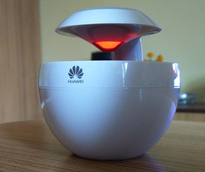

Balanced Mode Radiator (BMR) or Distributed Mode Loudspeaker (DML) are just words, where people coin them to try to explain something. All what we hear is distributed and balanced by our ears. They, the ears, either like to hear those sounds, or demand you to get away from them. Everything we hear, see, touch, smell etc is subjective feeling. One likes the sound of one type of a speaker, while others don't. The measuring instruments don't care two hoots.
Attached is a bluetooth speaker, I bought online as a present to a kid. I bought it just because of the upward firing driver and most importantly cone distributor. I had never heard of it before. I put the small speaker on the shelf and ran some music (Solar Radio) and asked my wife if the music is good. She couldn't pinpoint the source of the sound. Her hearing is very good. It simply filled the room, for such a small thing! (She found it later, of course.)
Manger surely was a DIYer. The idea of triple thicknesses, or 3 different materials, all placed radially had come to him in the 60s, last century. I am not taking into consideration his 8 point inverted star, that's just eye-candy, looking for a high price tag. I remember my pals and I, as students experimenting with vibrations of all kinds of materials in the 70s and 80s. Life took a different turn later, those "playing" had to be stopped.
Daniela Manger trying to explain the matter.
