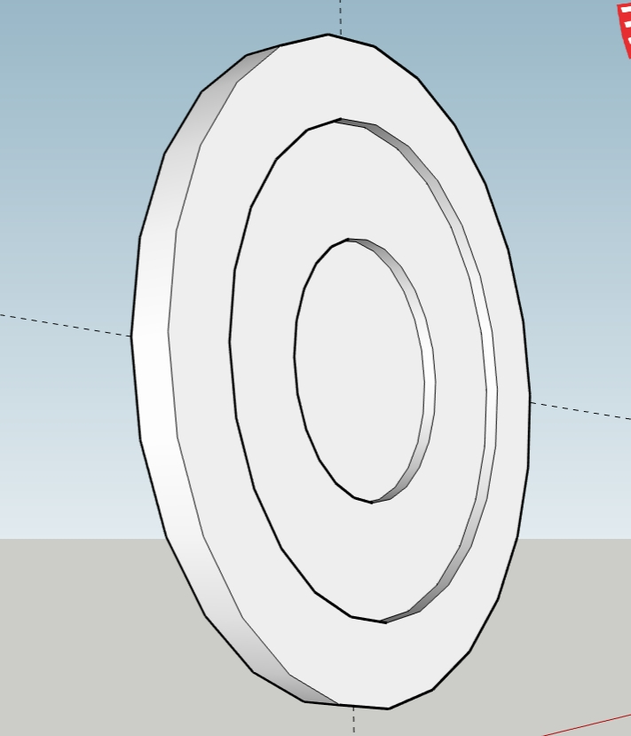

A 3 thickness composite disk. If it has to be boxed/framed, the outer round edge should be surrounded softly, elastically, more or less like a standard cone. If any waves that hit the edges and turn back, they won't go far. The different thicknesses would vibrate differently. Think of this as glasses filled in different levels, so they'd give different sound, when knocked on.
The cross section of disk could also be tapered like a cheese wedge, with the central circle flat. The cheese wedge look is even better. Can't draw it in Sketchup.

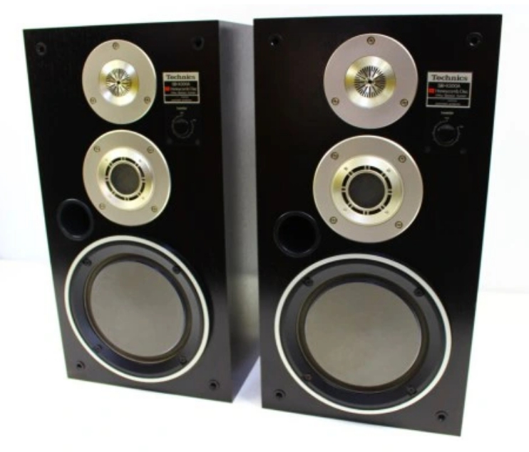

A different density same material disk panel speaker of the 70s.

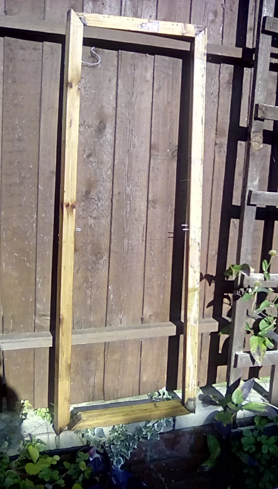

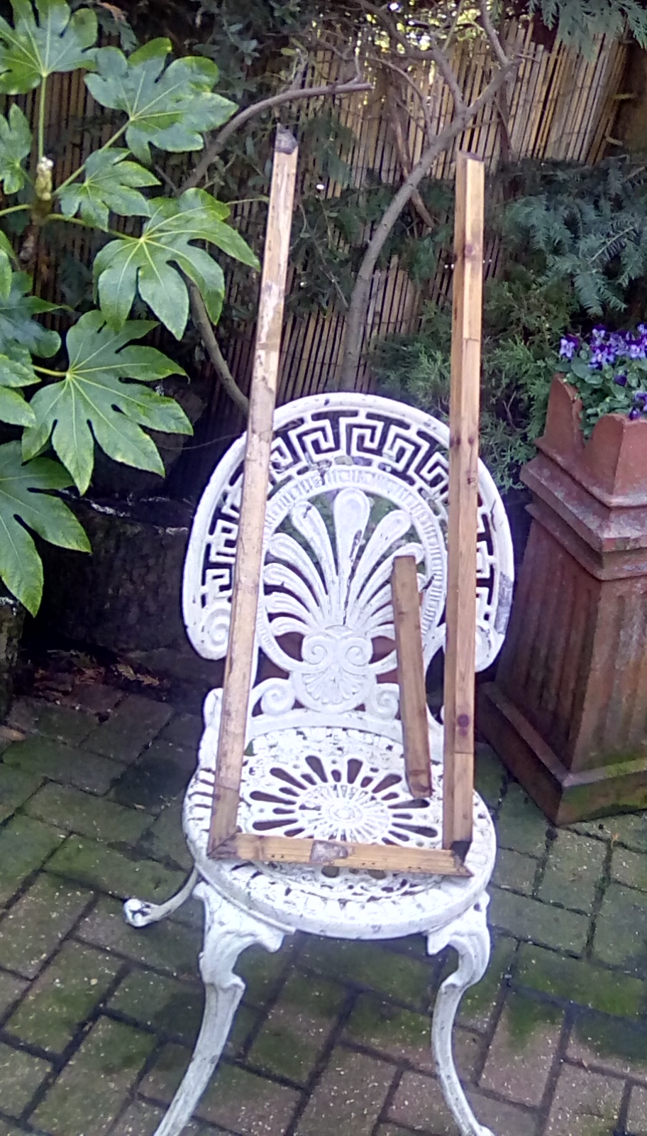

I intend during lockdown to try some brown paper on a frame to see what happens.
I have an old frame I used to mount a 5mm xps sheet to,the sound wasn't good so I dumped it in the garden,I've found what's left of it and cleaned off the green algae,amazing what a good scrub and bleach can do.
The smallest dimension is going to be 10 or 12inches depending upon where I glue the paper.
I'm not expecting much but am always willing to be surprised.
I think I might try gluing the exciter on the paper as tight as possible first ,then testing the panel again after shrinking.
If all goes well I will then attempt to attach a 2mm balsa or card panel ,not sure which yet.
The picture of the frame,needs a bit of drying out before cutting.
Steve
