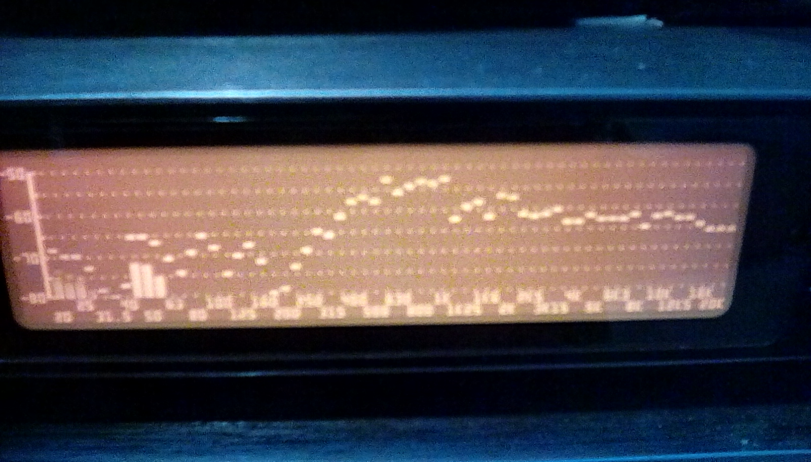

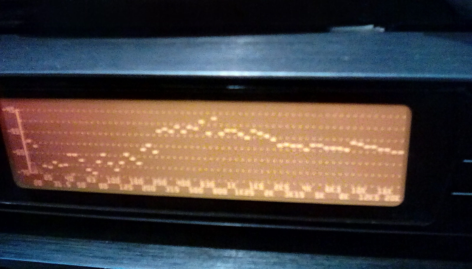

This is the frequency response of the right panel.
The first pic on the left is at 1mtr and the second on the right is at 3mtrs.
I only had the LF running up to 100HZ ,so there was a large dip in the response until the panel started to take over at about 200hz.
Steve
