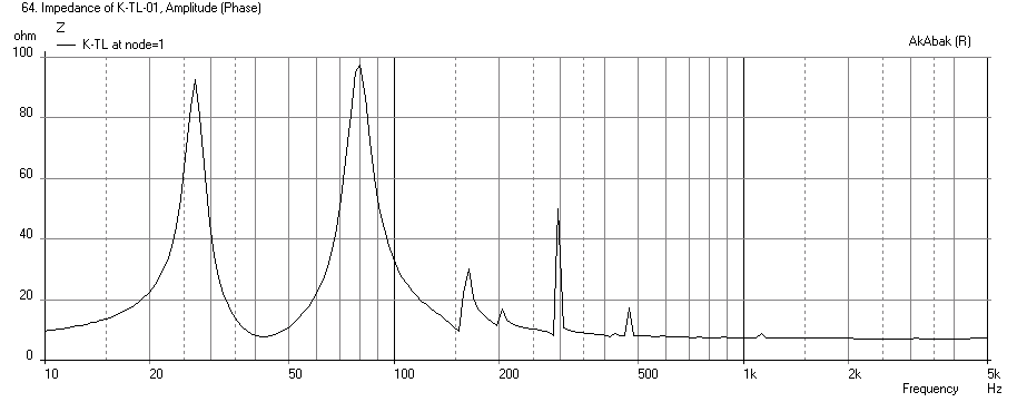

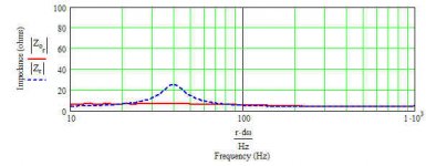

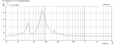

I am not sure how to recognize 'horn' impedance curves. Other than hey have more than 2 bumps ? MLTL have 3 bumps and I suppose horns has even more? Still learning this, and reading Z curves is not something I know how to do yet.

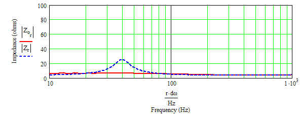

Horns can have lots of peaks, but should a perfectly horn-loaded dynamic driver not have a fairly flat Z profile within its BW?
A typical Karlson usually exhibits an impedance curve close enough to that of an equivalent BP6 box.
IG

here's Z for 3 bifurcated horns of mine plus a pipe - the Zu style pipe is an easy build
IG

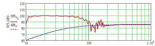

It will be pretty much dead flat, but the trade-off is its BW will be defined by its LF and HF corners where Fs is the mean, i.e. this will be its entire usable BW and huge.
I approximated one some years ago with MJK's original BLH software using a small TB W6-1139C to prove it to a naysayer. It's an expo, but needs to be hyperbolic to smooth out its extremes.
I didn't try to calculate its size, but obviously it will be at least small house size to accommodate single digit frequencies, so such alignments are only suitable for higher frequencies in a multi-way system.
Right, as I previously noted, all the K alignments are 4th or higher order of BP with each resonant cavity adding another order and tapped when 6th, 8th [don't recall any higher order alignments ATM]

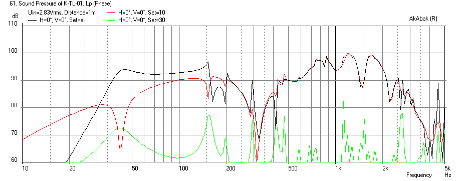

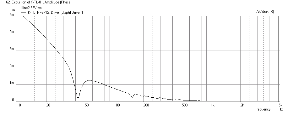

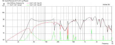

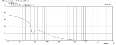

The Karlsonator Scales Well to Smaller Drivers!

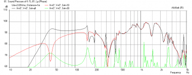

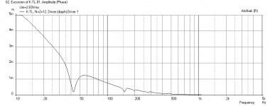

I thought I would try scaling the Karlsonator to a smaller driver to see what happens. It turns out that because it is a TL, it scales quite nicely and is very forgiving - unlike the K15.
For the first case I decided to use something small and crazy, almost anathema to a typical large Karlson: a 4 inch Tang Band W4-1320SIF bamboo cone driver. I simply scaled the width and depth by 5/15 (33%) to give the box some room to mount a 4 inch driver, and I scaled the vertical direction by 10/15 (67%). This produces quite a neat little box that is about 5 in wide x 5.5 in deep by about 20 in tall. I am looking at the response in the near field with the speaker pushed back touching a back wall. The freq response surprised me with how flat the bass shelf is. There appears to be some room suck-out at 250 Hz and 600 Hz - which may be a deal breaker but I think some stuffing and room placement may solve this. The second plot is the impedance and this looks OK I think, and the third plot shows the cone displacement, which looks well controlled given that max excursion is 4 mm on the Tang Band. I think the 40 Hz bass extension with 90 dB sensitivity is actually quite good for this enclosure given that no optimization was done for the T/S parameters.
For the second case, I am using a completely different character driver: the high sensitivity BLH special - Fostex FE166EN. Here, I scaled the cabinet by 7/15 (47%) in width and depth to accommodate a 6.5 in driver and I scaled the height by 13/15 (87%) resulting in a trim looking cabinet that is about 7 in wide by 7.5 in deep x 26 in tall. The fourth plot shows the frequency response, which also shows deep bass extension to 40 Hz and around 90+ dB sensitivity (low for the Fostex) and a big dip around 300 Hz - but the native high freq efficiency of the Fostex may sound too harsh and 'shouty' combined with the bass that is only 93 dB. Not too bad though - given that it is a completely different driver with low Qts and high Bl. The fifth plot shows the impedance for the Fostex and the sixth plot shows the cone displacement - kind of exceeding the 1 mm max.]
So in summary, I would say that the Karlsonator is great for getting pretty good deep bass with a flat bass shelf from 40 Hz to 150 Hz and is very scalable with driver size. However, given that the design does not restrict cone excursion as well as the original Karlson, I would pick drivers with higher xmax - which will give a more balanced sound as the the low Qts high Bl motor drivers will be very 'shouty' with their high frequency SPL compared to the bass that is produced. A driver with about 85 to 89 dB efficiency and Qts of 0.35 to 0.50 may work better.
