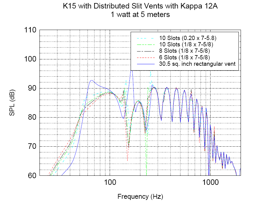

K15 with Distributed Slit Vents
I added the option to have the distributed slit vents per the Popular Science drawing from 1955. I approximated the slit vent as a single very long one located at the middle of the top angled reflector panel rather than spread out with 1 inch C-T-C spacing. Not sure if it matters but I was too lazy to add 5 more vents. The effect of the frictional losses due to the thin aspect ratio is there though. The slit vents really suck the bass out of the speaker. I tried adding more length in increments of 7-5/8 in slots. That did not help much and I finally increased the gap from 1/8 in to 0.20 in and that helped things a lot. This will probably give a more smoother balanced sound that is less punchy.

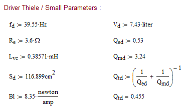

Driver specs attached.
Flare = 10.48 Hz
M [T] = 0.488
filter chamber [Vf] = 20.893"^3
compression chamber [Vr] = theoretically infinite
throat [St] = 4.52"^2
terminus [Sm] = ~66,244.786"^2/2pi

since the Karlson enclosures for the most part were sold unloaded in the days of mix and match the cabinet with a driver, its possible he thought the distributed slit vent cabinet did better with some of the cheaper/weaker drivers (?)
each slit sees a different impedance due to the front chamber and distances. A Lafayette K12 had only 3 slots but they were spaced over the same distance as the 6 slot K12 and my 4 slot K12.4 slit
this on the right may be a 4 slit - is there room for one more?
the really narrow slits like small holes whether in a K or reflex will produce high velocities and high harmonic distortion if fed by by a sine wave in the vicinity of fb. I've run a 41Hz sine wave into a 15" driver 3.6 cubic foot bass reflex tuned with 42-3/8" holes and it felt like a good fan 8 feet away with only 12 watts input.
under dynamic conditions the really restrictive ports must cease to radiate at their small signal fb, introduce drag - and with sine - perhaps "rectify" (?) - in a reflex that can cause cone offset from center.
