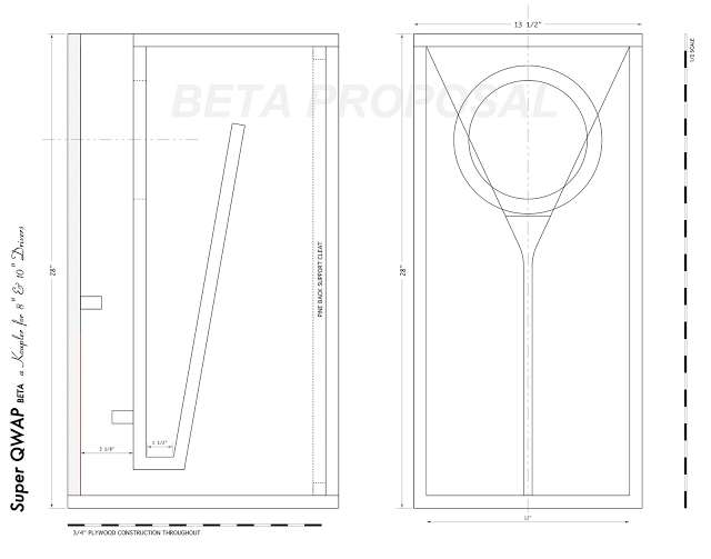

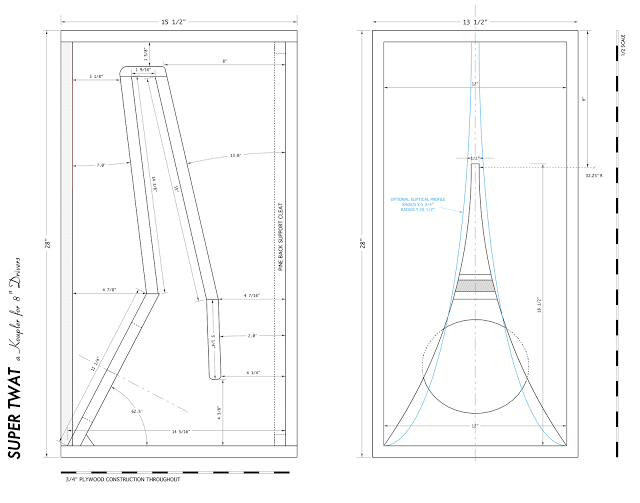

The two designs attached interest me most right now, however my shop access is limited these days do I would have to make a lot of plans and get my ducks in a row to build up either. Best regards Moray James.
Moray James,
Is there a vent above the driver in the Super t w a t? The front view looks like there is but not in side view?
As far as I can tell there is no vent above the driver. The two designs are far more alike than different. The intent is to use a 1/4 wave line and to place the driver at a nodal point along the line. Perhaps Greg would comment they are his creations. Best regards Moray James.
the only vent in the Super t w a t is at the very top. When John Lapaire did some testing of the design, John made a rough testbox which at first had the Karlsonette vent - then converted to GB's scheme for comparisons. Imageshack loses a lot of my images so I don't have a really clear picture of the testbox front and will have to search for John's graphs. I do have a pair of similar height K-couplers with the Karlsonette position vent. Anyhow, Lapaire liked GB's scheme but the box was destroyed in a basement flood.

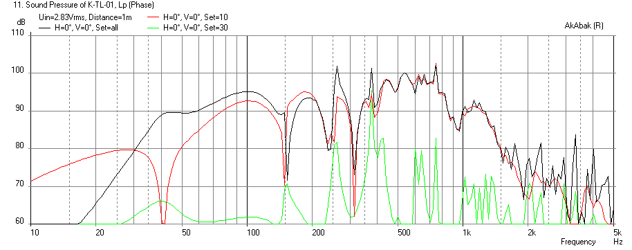

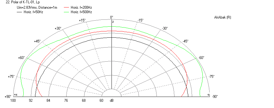

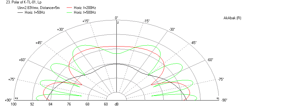

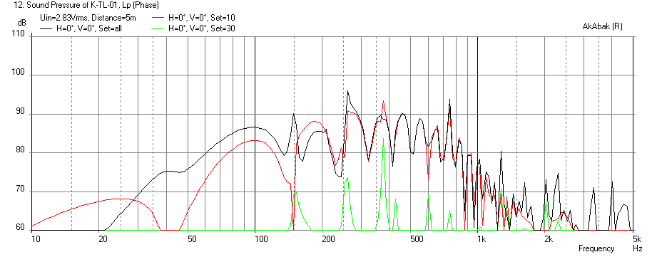

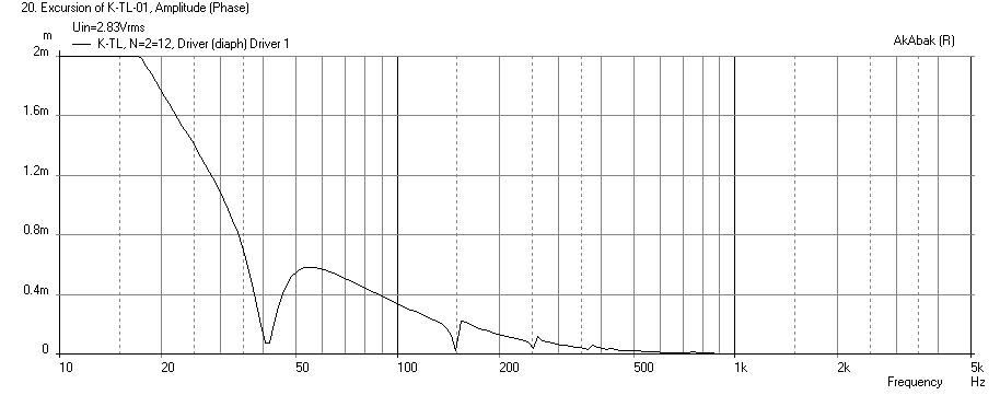

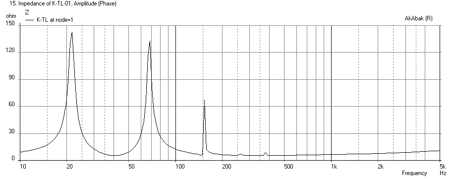

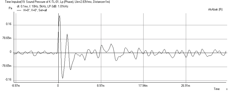

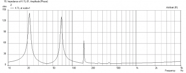

Model of Karlsonator with Kappa 12A
OK, I finished the model of the Karlsonator and it looks pretty interesting. It has much deeper bass extension but the punch falls off quickly as you move away from the speaker. Out at 5 m away the lower bass is kind of low and the remaining bass is in the 90 to 110 Hz range and at much lower SPL than the K15. So it is showing that the TL-terminated by K-slot is not as efficient as the K15 but has lower extension as shorter distances.
First plot is freq response at 1 m with 1 watt input, second plot is freq response at 5 m, third is the impedance, fourth is the speaker cone displacement, fifth is the polar dispersion at 1 m (good), and polar dispersion at 5 m (not so good), sixth plot is the impulse response at 1 m (good clean punch). So it is looking like the Karlsonator is good for smaller spaces where you want deeper bass extension. Cone motion is well controlled above 40 Hz, but it sort of gets out of hand if you have LF stuff from HT and such.
Does this response look anything like what folks have measured? I wasn't sure what driver to use so I picked the Kappa 12A.

So the burning question to me is what are the variables which contribute to shifting the impedance in a Karsonator or a Super T W A T? How about constricting the open line area? Clearly the longer line provides (as intended) greater bass extension so the missing element would then be a better impedance match to provide the great coupling of the K15. Your thoughts would be most welcome. A relatively compact (from a domestic point of view) design which work well in the near field would be the ticked for home use where most of us sit within the near field.
I have a suggestion. Can you model (on the Karlsonator version you just did) the eccect of a layre of camping in the line section which is placed on one wide surface? The damping would stay on the same surface following bends from start to finish. The intent he is primarily to develop consistent turbulence in the line and hopefully to increase the impedance of the line. Thank a million for this terrific opportunity to have you model like this, very much appreciated. Best regards Moray James.
I cannot model damping in AkAbak. I am guessing that the throat CSA is important as well as the length of the line leading to the throat. The width and profile of the K slot on the front will probably be less of an effect. The volume of TL will be important as well as the location of the driver along the transmission line.

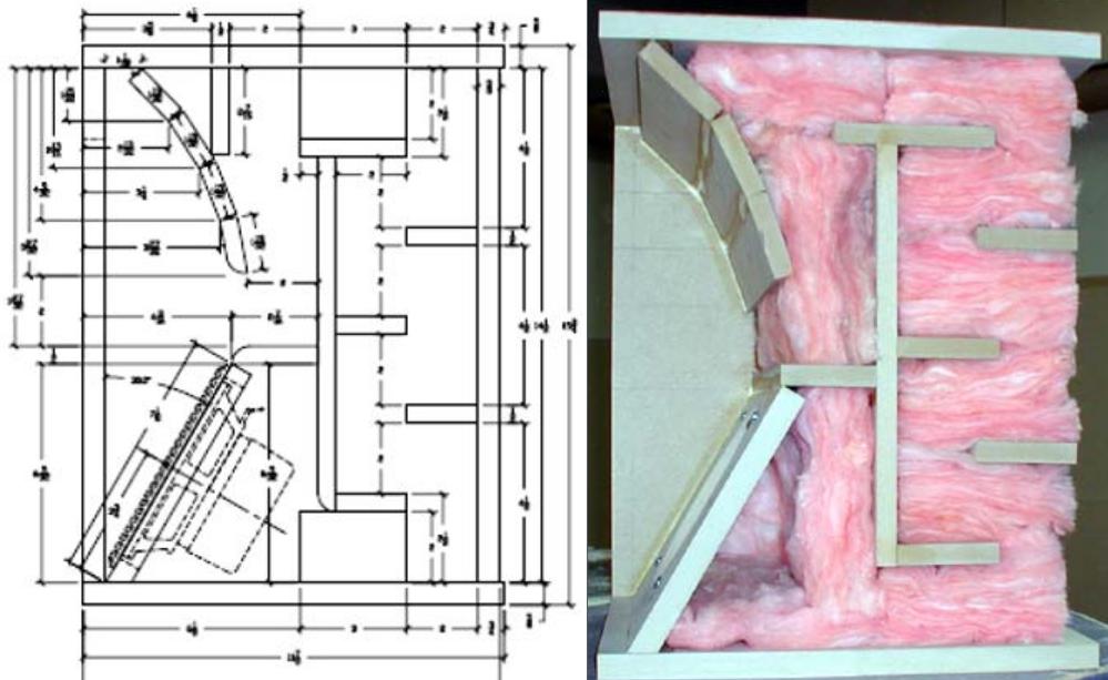

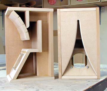

115BK internal layout side view. The ~27 sq.in. vent is centered in the upper board - internal width = 19 inches and the wings are radial arc with about a 1/4" starting gap
