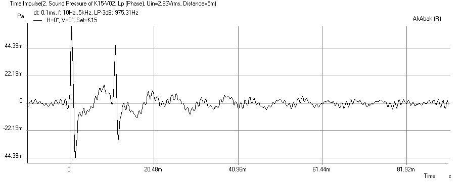

Is this a 'Good' Impulse Response?

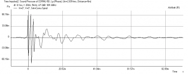

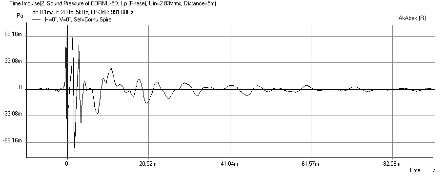

I am looking at the impulse response of a Karlson vs several other speakers. Below is the impulse for the K15 with a Betsy K driver vs a very large (3 ft square) wall mounted Cornu spiral driven by a tiny (compared to Betsy) 5 in Tang Band W5-1611. I am comparing these two very different speakers because I was surprised that it can achieve a very nice 50 Hz to 100 Hz bass shelf at 5 meters with average 88 dB efficiency at 1 watt.
So when looking at impulse response functions, which one would you say is "better"? I think the K15 has a 'clean' single after spike, but with longer time delay of 10 ms and lots of little ripples. The Cornu on the other hand, has several smaller after spikes, but they are all very close together. Will this give a more 'diffuse' bass signature whereas the K15 is a sharp punchy bass signature with what we call 'Kick'? The 'Kick' term seems to often be used to described the Karlson, and I wonder of the cleanliness (sharpness) of the second spike is the reason? Hence why the Karlson kicks butt

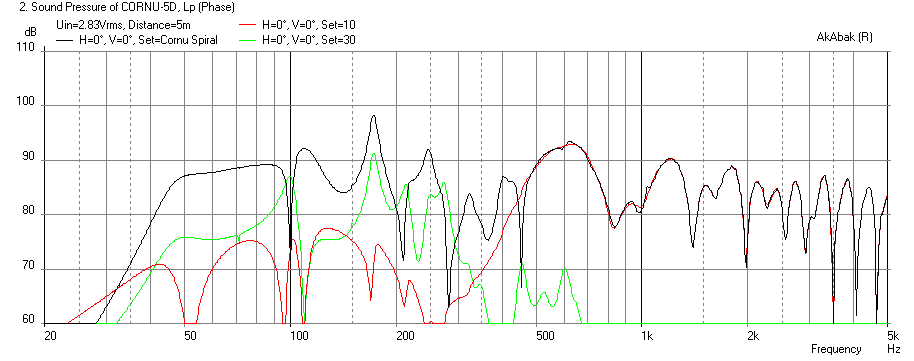

You have all seen the freq response sims of the K15 with Betsy so I will not post it again. The first plot is the freq response of the Cornu, the second plot is the impulse response of the Cornu, and third plot is the impulse response of the K15.

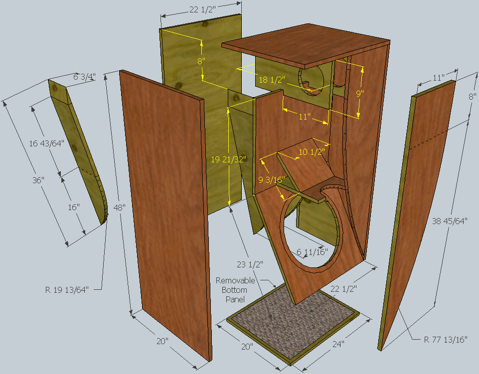

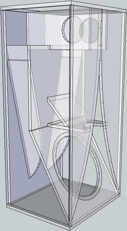

I would model this but it is too complicated being full blown 3d passages. Maybe one day when I have lots of time... is there a fully dimensioned set of drawings that will let me get all the critical dimensions from?
Pretty sure that drawing gave all dimensions that weren't obvious
by addition or subtraction. The wood was 3/4 inch if not obvious...
You can check any uncertain dimension against original sketchup.
Bottom panel is missing, should be exactly the same as top panel...

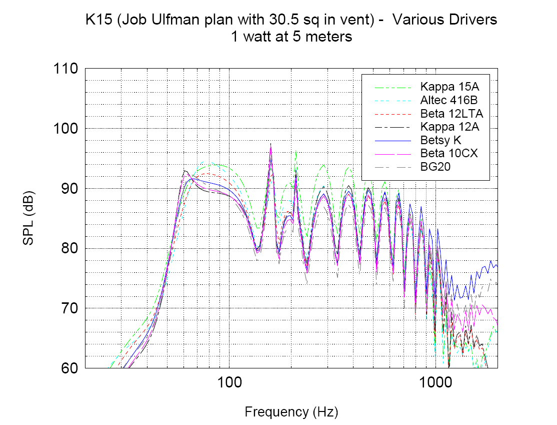

Here is the 1954 K15 (Job Ulfman adapted) plan with reduced 30.5 square inch vent, fitted with all the drivers that I have modeled so far. The Betsy being a "baby" driver actually fares quite well compared to some the more "pro" drivers. If you want ultimate kick it looks like the Kappa 15A is the way to go but at expense of as deep bass extension. 94 dB with 1 watt at 5 meters is pretty impressive anyway you look at it.
how does K15 look in simulation with the popular Eminence 12LTA?
12LTA looks very comfortable in K15 - if I can move enough stuff around I'll load 12LTA for evaluation and add a K-tube helper tweeter. All of this really amounts to nothing as very few will try a Karlson but are giddy about reflex and pipe. I have some opinions on audio after 50yr of piddling.
it looks like Kappa12A (which I have) would like a smaller coupler than K15.
