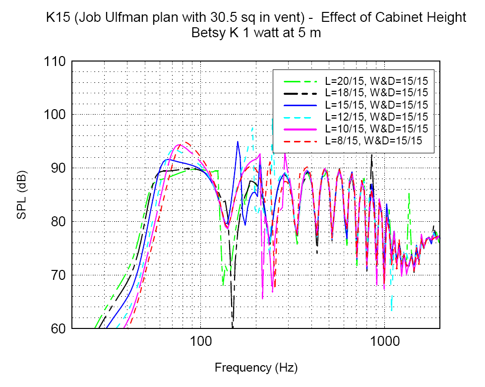

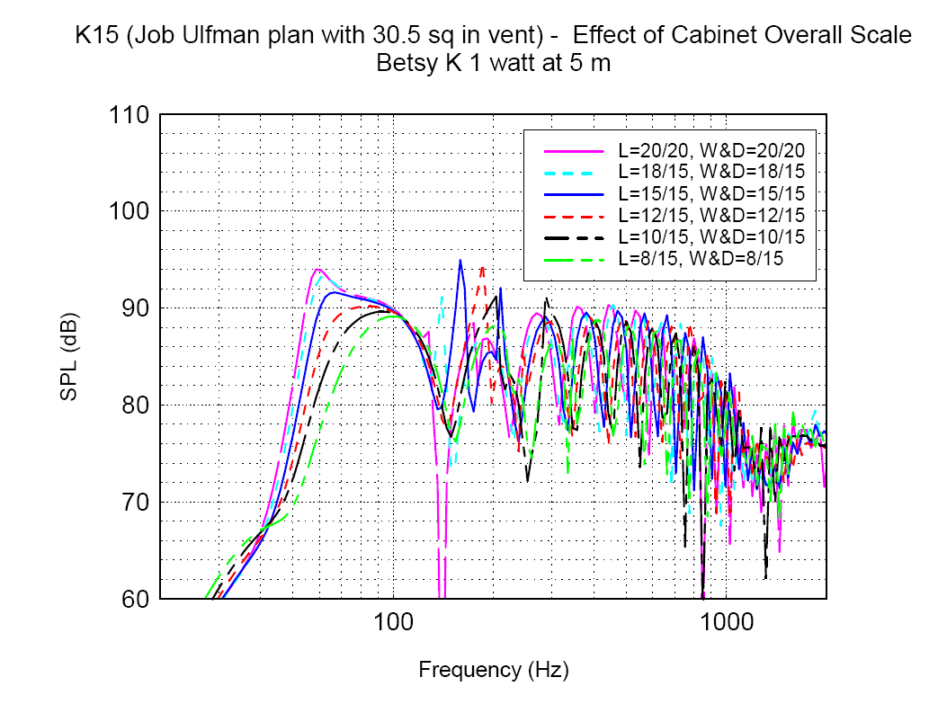

Effect of Aspect Ratio on K15 Behavior
Freddi,
Here is a study of the effect of aspect ratio of the K-15 on the frequency response. I decided to examine it parametrically by:
(1) changing the cabinet height and keeping width and depth fixed - first plot;
(2) changing the overall cabinet scale by changing height, width and depth simultaneously in the same direction - second plot;
(3) changing the overall cabinet aspect ratio by changing height vs width and depth in opposite directions to get a skinny vs fat profile - third plot.
As you can see, you can achieve the best success by keeping the width and depth fixed while changing the cabinet height. When changing overall cabinet scale, going down to a 12/15 scale is almost as good as the original, but at 10/15 and below, the bass extension really suffers. Finally, on overall skinny vs fat, it appears that the proportions that Karlson came up with for the original is basically perfect - and deviating from that appears to drastically affect the performance from either too much bass peaking for squat (fat) cabinets, to depressed bass performance for a skinny implementation.
All simulations are based on the 1954 K15 plans as adpated by Job Ulfman with a 30.5 square inch vent and the Betsy K driver with the mic at 5 meters away and the speaker located 60 in away from a back wall. This is the 9 aperture Karlson slot AkAbak model (recall I did 14 apertures and there was little difference).
I hope this helps to explain the generalized effects of scaling a K15 cabinet without optimizing any other parameter.

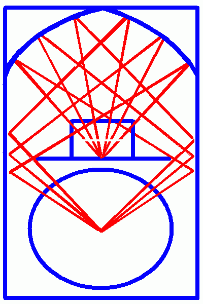

Perhaps we should do a little JEK style ray tracing and see if we can get
the curved reflectors to focus upon the angle plate? I'm counting on the
interferance pattern of the crashing wavefronts, but doesn't hurt to have
a synergy of helpful things going on.
If the K15 front shelf were turned sideways, how many degrees of arc
would each of the shelf side gaps appear to loudspeaker? And then if
it bounces cleanly off the sidewall, where exactly aboive that should
the kukoo clock reflectors be to recieve full illumination? What shape
to focus on the angle plate, or maybe upon slot center after bouncing
that angle???
No no no , focus on the top center of the shelf! That's the ticket...
If angle plate is 45deg, that puts our real focus on the front slot.
I gotta check that all the bounce angles look plausible and path
lengths about the same. Not saying they are, saying something
I definitely ought to check...
My existing drawing looks like the focus is way too high up in
the chamber for any synergy with the interference stripe exit
strategy. Maybe I can improve upon that...

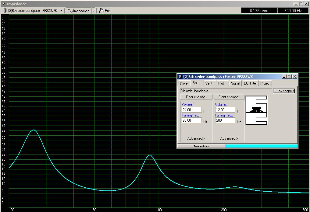

I've compared a couple of drivers in SK8, using my typical WinISD BP6 adapted simulation.
Fostex FF225WK - I have these in my pair right now
Celestion TF1020 10" midbass - I have these at home and yet to try in SK8
Eminence Beta 10CX - would like to try these sometimes
All three have acceptable response and I was mainly concerned with power handling to see just how loud each can get. Limiting cone excursion to each driver's Xmax figure for the excursion peak above Fb, they can each do:
FF225WK, 2.3mm : 20W input for 108dB @100Hz
TF1020, 2.0mm : 35W input for 110dB @100Hz
Beta 10CX, 5.0mm : 140W input for 118dB @100Hz
FF225WK might be at a disadvantage with less cone area and probably more power compression, which is not taken into account here. Still, it has the most low-end of all three and is thus likely to sound better small-signal. Its upper limit is more than enough for home use in any case IMO.
All three drivers can handle their above respective power levels down to ~50Hz before busting Xmax. I know Xmax can be a somewhat vague figure with no universal standard for specifying it, but I don't have anything else to go with. 🙂

How are you modeling the SK8 in WinISD with a 6th order bandpass? Just volumes and vent dia and lengths - can you share your simulation input parameters? How close does it come to measured output - especially bass extension and SPL? I am surprised that the FF225WK has the lowest extension - the Beta 10CX is what I would have thought. That driver will make you deaf at 140 watts! I have some Texas Instruments TAS5630B class D amp IC's I have been thinking of building into a full amp that can produce 300 w/ch at 10% THD but at 150 watts/ch they are good for ~0.1% THD - perfect for blowing out your ears with low distortion! 🙂

I try to use the actual rear and front chamber volumes based on plans. I cannot simulate a true K-slot, so use Ql=3 for the front chamber; seems to bring the upper bass peak down to measured levels. I do not set vent geometries but just input the tuning frequencies for already measured enlcosures, or the desired ones I'd then match at the build stage for prospective ones. WinISD won't take into accout the mass-loading effect of the front-chamber's air mass on the internal vent, so it tunes too high when using actual dimensions.
As for the second and highest tuning frequency, that of the front chamber in the BP model, I use a quarter-wave of ~90-95% of the internal chamber height, assuming a cabinet of traditional aspect ratio. Doing so for different geometries such as higher-aspect Karlsons (HAK) is not always as accurate.
I use these dimensions and tunings usually, rear-chamber and front-chamber respectively:
K15 - 110L@45-50Hz / 65L@115Hz
K12 (to matche the Karlsonettes I had) - 36L@60Hz / 25L@155Hz
SK8 - 24L@60-65Hz / 12L@200Hz
As mentionned above, I set Ql=3 for all front chambers. Here's what it looks like and I'll re-post a measurement of SK8 to compare.
It is a limited and crude model , yes, but I think I've done it enough that I can get a fair enough idea of a specific driver's suitability for a given enclosure if nothing else. Goes without saying that this is good for the bass response only.
Plugging Beta 10CX in the K15 looks like it'd kick some serious butt with great low-end. I'm not surprised that FF225WK has the "best" low-end in SK8 versus the two 10" driver I compared, this has generally been the experience of K-users I believe. Perhaps a comparatively larger rear chamber volume and less cone area for the front chamber pressure to act on won't limit the LF output as much. The larger drivers will handle more power ultimately though and can probably take more EQ.

Under the Volume and Tuning freq. fields, click Advanced->. You have options to set Ql (leakage loss), Qa (absorbtion loss) and Qp (port loss).

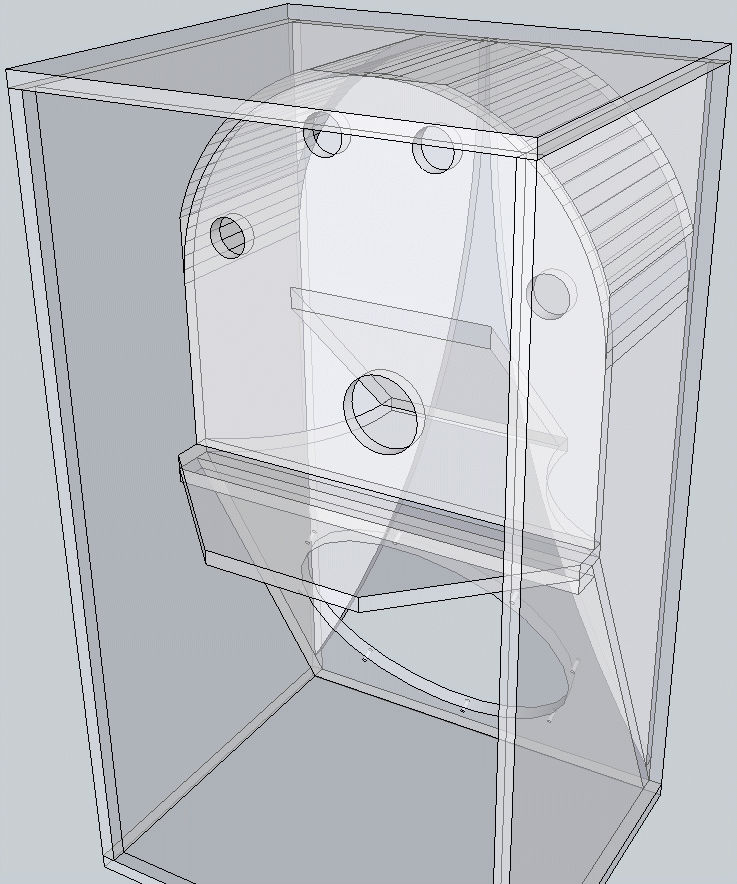

After some very rough ray-tracing, I submit this revised shape..
Real focus is the front slot, after hitting the 45deg washplate.
This way: Wether it works like a vertcal stripe of interfering
wavefronts, or JEK style rays as drawn here, either strategy
gets to the front slot and out with minimal reverb...
Not exactly whats shown in this old sketchup, but close...

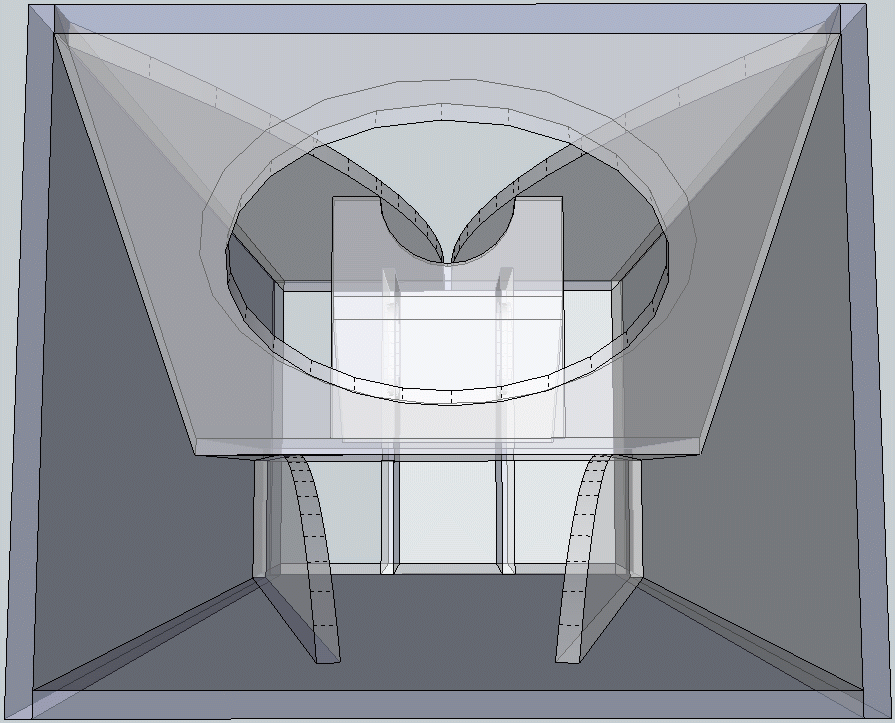

Do we want a full sized washplate, or leave
room for a half moon or V cutout in the shelf?
Ignore the rest of this view for now, just
look at the shelf and washplate style as-if
they were grafted to the design above...
Which way might be better do you think?
Give the driver clear view of the full slot,
or give the upper chamber a cleaner exit?
