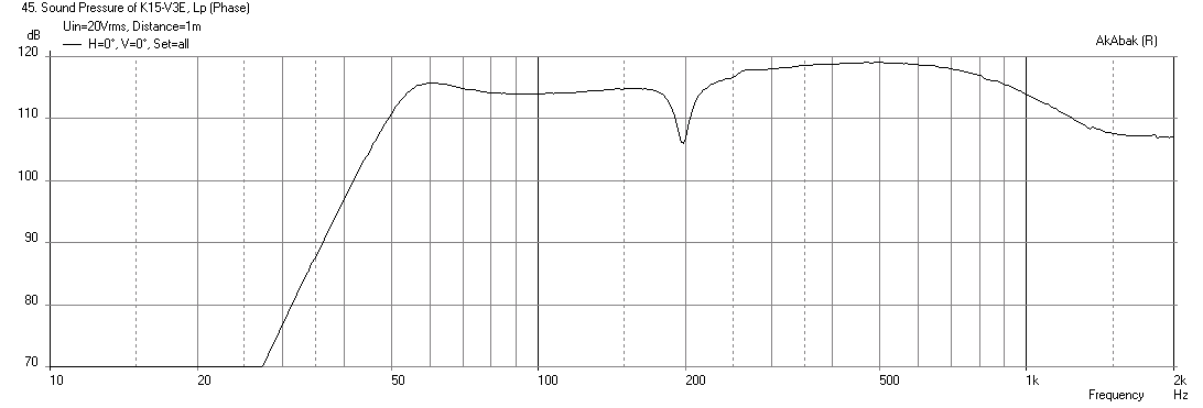

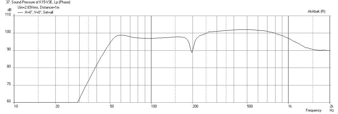

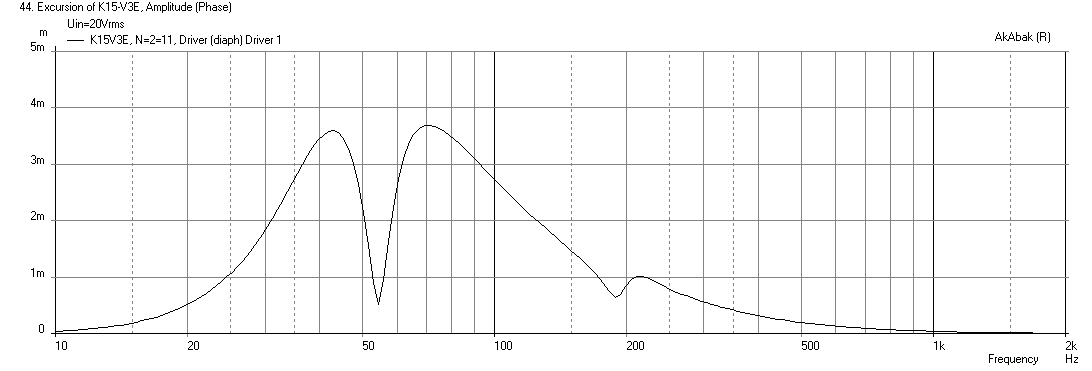

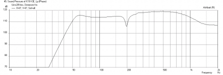

Freddi,

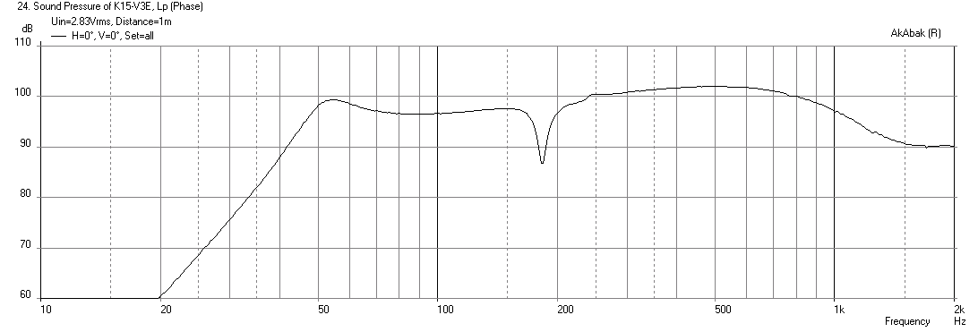

The Kappa12A works beautifully in an 0.8x scale K15. With a 45Hz 24dB HPF you can get at most 20v into it before hitting xmax. The response looks great though.
Response at 2.83v:
xmax:
Max SPL:

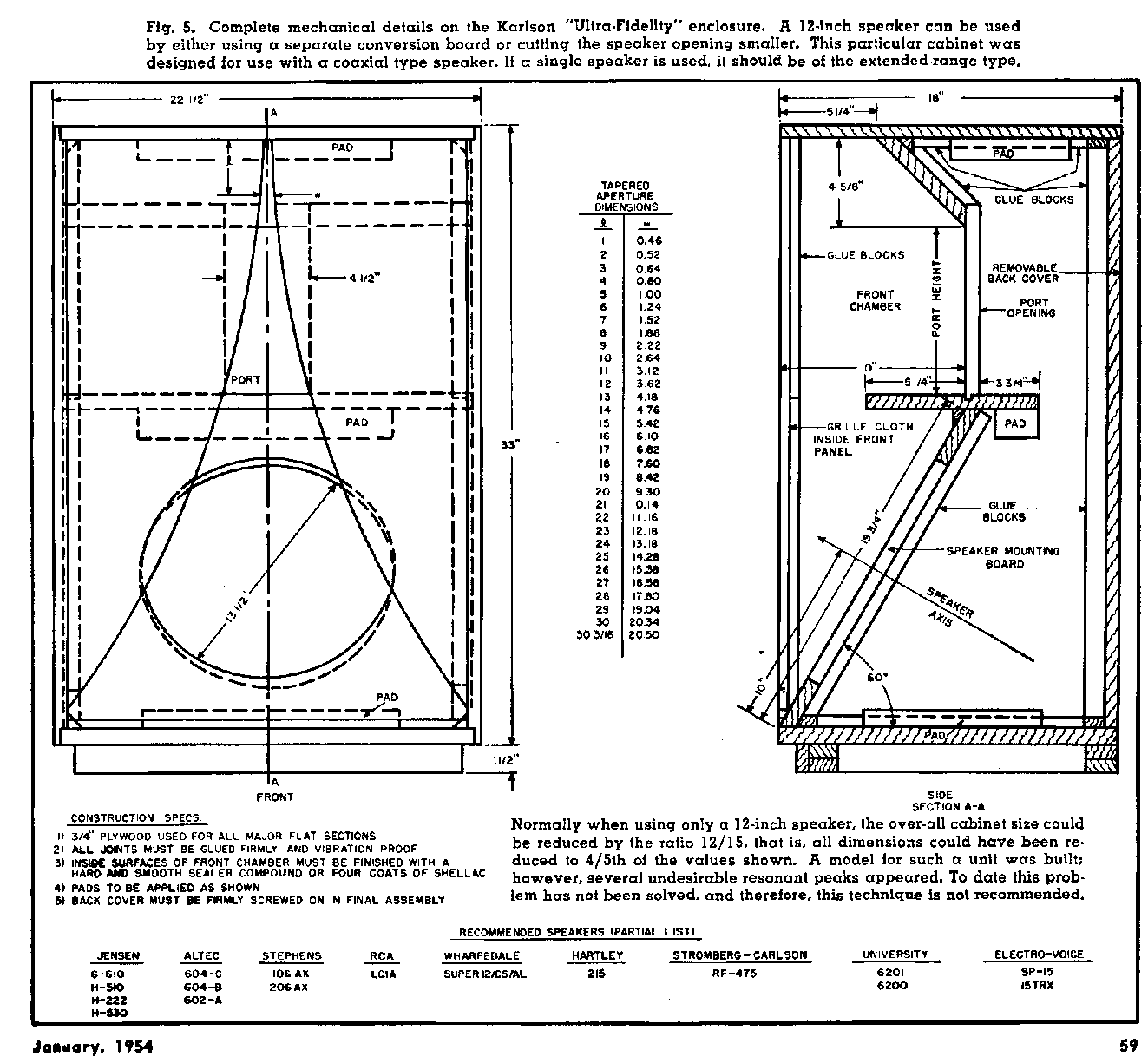

Karlson in the 1954 Radio Television News article, warned against scaling K15 by 0.8 - perhaps to make for better sales of the upcoming K12 - my old graphs showed 0.8 to be smooth.
with a Pyle 1298 (~same as Kappa 12A) in K12, there's no problem with 200 watt peaks on drum albums. Karlson made K12 with slit vents - possibly to get a better match with weaker motors as that was the age of separate cabinets and speakers and possibly as he did not worry about the vent's ability to carry sine wave.
this was originally made with two 3"x3" ABS ducts but K15 style vent proved superior - at the time it ran a Sammi 12 woofer and was tried with JBL 123
The Kappa12A has perhaps one of the nicest looking responses in a K15 type cabinet. It is super sensitive and you wouldn't need more than 2 watts to enjoy it with chest kicking punches. I want one! Could even be a sub for my Trynergy!
But the 1954 plans (see attachment) said that an 0.8x (12/15) scale model had been built, although there was a resonant peak and because they could not solve it at that point the 12/15 scale was not recommended. I wonder what resonant peak they are talking about? It may be that at the smaller size, the front K-aperture distance to the cone may match another resonance and cause a problem? This cannot be modeled in Akabak as it is a lumped element model. A 3d FEM can do it though.

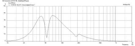

The Kappa 12A can probably handle 8mm cone displacement (xmech limit is 11.5mm) without damage (w/ 40Hz 24dB HPF). That's what happens with 200 watts applied, and here is the resulting output. Ouch, my ear drums!

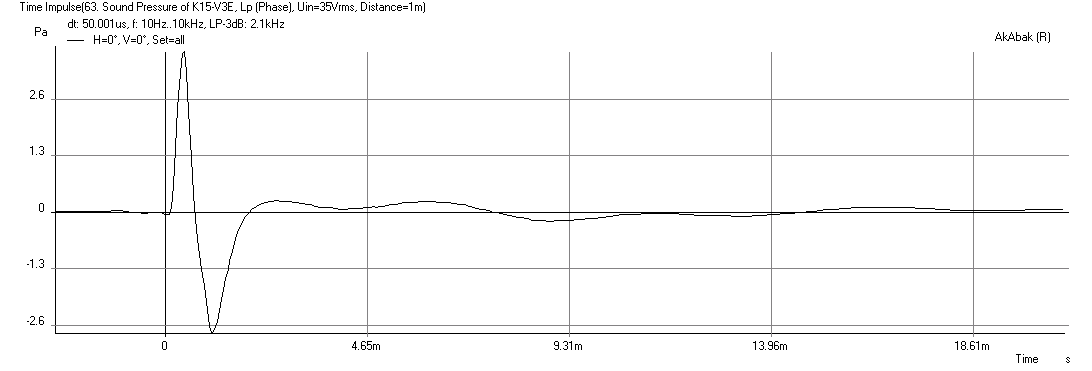

Here is the impulse response:
It should give a great rendition of drums if that is what you are looking for, or perhaps can double as a defibrulator 🙂
