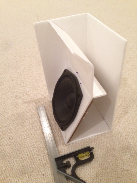

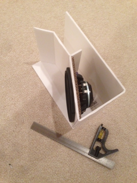

from Briggs "Loudspeakers" something for you to try in cardboard

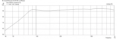

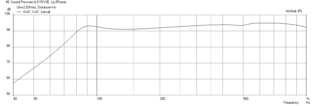

Back to big K15 variations - I'm still wondering if that infinitesimal slot effect is real or an artifact of the simulation. It seems to have a surprisingly large effect.
I wonder about that too. But I believe it is consistent with what I have heard Freddi say that the top narrow portion has the largest effect on the sound. If you think about it as a source of pressure leakage - the top has the most impact as the vent is at the top. A measurement would confirm but I don't have a K15.

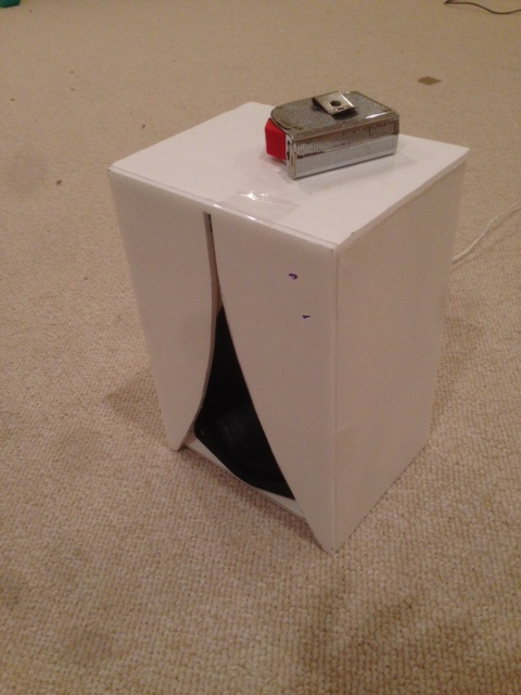

0.35x K15 with B&C 6MDN44
I just started my build of a 0.35x scale K15 for the B&C 6MDN44 driver (http://www.parts-express.com/pedocs/specs/294-645-bc-speakers-6mdn44-specifications-46948.pdf) in order to use as a study test bed for looking at the effects of K-aperture slot geometry. My goal is to reach 100 Hz bass extension with this midrange Nd magnet pro driver. The scale works perfectly for foam core because it is another "one sheet" wonder. I am using the single length folded (no-cuts) middle panel construction technique which goes very fast. Basically, the back, bottom, and all front panels are connected in one contiguous piece and folded at the appropriate locations. This enhances strength and makes fabrication very easy and fast. The photos shown here show progress I made with 45 minutes of work into this - pretty quick build as speakers go. Just need to cap off the side and add K-aperture with screws for testing different ones.

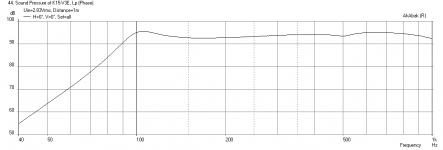

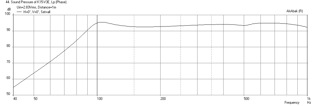

Here is the predicted response with a narrow slot aperture:
This is the predicted response for a cusp top aperture:

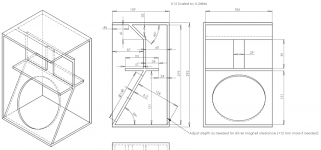

Attached is a scaled plan in millimeters.
it'll be interesting to see the differences between it and similar size Karlsonator - do you expect frequency response effects to be scaled ~3X that of K15?
Scaled in what sense? Bass extension is less if course as shown by prediction. The Hf's will be limited by max freq of the 6MDN44 driver which gets up to about 5khz.
The first dip is predicted to be above 1khz although I am not sure how accurately the sim is going to be here as the length scales of the speaker are so much smaller now that there are probably 3d effects not captured by AkAbak lumped element model. Probably need 3d FEM like ABEC3 to simulate properly.

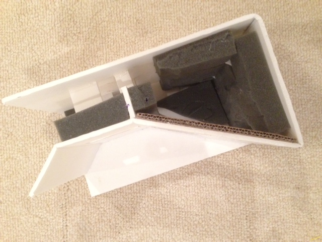

I just finished the speaker except for the K aperture. I plugged it in for a listen and sounds pretty good to my ears. Even without the K aperture, the chambers appear to be very efficiently coupled to the driver cone movement. There is not much movement and you can feel the pulse of air coming out the vent on a kick drum punch.
that's a good sign - the K-slot will diffuse things - are you going to test more than one set of wings/gap?
Yes, I was going to do a small slot and a cusp at minimum, also compare to no K aperture at all.
if one were to dispense with the K-ness then perhaps a slight positive flare to the sidewalls would be good - (?) - I hope to do small K10 and try with a sub for pretty good punch

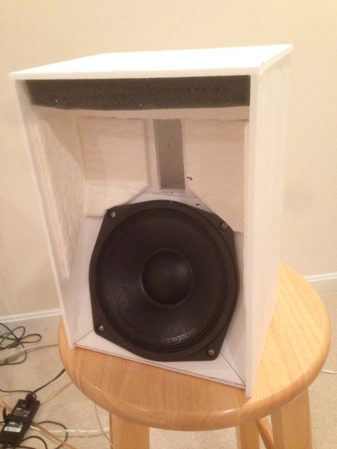

I finished building the main 0.35x scale core sans the Karlson aperture (wings). I added some bracing between the inner shelf and back wall to reduce drumhead flex there. I also added two pieces of bracing on either side of the inside of the vent where it leads to the front chamber to reduce the flex of the front chamber wall. Here is a detail of the bracing described:
I lined the large flat top outer chamber wall with grey foam and lined the remaining flat surfaces of the outer chamber with absorbent padding (double layer disposable "Swifter" mophead pads cut to fit). Traditionally, the outer chamber of K's are left bare and smooth but recently, reports of adding felt to these surfaces helps to clean up mids have been described by several folks to be successful.
I started to make the wings and the initial one is a slotted type. I plan on using two layers with constrained layer damping (CLD) with either latex caulking or latex liquid nails which I have found significantly reduces resonances that lead to harmonic distortion. However, I could resist seeing what a single layer wing does to the sound so I loosely taped it on for a quick listen/test. Here is the wing taped on with clear packaging tape:

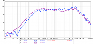

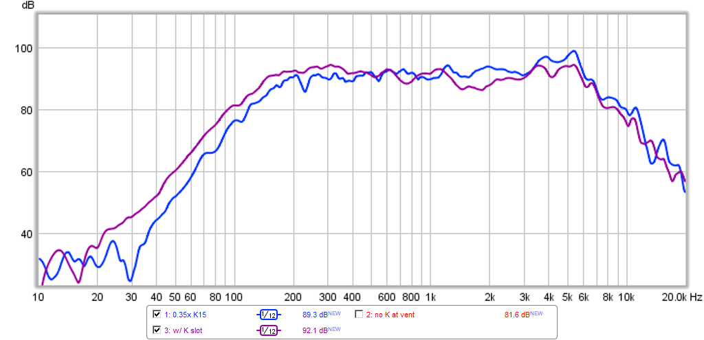

The speaker sounds quite nice with very clear and engaging vocals and what seems like good transients reproduction. Here is a quick near field measurement with and without the wing. You can see that the response without the wing only goes down to 200Hz and has the native 5.5kHz peak inherent to this driver. With the wing gently taped on, the peaks get smoothed out, the bass extension goes to 150Hz now, and the overall balance of mids and lows is better - it appears to negate any baffle step losses. i am hoping that with a good seal it will extend close to 100Hz as predicted by the sims.

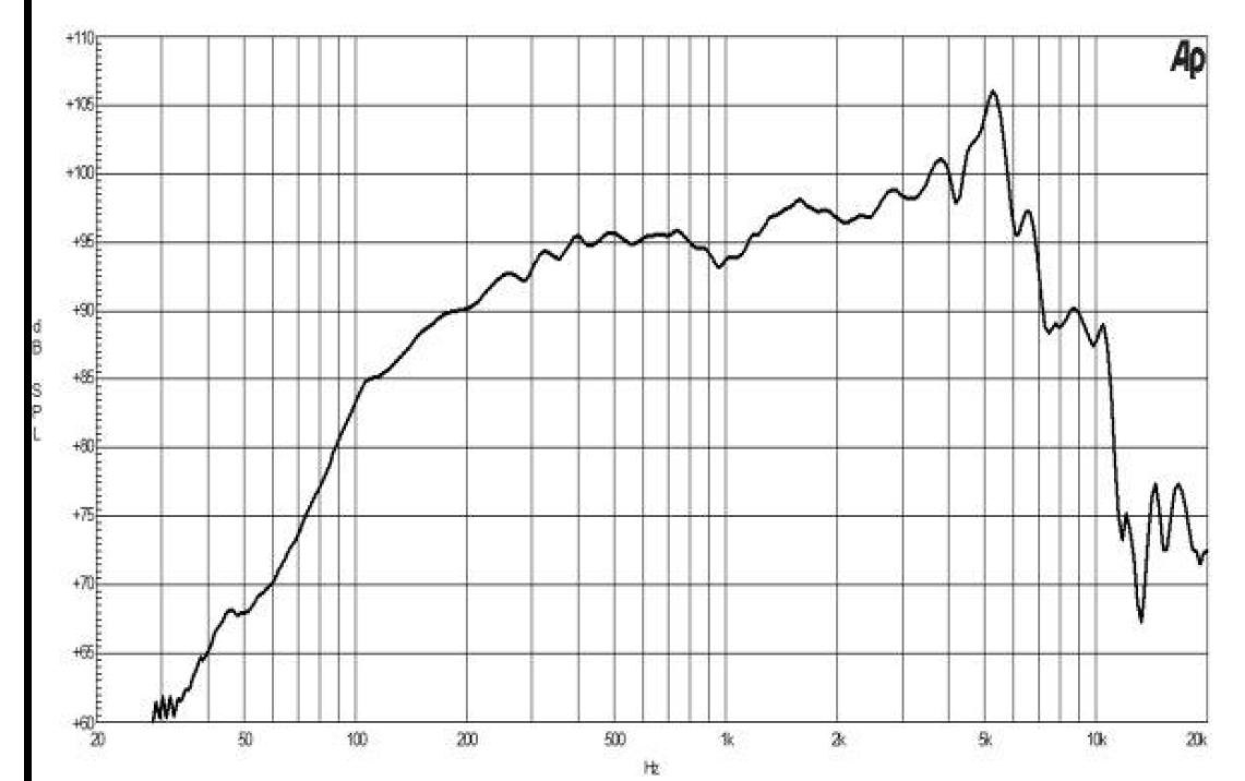

Here is the inherent response of the 6MND44:
