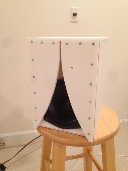

That B&C mid had kind of a high fs of 140Hz and couldn't reach 100Hz. It did reach 150Hz just fine though with great cone control and good dynamics. You would need a woofer to get up to 150Hz to cross with it. Another option is to use an 8in with an fs of around 70Hz and that can get 100Hz in 0.45x K. Certainly a coax can work there too. The 0.35x with the B&C 6MDN44 works real well for mids and vocals though. It can get really loud with high sensitivity and good power handling and cone control. Once I get a woofer tester I can do an impedance sweep to see where the tuning ended up. Also good to see how well the sims came.

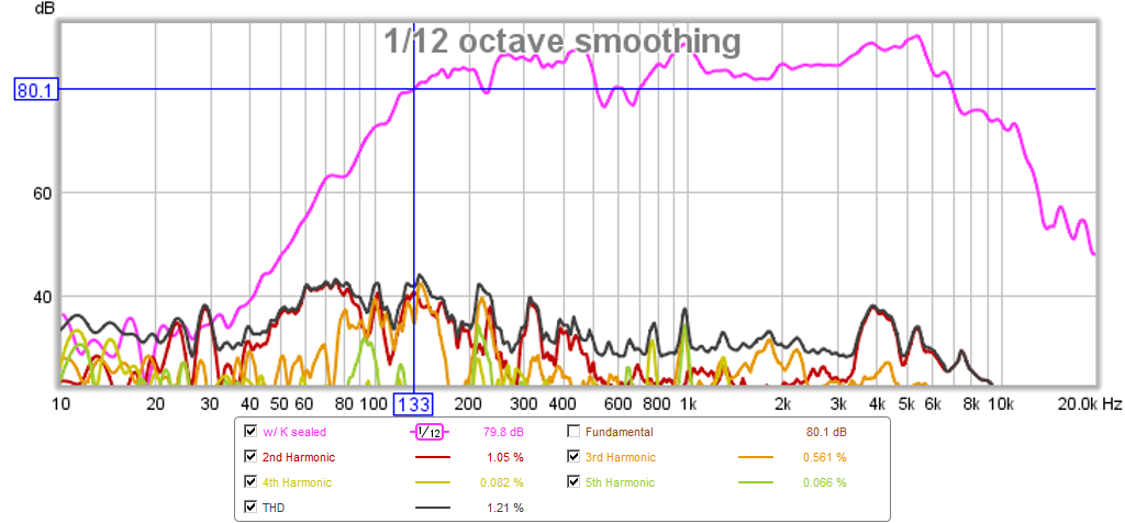

Here is a photo of the 0.35x scale K15 with the 6MDN44 driver with fully-screwed on K-aperture. I used EVA foam gaskets to seal the double-layer wing panel on. What is interesting is that once the wing was stiffened up with double layering and screws along the perimeter, the famous Karlson "W" appeared. Apparently, this may have something to do with the bandpass effect coming into action. It may be that a loosely fitted and semi-flexible wing gives a flatter frequency response?
Response with stiffer and securely held in place wing:
It looks like it is getting down to about 140Hz - right where fs is. The bass extension was deeper with a loose wing panel.
