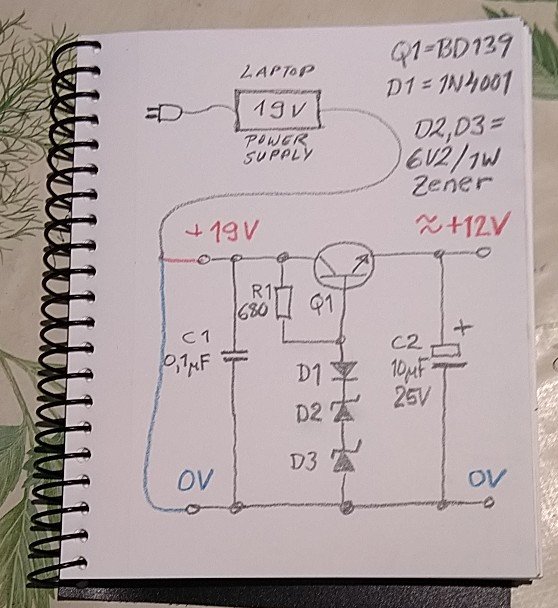

Here is simple and working 'one-transistor reg' a good starting point and amp works well also with this. Use one 12V zener instead of two 6.2V in series, if you have those.

Make the cap too large and it can fry the pass transistor at turn on or turn off. It’s a dead short at start up, but that’s ok if the surge is short duration (milliseconds). At turn off it could hold a charge after the input collapses and reverse bias the transistor. That’s cured with an inverse parallel 1N4001, pointing from emitter to collector. The regulator itself provides a low output impedance so a large bypass cap is unnecessary. Small ones right at the amp’s output transistors are always a good idea to insure that impedance stays low well into the MHz, where wiring inductances or the regulator’s fT are limiting factors.

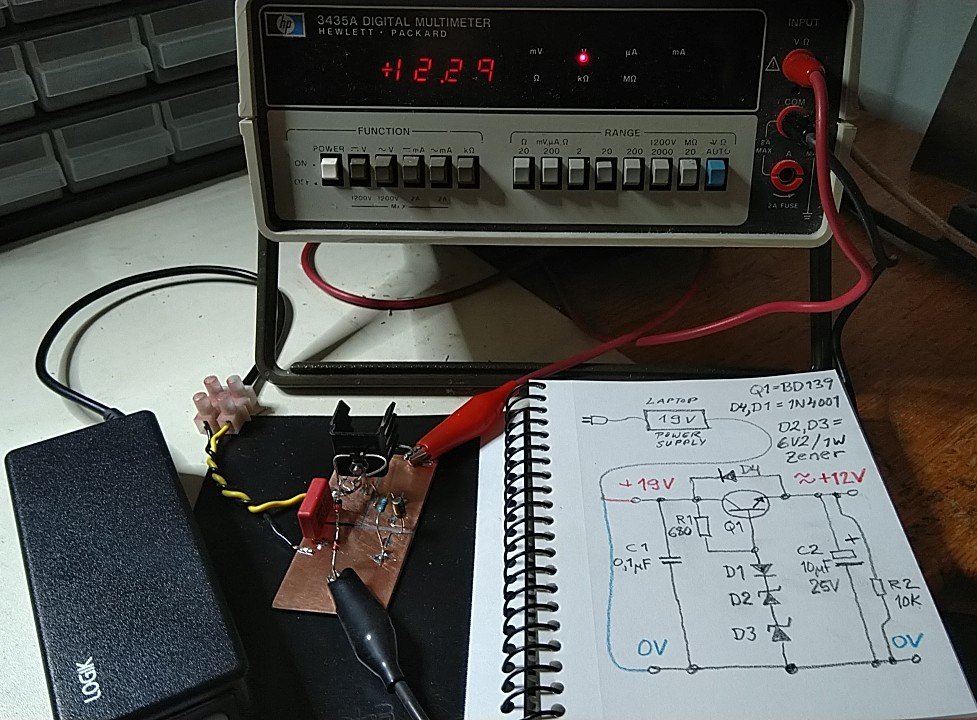

Added D4 and R2 to discharge C2 if tested without amp. Reg gives around 12.1V when amp is connected. Q1 needs heatsink, same one like used before.
Regulator with feedback have much better measuring result, but this one is good enough and still simple.
