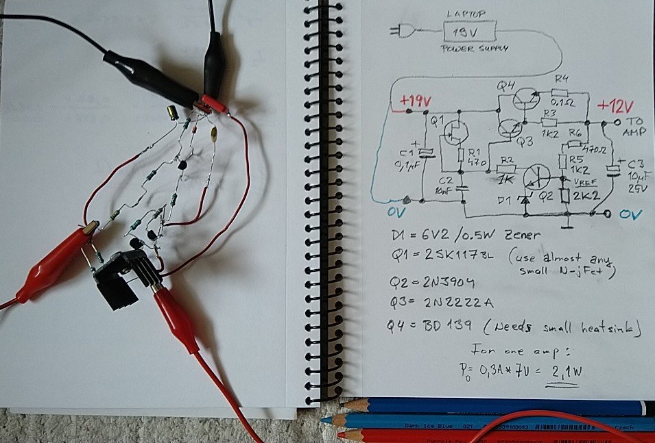

Here is first try for power supply, uses mostly same parts like amp and some generic 19V laptop power supply.
6V2 in series with Q2's Vbe voltage gives stable Vref. R6 can be used to adjust output voltage. Nothing special. GE Transistor manual's from 60's have similar, but no N_jfet's in this book.

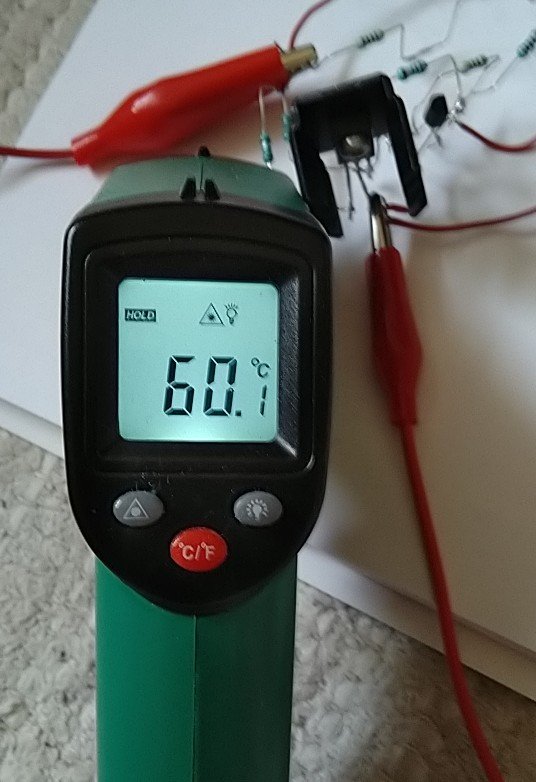

Heatsink is quite hot after 12 hours power on. Transistor Q4 case is around 30 degrees Celsius which is not too much.
This powers up only one amp. Second amp needs second reg or much bigger heatsink. Better to use one reg for one amp.
One correction for message #134. Can't modify it no more.
C1 / 0.1µF is non-polarized polyester or polyprop plastic capacitor.
That circuit is well enough.
The amplifier is not the final highend and can have a simple regulator
