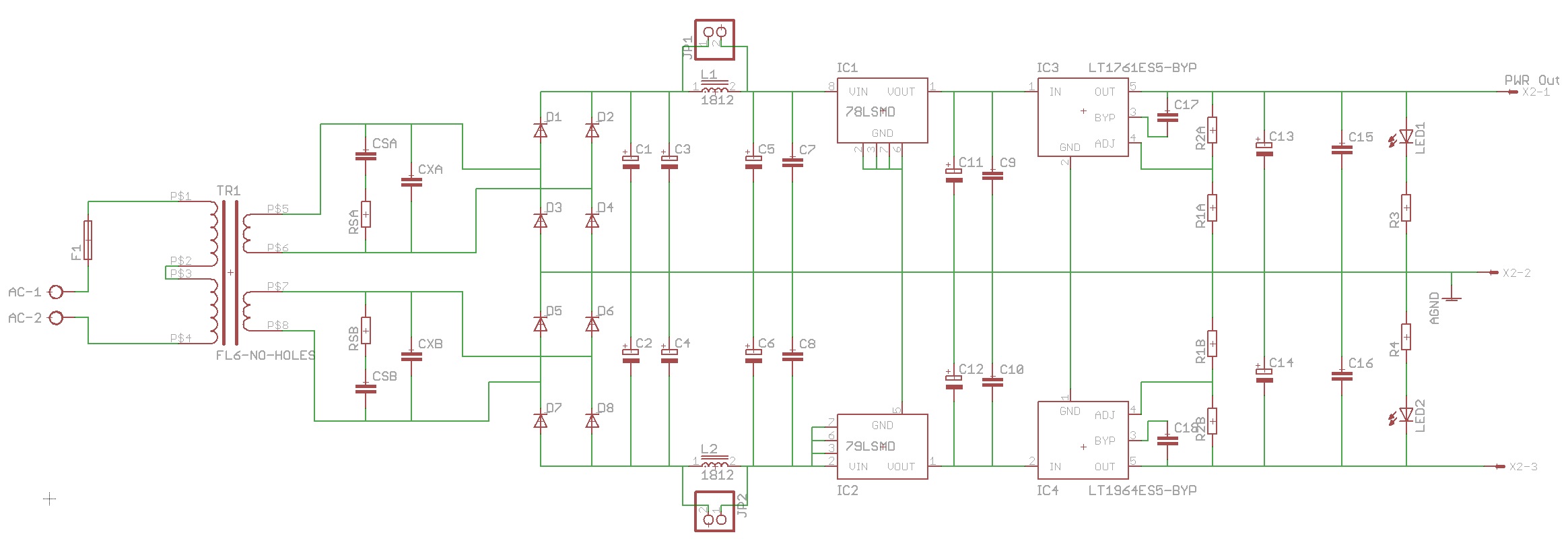

A simple but low noise LT1761/LT1964 PSU design

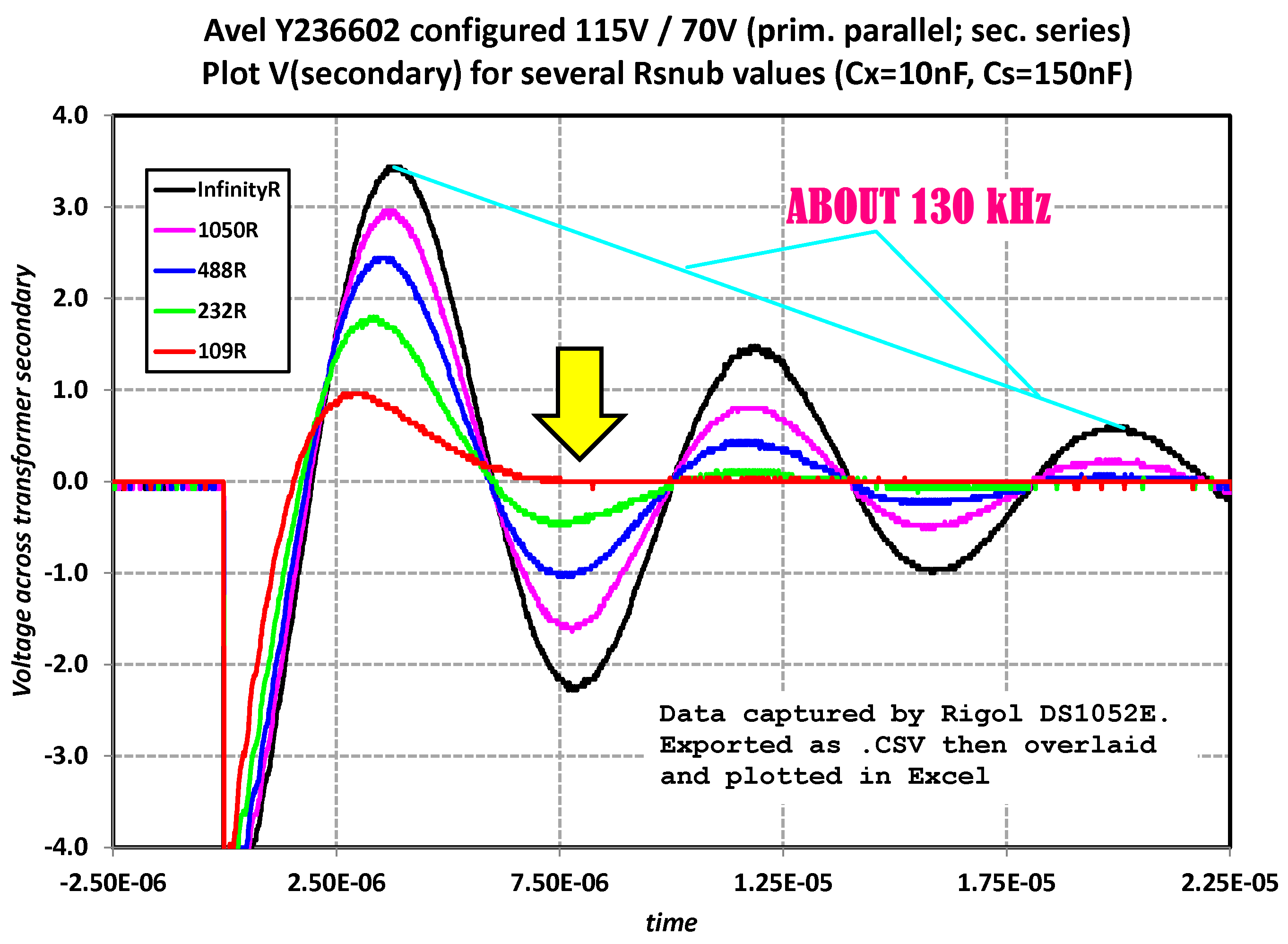

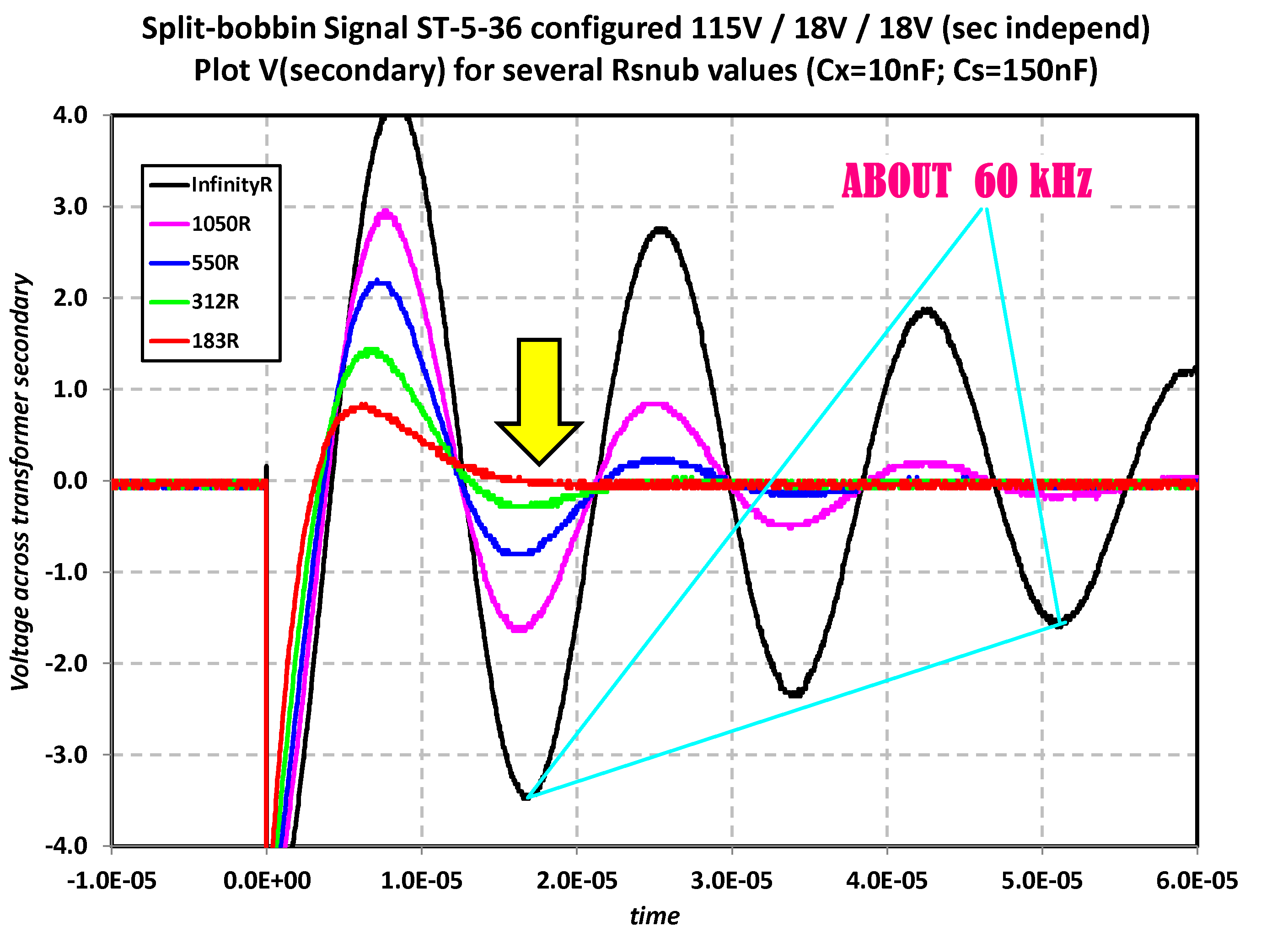

The great thing about "bell ringer" jigs with in-situ snubbers is, that you can directly observe how well or how poorly this specific individual snubbber actually works. You can install capacitor #1, turn on the bellringer, and dial the Rsnub to find the least objectionable waveform. If you're happy, boom. Done.
If you're not happy, if the least objectionable waveform is still objectionable, then remove capacitor #1 and install capacitor #2 in its place. Turn on the bellringer and dial the Rsnub to find the least objectionable waveform with this new capacitor. Happy? If so, have a pint. If not, proceed on to capacitor #3, and so forth.
I copied some scope traces from the Quasimodo design note, to show a range of possible omega_n values at which your snubbers might have to operate. (Of course, your transformer and your snubber might have an omega_n above the highest shown here, or below the lowest shown here. These scope traces are mere anecdotes. Individual data points. Nothing more. Your mileage may vary.)
You could do some research to find out which type(s) of surface mount capacitors the RF crowd uses, at these kinds of frequencies. Or the high speed data acquisition crowd. Or, at the intersection of the two disciplines, the software defined radio crowd.
Or else you could just be an empiricist. Install the cap, turn on the bellringer, twirl the potentiometer, look at the scope trace, and ask yourself: is this good enough, in my opinion?

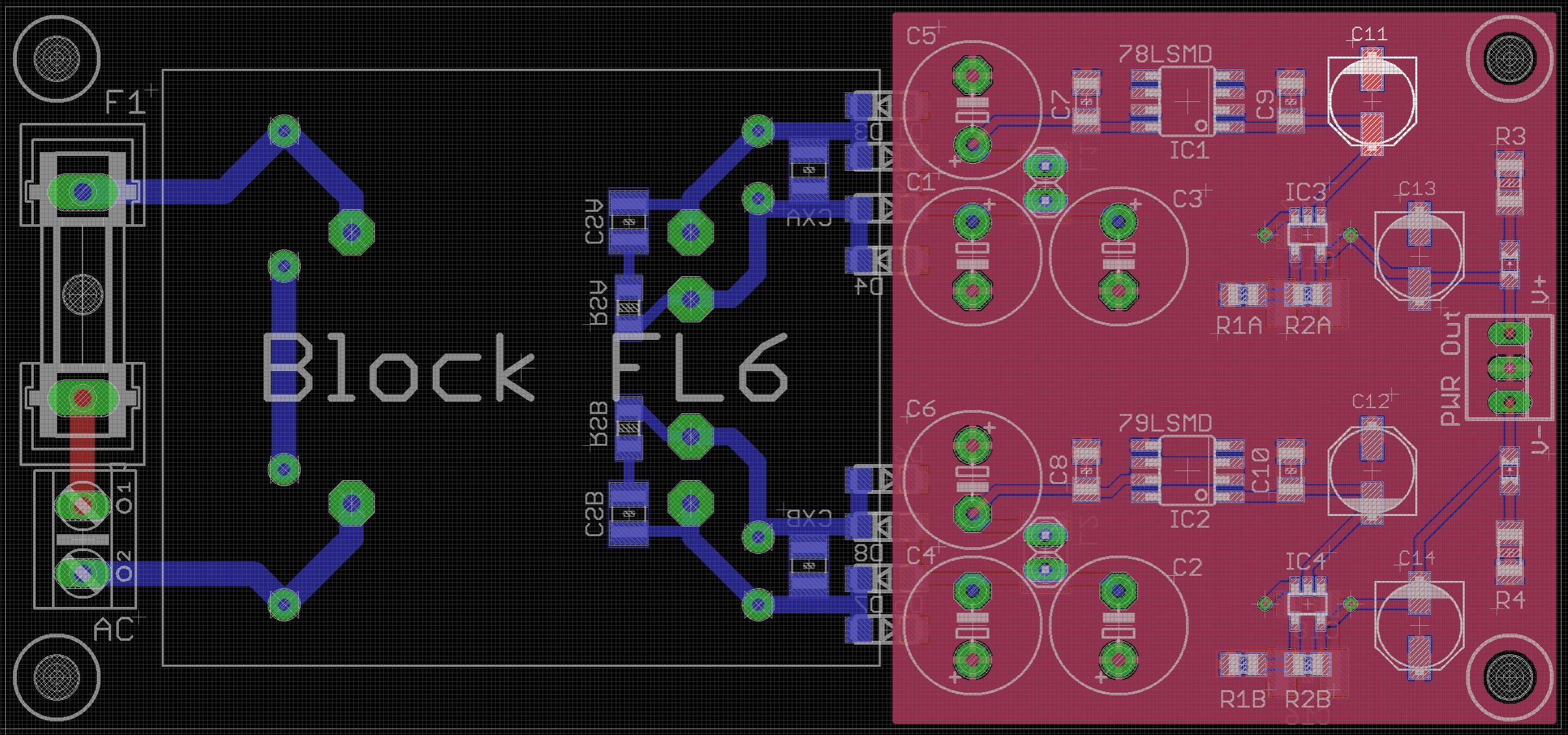

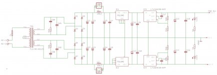

OK, here is version 0.3:
- Added optional snubber components.
- Added optional jumpers to bypass the inductors.
- Changed C11-14 to D size Panasonic caps so could be 22-47uF.
- Made PCB wider to increase distance around mains traces.
L1/2 = Panasonic INDUCTOR, 1812 CASE, 47.0UH
C1-6 = Panasonic FC series 35V, 470UF
C7-10 = Kemet CAPACITOR, 1206, 220NF, 50V, X7R
C11-14 = Panasonic FP series CAPACITOR, D CASE, 47uF, 25V
C15/16 = Wima Polyester 1812, 0.1UF, 63V
C17/18 = Reg BYP caps, TDK, 1206, C0G, 100V, 10NF
R1A/B = Panasonic 240R, 0805, 0.1%, 0.125W
R2A/B = Panasonic 2K4, 0805, 0.1%, 0.125W
Cs = 1210 package
Cx = 1210 package
Rs = 1206 package

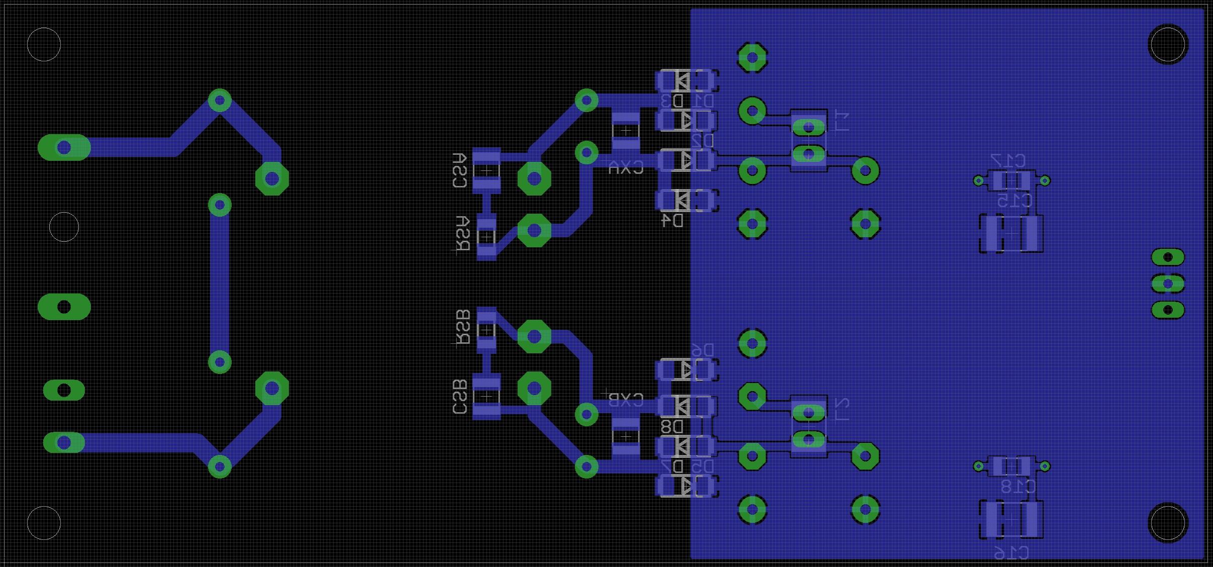

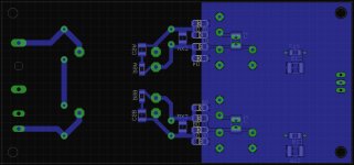

Questions!
Is it OK to put the snubber components directly under the transformer?
Should I ground one corner so it can be easily connected to the chassis?
In your layout, you need to keep the AC pairs RIGHT next to each other, everywhere possible. Otherwise, you are making hum-transmitting antennas. So you need to determine the minimum-allowable gap between traces carrying various levels of AC voltage or current and make the gaps not much larger than that, everywhere possible. That should include the incoming AC mains, the secondaries, and everything up to the reservoir caps. And, since the current will in general be dynamic (time-varying) in the DC pairs, those should also have the minimum-allowable gap between them, everywhere (a ground plane or two makes that very easy to implement).
It looks like the LT1761 is not a good choice for a power supply rated for 100 mA, since that is the 1761's rated upper limit (and it sounds like maybe that's only for up to 10 Volts output). The other one you chose, the LT1964, is rated at 200 mA.
You could look at others, such as the LT1962 (300 mA, 30 uV noise).
It would be nice if Linear had matching positive and negative ones. I guess you could match the LT3090 negative regulator (600 mA, 18 uV noise) with one of their positive low-noise 500 mA ones, if the low noise spec is important to you.
OK I can bring them closer but only marginally. Bear in mind that the transformer on the PCB is only 50mm square so the distances we are talking about here are a couple mm. I can't see how I can bring the AC pairs closer together without doing something silly like having the fuse horizontal.
I already have a ground plane on each side so I can't really get it any better?
I don't get this. Why? Where do you get 10V from?

Believe me, I've looked! The LT1962 only comes in 8-Lead MSOP Package. Do-able but not the easiest IC to solder!

It's from simulation. It looks reasonable but I'm never sure of anything. It basically always gives about double the ripple, if you want them to respond at about the same speed.
I'm not even sure how important that is, since it will be down in the below-20mV range, anyway.
I just finally got the sim circuit working well last night, so I haven't done a lot with it yet. I finally had to replace the 7915 model with a Linear part, just to get it running well-enough, because I couldn't find a decent spice model for the 7915. But the same types of mismatch differences were evident even without the 79xx regs in the circuit. I'll upload the circuit model and some plots, tonight if possible, so you can see what I mean.
The LT1962, on the other hand, looked great, when I finally substituted it.

I was just trying to say that the larger positive rail ripple was apparently not because the 1761 was being pushed too hard. It's that way for all of the ones I've tried, including the LT1761-BYP, the LT1962, and even the LT3032.
And yes, the ripple is quite low level. So it might not matter at all to you. I was just curious about the asymmetry.
