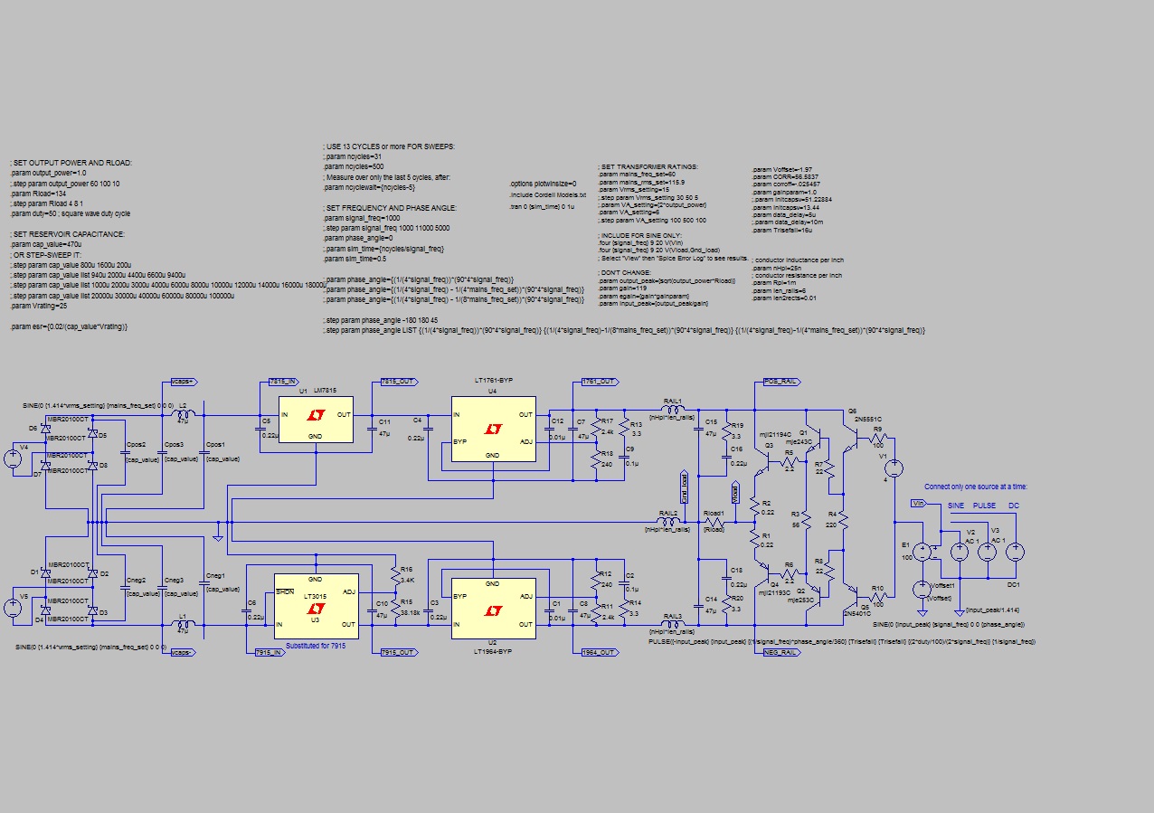

A simple but low noise LT1761/LT1964 PSU design
Attached is a zip file with two LT-Spice circuits and the necessary files for them. One uses LT1964 and LT1962. The other uses LT1964 and LT1761.
  • maxw_diyaudio_PSU.zip

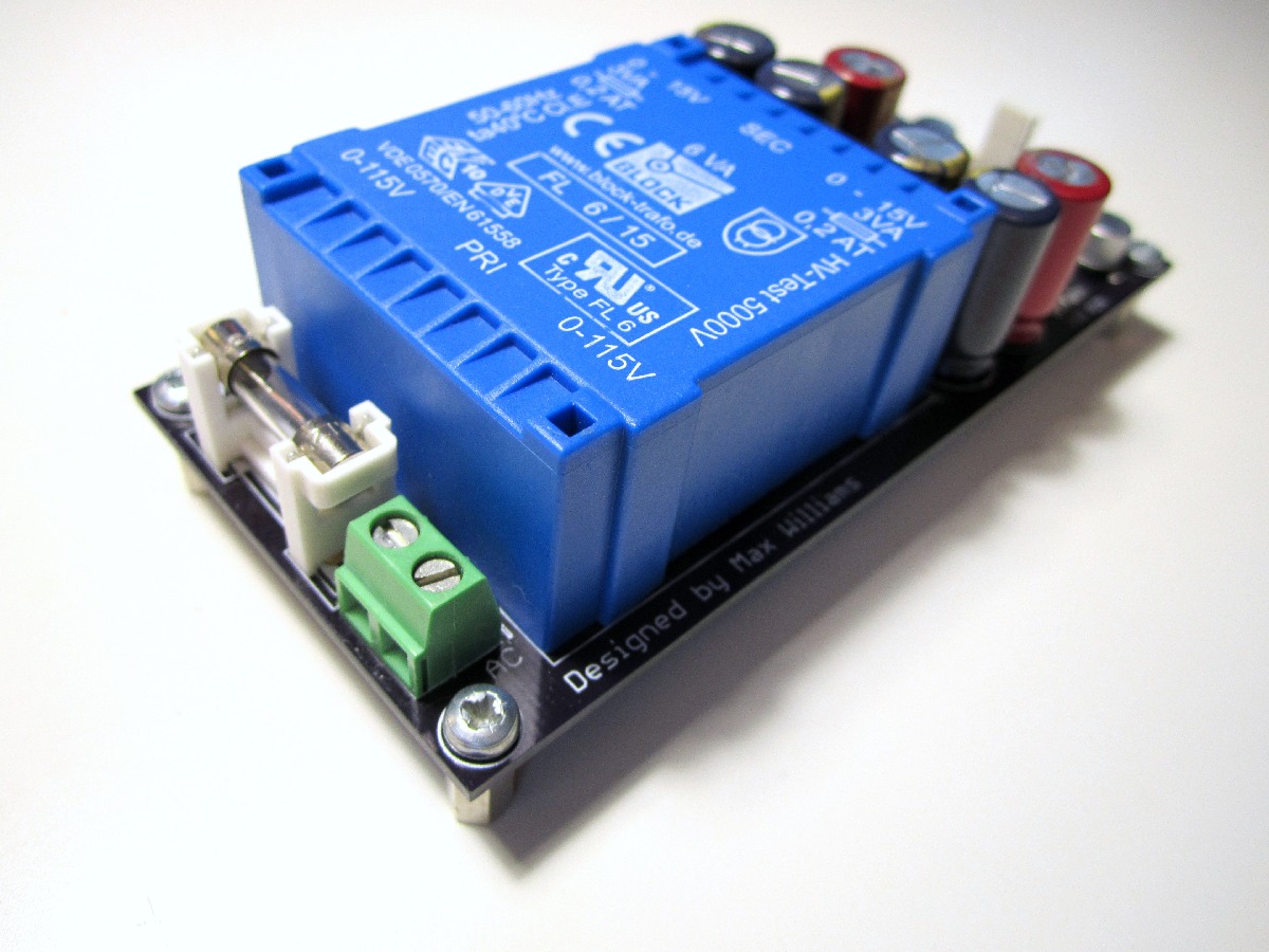

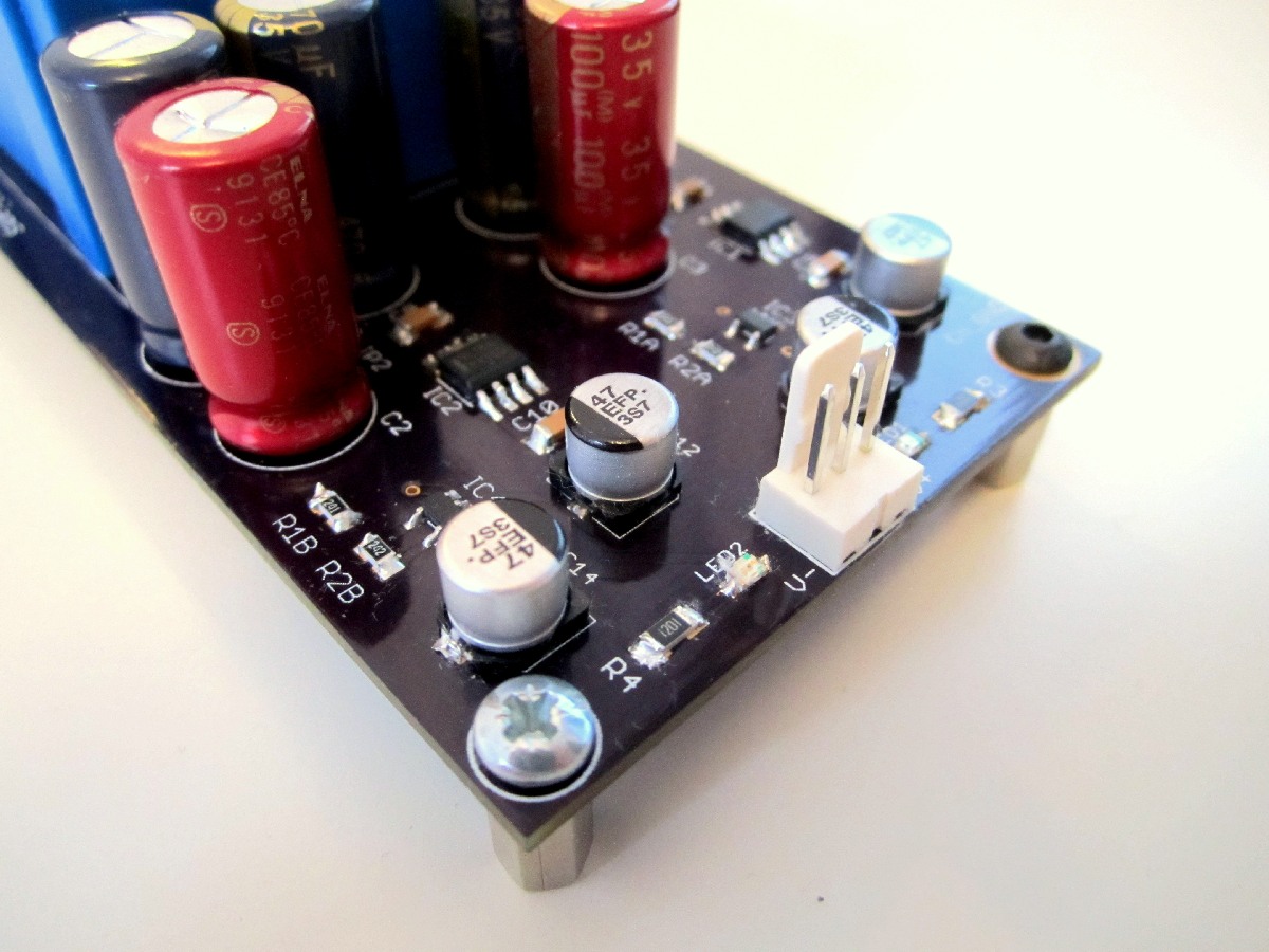

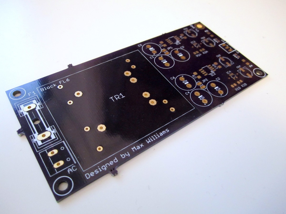

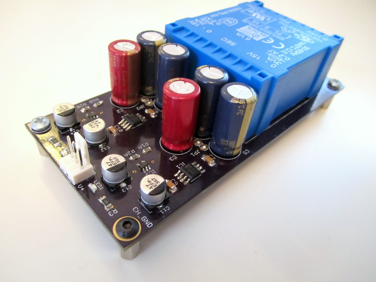

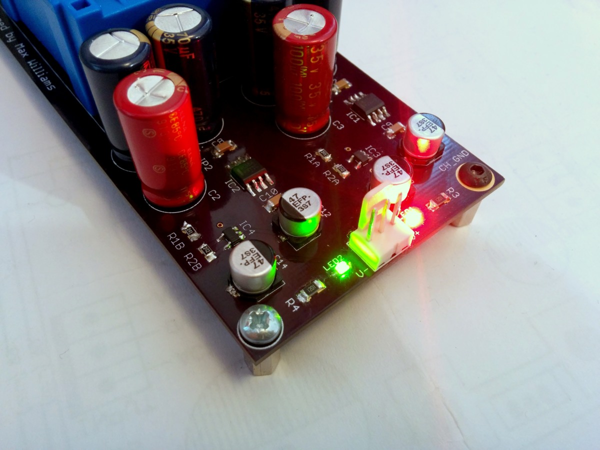

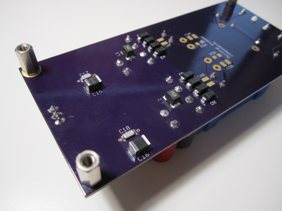

And built! Works perfectly.
I used R1 of 240R and R2 of 2400R to give +/- 13.4V. It's about 35mm tall with standoffs so will fit in a 1U enclosure nicely.
I have 2 spare PCBs if anyone is interested.

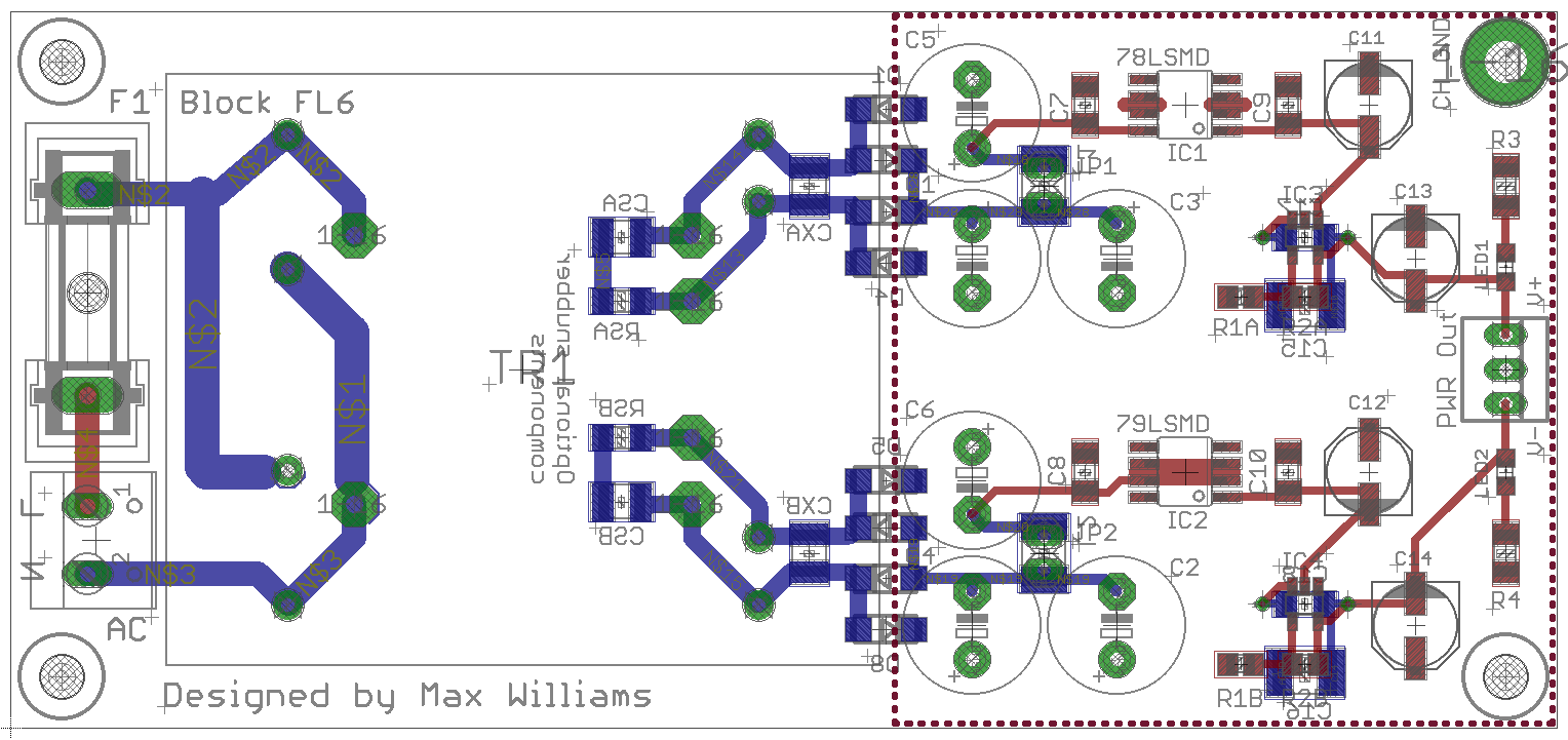

Please look over my Eagle Conversion to 120Volts
Attached is my first trail to convert of your 240-Volt Dual Power Supply Eagle files to 120-Volt Dual Power Supply Eagle files. I know NOTHING about Eagle.:mad: This is the first time I have try using Eagle, so please forgive me for ant mistakes.;) Let me know what you think of my attempt to make the necessary changes.
  • Dual Power Supply for 120VAC.zip
Hi mrsavage,
Yeah it looks OK, it will work. Note that N$2 trace doesn't fully connect to the top middle/bottom pad of the transformer.
But if I was you, I would modify my TPS7A3301 PSU instead of the one in this thread.
