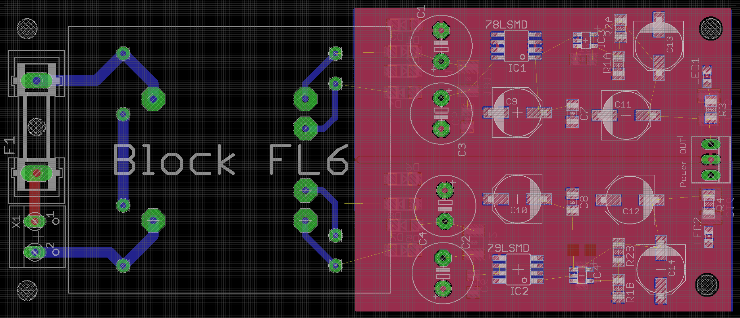

Ha I see, not only height is an item. I thought of weight but the 6 VA part is even lighter (to my surprise). Still I would like to suggest to use more pads for other standard transformers like EI38 types. You won't be limited to the Block type and it will make the PCB more versatile. We did it like that, see post #1:

Thanks Jean-paul, after doing a bit of reading I've added inductors to the design.
I have now:
- Added inductors for CLC Filter
- Added holes for EI38 trafo
- Changed Regs to LT1761ES5-BYP and LT1964ES5-BYP
- Added BYP caps to regs
- Replaced trim pot with fixed resistors

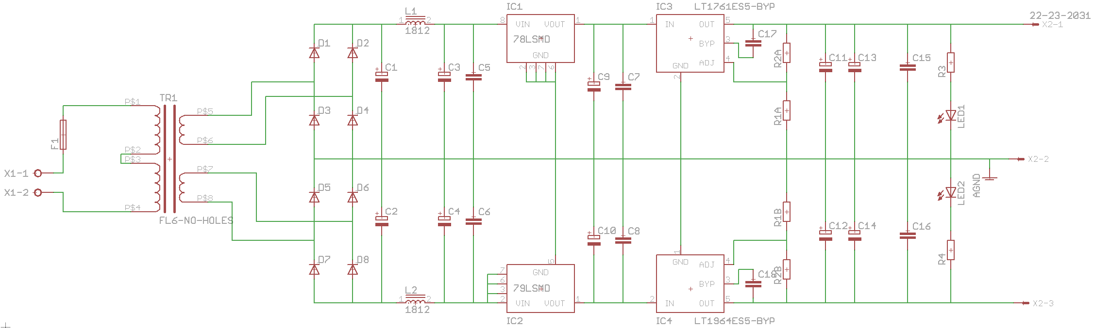

New schematic and unfinished layout are attached. Should output +/- 13.42V DC.
L1/2 = Panasonic INDUCTOR, 1812 CASE, 47.0UH
C1-4 = Panasonic FC series 35V, 470UF
C5-8 = Kemet CAPACITOR, 1206, 220NF, 50V, X7R
C17/18 = Reg BYP caps, TDK, 1206, C0G, 100V, 10NF
C9-14 = Panasonic FP series CAPACITOR, F CASE, 330UF, 25V
C15/16 = Wima Polyester 1812, 0.1UF, 63V
R1A/B = Panasonic 240R, 0805, 0.1%, 0.125W
R2A/B = Panasonic 2K4, 0805, 0.1%, 0.125W
I kinda think you will be (unpleasantly) surprised when you simulate your revised design in the frequency domain . . . . SPICE ".AC" analysis.
I kinda think SPICE will tell you that you have got a seriously underdamped resonant circuit. In addition to an unsnubbed "but I don't know what to do so I will do nothing" transformer.
Hi I think this PSU PCB looks very good and it is well decoupled. If you will be having PCBs produced I would like to try one if possible. I have some doubt about the distance between the 230 V connector PCB pads and the mounting stud... You could use FR5 solderable fuses to avoid that. I prefer 5 x 20 fuses too but: safety first. Maybe you can move fuse holder F1 just 1 mm to the upper side and it will be fine.
* I would use smaller values for C9-C14. IMO 10 µF is better*
I kinda think that people that kinda think Spice will prove this circuit to underperform better kinda do the Spice stuff before commenting.
Two caps 330 µF in parallel at the output is too much. Make that a single 10 to 100 µF cap. You are also using a bypass cap so why use 2 x electrolytic caps in parallel at the output ? You need capacitance at the spot where 100/120 Hz has to be buffered. So at the input.
Idea : you could use 2 x 330 µF in parallel after the rectifiers, then the coil followed by again a 330 µF cap ( for instance C9 and C10 that are now connected to the output of the 78/79Lxx). Use a 10 µF after the 78/79Lxx/before the LT regs.
Why? Just because I'm not using a snubber? Did you test it?
Perhaps. I know it will fit but perhaps the distance needs to greater. I might make the PCB wider to accommodate some more space.
Why? Can you have too much??
Why not though? I know it might be overkill but the caps come in lots of 10 or 20 etc so I will have some spare.
Could do. From a technical point of view, as opposed to cost and PCB space, can you have too much uF?
Hi, too much µF after conventional regs will make them oscillate as the ESR will become too low for the reg to function properly. Google for the exact technical explanation. Check datasheet of 78Lxx for max. capacitance after the reg. Recent LDO's are more tolerant but why would you use much µF ? They don't need to filter 100 Hz at their outputs (rectified 50 Hz AC will be 100 Hz pulsating DC). The input caps buffer the ripple of the pulsating DC voltage. At that spot you want good filtering of ripple and other stuff you need to get rid of.
Rule of thumb (can be calculated) is about 2000 µF per Ampere load current for 1 V ripple. Old info that was learnt many years ago. I am not the only one using the rule of thumb. It is way easier to keep in the head than the actual calculation 😉
http://lenardaudio.com/education/12_amps_7.html
I would use around 1000 µF in total for 100 mA load but 2200 µF is standard value and can be used too with the drawback that those will be higher than 3 x 330 µf. Ripple will be very low and total voltage will be way above the minimum required voltage for correct working of the 78/79Lxx. Much larger value won't bring benefits. The coils will filter RF/HF and the regs don't need to do much work except for being preregs for the LT's.
Not wanting to overcomplicate, but I've gotten very interested in methods of calculating PSU and decoupling cap values, lately (for the last year or so). What type of load will this PSU be powering? Do you have any specs for the load? Are there any dynamic requirements for the output voltage and current?
i.e. If it will be an active load, what is the minimum voltage between the power rail and the output (the active device's "vclip" voltage, e.g. a few volts, for a transistor output stage), and what is the desired maximum signal voltage swing at the output of the load, and what impedance is the active load driving? Those might enable calculating the maximum ripple voltage at the onset of clipping, or load device "dropout", which would be caused by the load current drawing down the output caps' voltage. Is there a "maximum tolerable ripple" spec at the load output? Actually, with the regulator(s) there, I would probably have to just simulate the circuit as a whole. But that would be interesting, too. (Worst case would be to simulate with constant DC current that's equal to peak of output current swing, with long-period square waves.)
