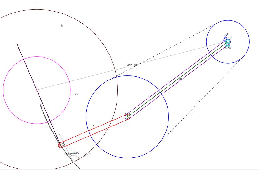

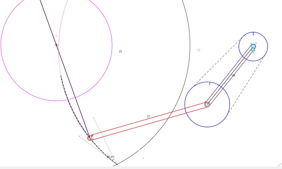

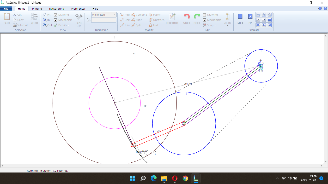

I think you are not far from the solution, on the contrary. My simulations show that with variants of your Rabbit high precision can be achieved beside low skating forces. Just two bearings - it can't be simpler .

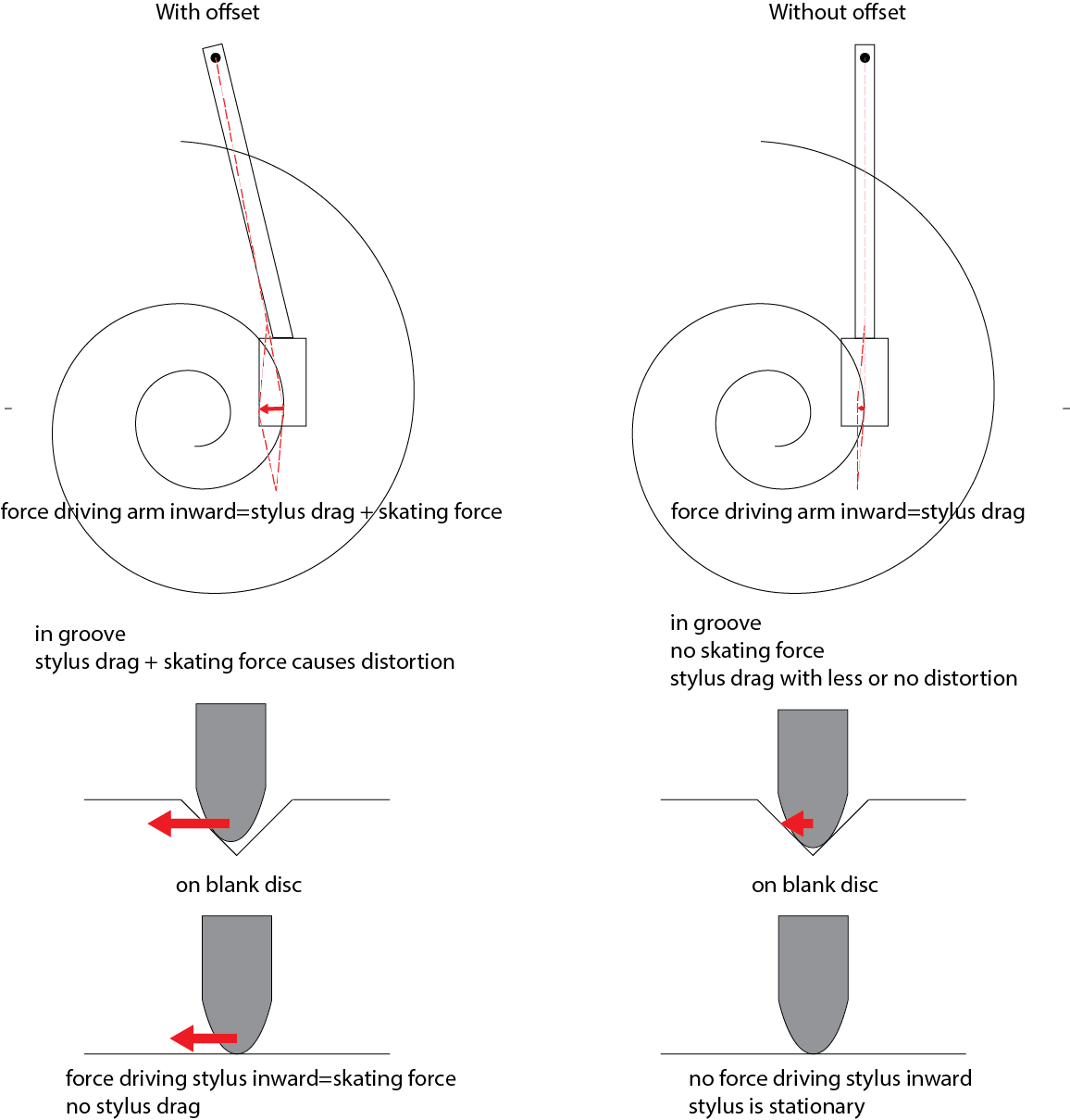

carlo,
Please see the diagram. I think the diagram itself is sufficient to express my view.
Yes. Linear arm usually has a higher deflection of cantilever due to high friction of linear bearing and high lateral mass. If the friction is almost zero as the pivot arm, and optimal lateral mass, the deflection can be less or similar.
It is different for a stylus in the groove and on a blank disc. However, if the stylus is in the groove, we can't detect visually whether or not there is a skating force. Although there are differences for a stylus in the groove from the stylus on a blank disc, it doesn't affect the conclusion of the blank disc test. We can visually detect if tonearm skates or not.
Jim

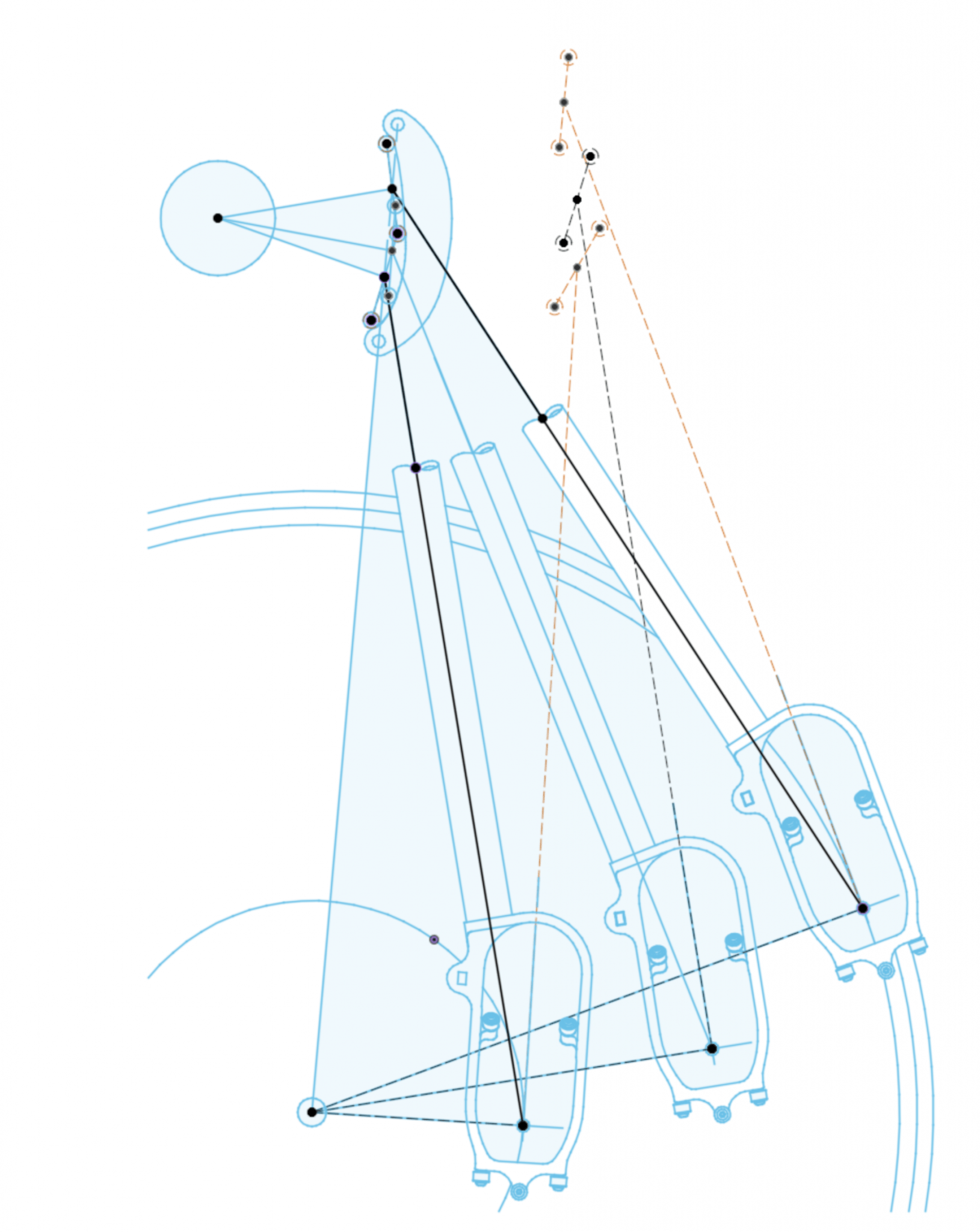

Hi Jim,
Here is the drawing I promised to explain the origin of the inward force.
Sincerely,
Ralf

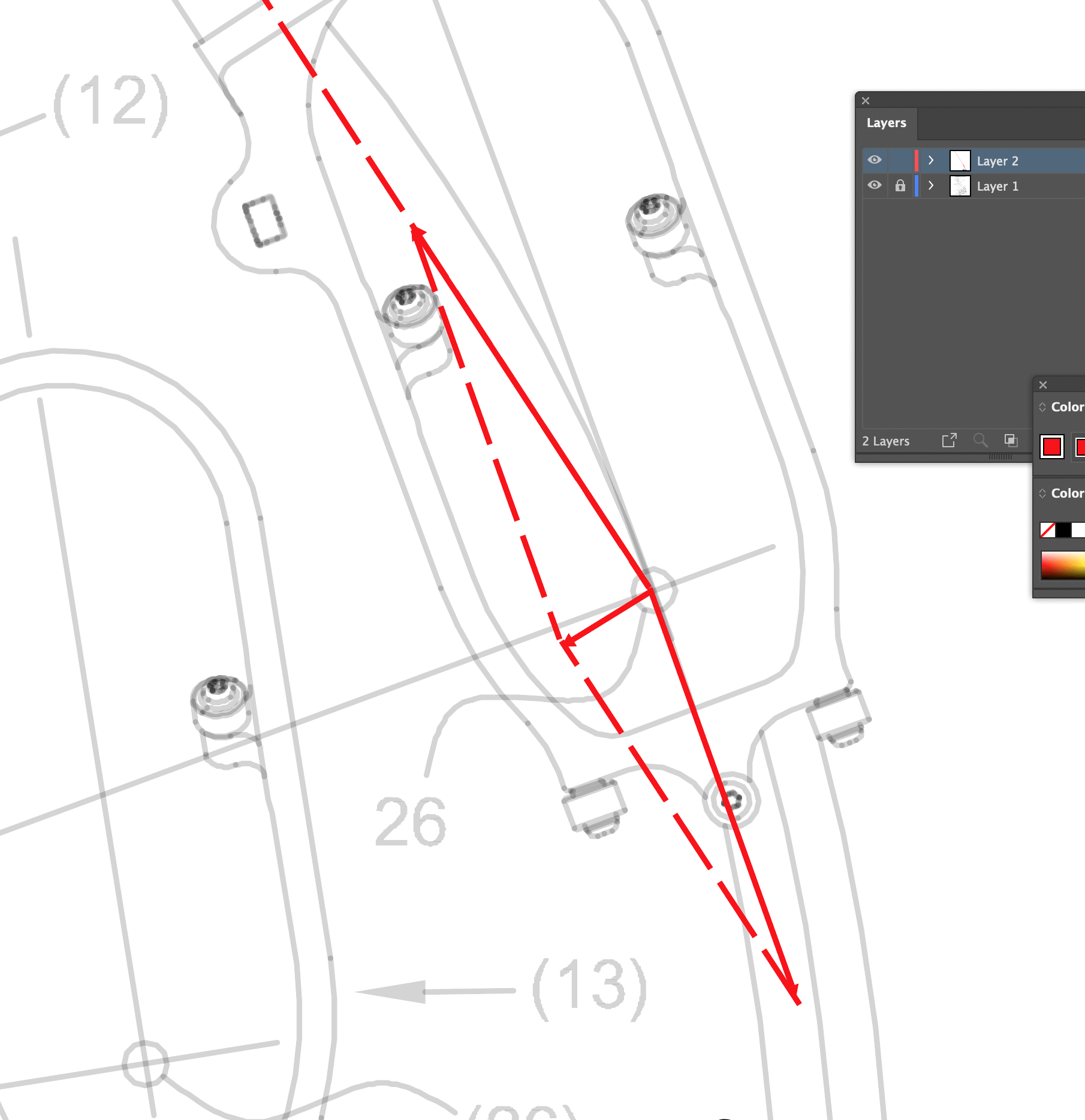

Ralf,
I don't question the offset angle will generate an inward force, but I question if it is necessary to add such an additional force.
I used Fushion 360 to redo the geometry of your arm and realized that an offset angle can make the cam simpler. Is that the true reason to add an offset angle? However, it may still be possible to make a simple cam without an offset angle. Otherwise, I really don't see the reason to add inward force since the groove will drive the arm inward. The dot lines are the geometry I did.
Jim
Ralf,
Jim
Hi Jim,
1) The pivot of any pivoting tangentially tracking tone arm must move from point A to point B.
2) I have shown that the distance between points A and B is ~50% shorter when the head-shell is offset.
2) A secondary benefit of the offset head-shell is the fact that it drives the tone arm across the LP and all I have to do to prevent the head-shell from colliding with the tone arm, is to provide antiskating.
3) All tone arms with fixed head-shells bend the cantilever because antiskating cannot be set precisely.
4) By separating the Head-shell from the tone arm, it tracks the LP with zero tracking error and without bending the cantilever.
5) My tone arm continues to functions flawlessly and has been listened to and approved by audiophiles.
6) Finally, the Examiner at the US Patent Office who is an Engineer, approved my invention without reservation.
Sincerely,
Ralf

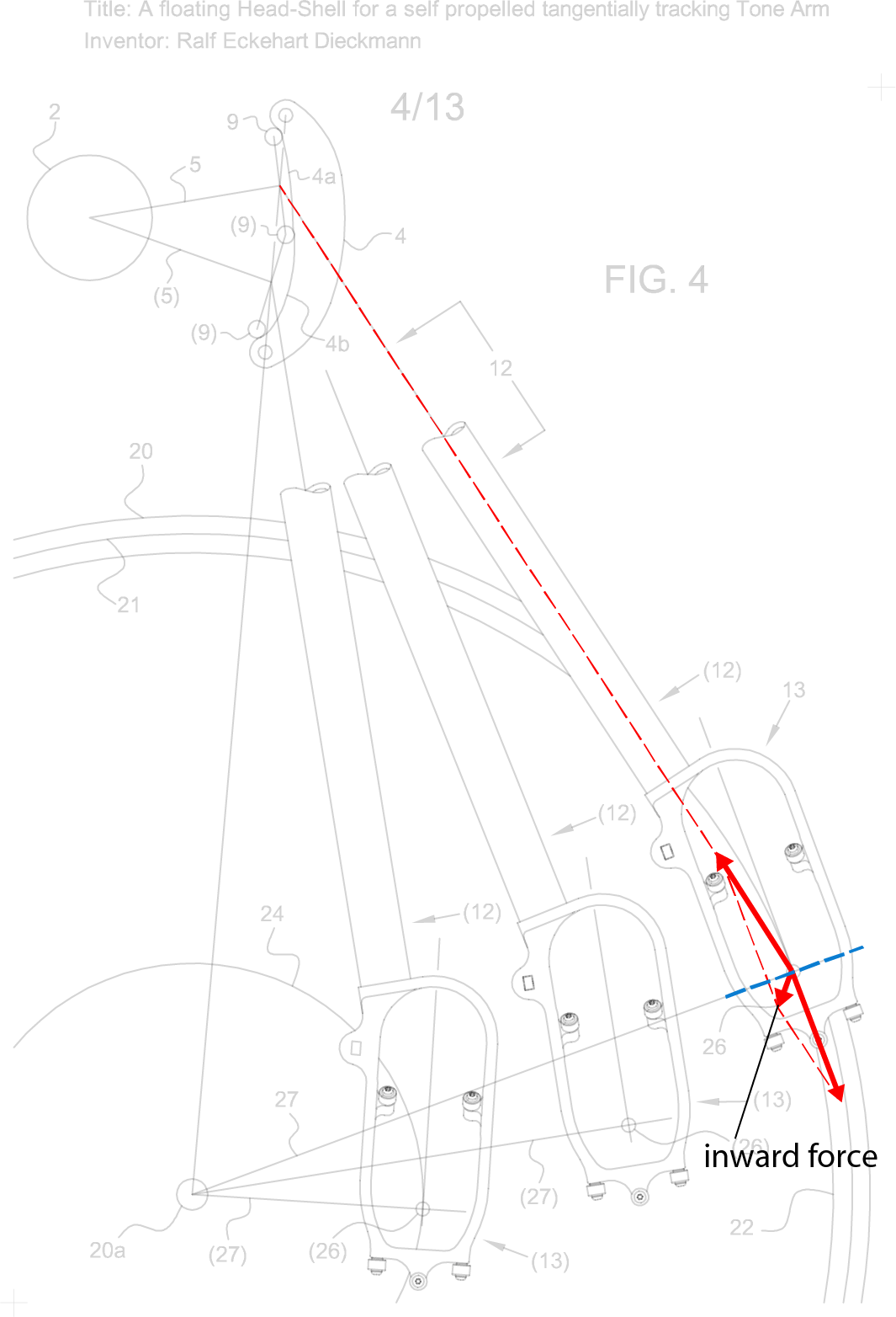

The length is not critical, but efficiency is. I have tried. If the head-shell is not offset, the cam in the rear may be getting complicated. Even with the offset, the cam is not perfect. Please see the following diagram. There is a small bump on the curve. It may cause the stylus jumps. However, I don't think it is important since the stylus is at the end of the groove when the bump happens.
As I said many times, the only source of the driving force is the friction between the cantilever and the groove. Let's do an experiment. Take your moving head-shell off. Does your arm move? Of course not. The offset angle itself doesn't generate inward force. In other words, taking the head-shell off means the head-shell is completely independent of the arm. If the head-shell is completely independent of the arm, the arm will NOT move at all. All cantilevers on different arms will be bent in different levels based on how efficient the bearing is or the bearings are. So, how efficient the bearings are on your arm? I have doubts but don't know for sure.
Here is a diagram to show the direction of the inward force. The inward force is not parallel to the moving head-shell (blue line) and will pull the arm inward. Why do you need a moving head-shell since the moving head-shell can't be completely independent of the arm? Bending cantilever is inevitable for all tonearms even you add a moving head-shell. The question is how much.
It would be nice if you can run the arm on an eccentric record and record the movements of the cantilever so we can see how efficient the bearings are for your arm.
Jim
