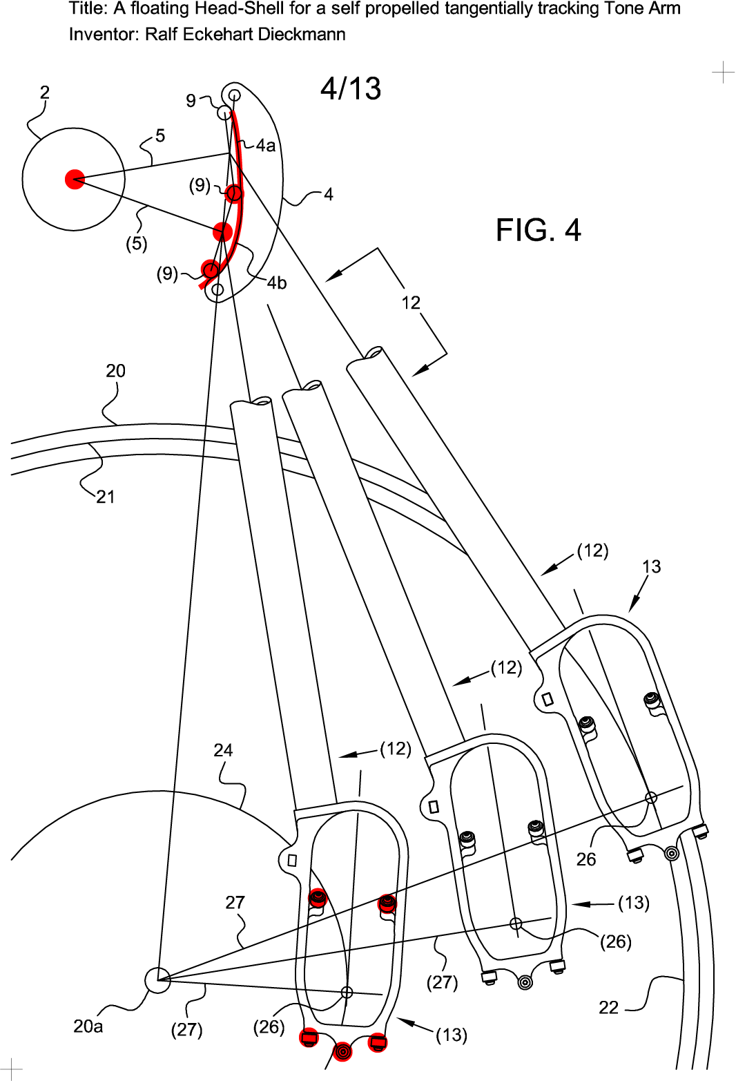

Sheet A: When I designed my first pivoting tangentially tracking tone arm, I realized that its pivot had to be movable. The shortest possible distance is achieved when the two locations of the pivot lie on a straight line which runs through the center of the turn table. At the time I knew nothing of the Thales principle. The length of the track upon which the tone arm pivot travels, is 1.6056” with an effective tone arm length of 7.950”
I stopped working on the project for many years because CDs came on the market.
Sheet B: In 2017 I discovered that I can reduce the length of the track to .8412”, which is a reduction of almost 50%! if I offset the head-shell by ~15.17°. However, that introduced the dreaded “inward force”.
Sheet C: Also in 2017 I discovered that, if I arranged the head-shell to be floating, the inward force no longer affected the head-shell/cantilever/stylus assembly. In order for that idea to work, I developed variable electronic anti skating, GOVERNED by the instantaneous position of the floating head-shell with respect to the tone arm.
Figure 4: In order to make the tone arm a tangentially tracking one, the tone arms location has to be precisely controlled throughout its travel across the LP. I did that with cams 4a, 4b and cam followers 9 (2).
Figure 5: This drawing shows in detail how the cam and cam followers control the position of tone arm 12. tone arm 12 pivots where it meets with swing arm 5. The angular relationship between tone arm 12 and the cam followers 9 is fixed!
Figure 6: This drawing shows the approximate mid position of the tone arm and its cam followers.
Figure 7: This drawing shows the end position of the tone arm and its cam followers.
My original drawing that you reposted, does not show the cam and cam follower arrangement.
There was no way you could have known how that works.
The tone arm’s path is not circular but is a curve generated by the above described cam and cam followers.
The offset head-shell in my design absolutely is the cause of the inward force. If that was not so, the tone arm would not work.
In 2020 I applied for a Us Patent on the offset, floating head-shell and the fact that the offset causes the tone arm to be self propelled. The patent examiner agreed with my claims and allowed the Patent to be issued. That was late last year and the patent should issue some time this spring.

"The offset head-shell in my design absolutely is the cause of the inward force. If that was not so, the tone arm would not work."
Since the stylus assembly moves freely in the headshell, the headshell cannot be a source of inward force.
Your use of the term skating force is ambiguous. A servo driven arm is moved by the servo, so it cannot be pressed inwards by the skating force.
For me, it's not that complicated. If the headshell is 4" wide with a straight path in line with the radius that covers the playing area, we wouldn't have all these speculations. Then it would resemble a passive parallel tracker. All these terms like skating force or inward force are moot. But the headshell is only about an inch wide so the servo is simply there to extend this path, it is not correcting any angle. This could've been a completely passive linear tracker, except now we have to deal with a 4" wide headshell whose effective mass might be too high. The arm assembly is there to deal with vertical movement and tracking force. The quasi-pivot arm look makes for easier mounting and more aesthetically pleasing. This is not a Birch style arm and does not rely on the Thales principle, similar to the Schroder LT because the tail end does not move in an arc but a curve or cam. It's a servo arm with a base that moves on a cam and not based on linkages a la Birch. Although using a Birch geometry can make the base construction much simpler, if you are willing to accept a tiny bit of tracking error.
Ralf,The tone arm’s path is not circular but is a curve generated by the above described cam and cam followers.
If the arm's path is not circular, it is possible to reach zero tracking errors as long as the stylus is perpendicular to the center of the spindle. So, your arm is not a variant of Birch-style arms.
Offset is only structural property. It doesn't generate any force. The only source of the driving force is generated by the interaction of stylus and groove.

Ralf,
Thanks for all the diagrams! They help me to understand your arm better. However, there are many pivots and surface contacts. How efficient are these pivots and surface contacts is another concern. I marked all these areas in red.
Jim
Jim
Parts marked with 2, 5, 9, 4a, 4b are part of the servo mechanism, so their "efficiency" is not a problem.Ralf,
Jim
But they might be a problem if they generate noise that is coupled into the tonearm.Parts marked with 2, 5, 9, 4a, 4b are part of the servo mechanism, so their "efficiency" is not a problem.
If I understand it correctly, the servo for Ralf's arm is not a driving mechanism. The servo generates a force against the inward force so the linear rail is always in the correct position.Parts marked with 2, 5, 9, 4a, 4b are part of the servo mechanism, so their "efficiency" is not a problem.
I think that is incorrect. No lateral force is exerted on the cartridge by the tonearm or visa versa. The servo keeps the carrier for the "floating" headshell in the right position so that the cartridge can track tangentially. The tonearm is providing a 'race', 'track' or 'rail' perpendicular to the tangent so the headshell carrier can move towards or away from the spindle whilst remaining essentially perpendicular.The servo generates a force against the inward force so the linear rail is always in the correct position.

Hello alighiszem,"The offset head-shell in my design absolutely is the cause of the inward force. If that was not so, the tone arm would not work."
My tone arm is not 'servo driven". It is driven purely by the frictional force between the vinyl LP and the stylus. It is beyond me why anyone would tell me how my own tone arm works. Read my various posts!

What is the purpose of the servo amplifier in the patent?My tone arm is not 'servo driven".
"Hello alighiszem,

If we would perform the string test, the cradle would remain in place, but the headshell would move inwards. So the friction between the record and the stylus moves the headshell.
The servo just exerts a CCW torque (the variable antiskating Ralf wrote about) to avoid the collision of the cradle with the headshell.
