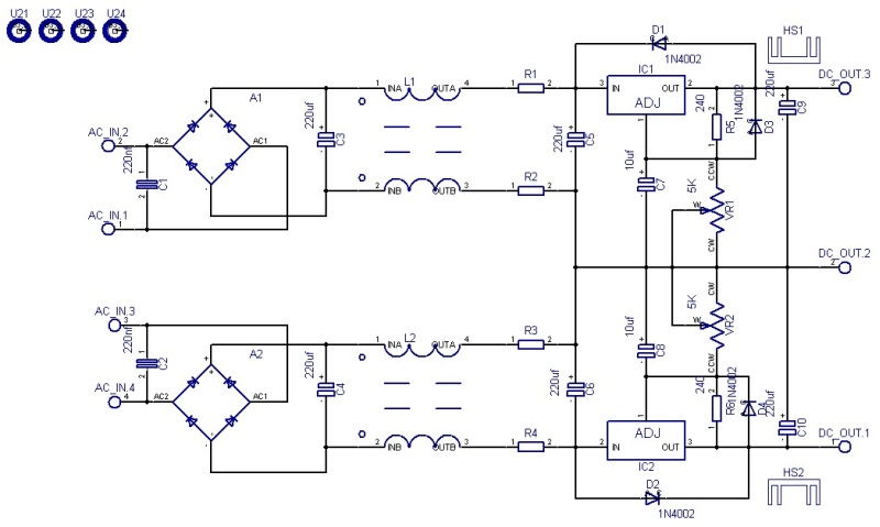

That last schematic looks very much like Russ Whites http://www.twistedpearaudio.com/lcbs/lcbs.aspx
Low Current Bipolar Power Supply (LCBPS) - A Regulated CLRC Supply
Except his has CLRC network on the input now. A very nice reasonable priced kit.

Algar _emi, your attached power supply schematic is a direct copy of MR. Paoletti reverse eng. circuit .Power supplies have improved in the meantime, and it is wiser to build some variant of hybrid regulators ( ic error amp+ discrete pass transistors) . They are wrongly called discrete but they are not. Borbely regulators are genuine discrete regs. If you use proposed circuit you should reduce values of output caps since they have low ESR (in combination) which is bad for rising inductance of lm317/337 regulators at higher frequencies. Diodes between input and output (D1 and D2) are desirable as they protect regs. from damage in the event of short circuit . But their capacitance links input to output at MHZ frequencies. The potential is an open door to RF interference.To solve problem, they should be replaced with lower capacitance types like 1N4148 with the aid of current limiting resistors( 22R MF) or left unpopulated .
