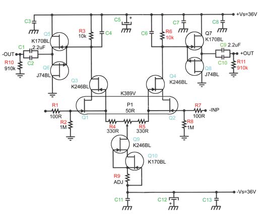

Maybe the Bordely FET Preamp schematic can give you some idea for the Vendetta FET substitution.
You can use 2SK170-J74 parts for input and second stage parts if you wish.

Assuming that the schematic posted herein is correct, or close to it, why do you use a current source to set the operating voltages for the output cascode? Given that you have flogged the DC rails to within an inch of their lives, a resistor would seem to give as stable an operating voltage and presumably be quieter. Is the output run hard enough that you're using Q17 to thermally stabilize the voltages across R26 & R33?

From my understanding of the datasheets, the 2SK240 and 2SJ75 can be replaced by the 2SK389 and 2SJ109 which still exist on earth (however the datasheets state a significantly higher current capability for the 2SK240, also higher dissipation...so one should check that).
Just a thought for the guys who probably want to build this amp.
Cheers, Hannes
EDIT: seems the 2SK140/2SJ75 can still be found somewhere, as are the other parts!

For small projects, Erno is still a good source for fets. They now cost even more in the open market in many cases. There isn't any clear way to save money or to substitute parts, UNLESS you are very lucky. Think of these devices as if they were discontinued tubes, and perhaps you can gain better perspective.

However it's not so easy. First, the schematic is thought to be correct, but it was never build (at least nobody here said otherwise), so there might still be mistakes. Thus you would want to own some equipment (signal generator+scope) to test it.
Further it uses hard to find parts which need to be matched as well (so you need lots of them). If you start substituting parts, it's not a real Vendetta anymore; however at least you need to know with which parts you can replace the originals.
Next the Vendetta copes exclusively with MCs, so people with MMs drop out of the equation.

On the other hand, you've got people like me who have multiple moving coil cartridges on hand. But I feel no compunctions whatsoever about changing devices around to suit my availability/needs/wants/desires/mood. You can do one helluva job using the 2SK389/2SJ109 and 2SK170/2SJ74 for the main gain parts. The MOSFETs are wide open--Toshiba/Hitachi/Fairchild/IRF/etc. I recently acquired some of the Toshiba MOSFETs (and John thinks people never listen to his suggestions...huh!) and have had very good results in another circuit I'm working on. I have a phono stage going as well--it will receive some attention in due time.
Don't obsess over the parts--work the topology with parts that you can get.
