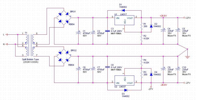

Vendetta phono preamp uses well known RIAA eq. topology: low noise gain block-passive HF eq.-active feedback bass boost second stage.Erno Borbely uses same approach in his designs.MM cartridge owners (I use both types) could build second stage ,and for input stage some of Borbely's old or new circuits. I am going to incorporate Vendetta power supply in my MC/MM phono stage which is combination of old Borbely's modules.Vendetta is built on double sided gold plated pcb but it is not so important. It is impossible to make perfect soldered joints on any gold plate surface ,even with special alloys.Next the Vendetta copes exclusively with MCs, so people with MMs drop out of the equation.

It would appear that it will be virtually impossible for anyone but Erno Borbely or me to build an accurate Vendetta preamp. I agree that MOST of the parts are not made anymore. Some can be substituted for directly, but others are almost impossible to duplicate. I don't know why, but jfets are becoming almost impossible to purchase at any price. However, IF you are willing to pay the price for the parts, then you can get very high performance. Many criticisms have been made of Erno's prices, but they are actually reasonable, considering that the parts are not available anywhere else.

2SK240/2SJ75 can easily be substituted with 2SK389/2SJ109, the latter may even be better due to being monolithic. The little data that I have suggest marginally lower noise for the SK240 but these are average values anyway and may depend on what production batch your specimen come from.
The 2SK147 and complementary are more tricky. Their equivalent noise resistance is ca. 34 Ohms compared to 55 Ohms for the 2SK170 (Borbely: All JFET MM/MC Preamp, part I), and the 2SK147 has somewhat higher transconductance at the same current. So you cannot directly substitute them and expect the same results. One obvious solution could be using 4 pairs of the 2SK170/SJ74 for the common source input stage and cascode them with 2 pairs of 2SK170/SJ74.
Purely from a noise perspective this should be just as good, but there could be other factors influencing the sound and that I am unaware off?
