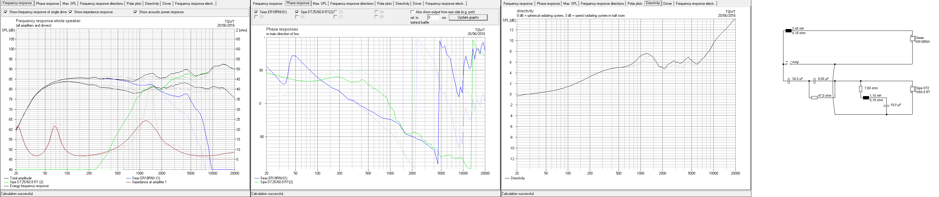

Excuse me Grasso789, I gave a try but there are some issues I can't explain, in response and in phase while directivity is about the same, you might have used different drivers. However my question is: does the off-axis improvement you said (deep and wide off-axis midrange gap) depend by filter order (1st) or by the change of the cross-point? As I understood from all these replies cross-point is the only factor which can affect the off-axis response..have I misunderstood?
Here's my simulation (dotted my previous version):

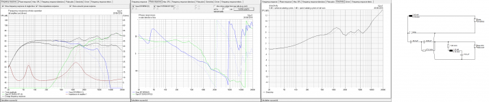

Are you trying to get a flat power response? This does not sound any good, and also gives a rising response on axis that will oblige you to listen off axis.
What i personnaly do is similar, but with a monotonically falling power response similar to usual room curves used for dsp room correction.
Btw, the values of the components a very unusual. All the xovers used for similar designs use similar circuits with similar values. There's a nice collection of them at Troels Gravesen website to tweak/hack from. Nothing new under the sun...😉

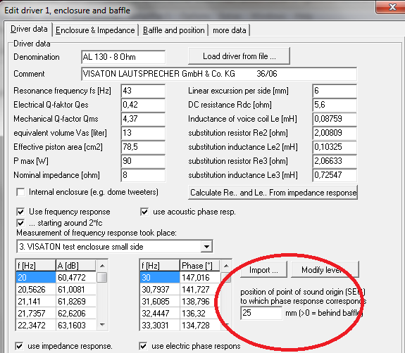

It is also critical to enter a realistic value for the woofer offset in order to get a realistic phase tracking too...

For the tweeter, add a series resistance and play around with values of the other components in order to give it a flat passband response and to reach my goals, which are * not too much level at and below fundamental resonance (else, it overloads) but * same phase for woofer and tweeter around and above crossover point. The woofer would profit from a resonance drain at 4500 Hz, of same topology as the one for the fundamental of the tweeter.Here's my simulation (dotted my previous version):
