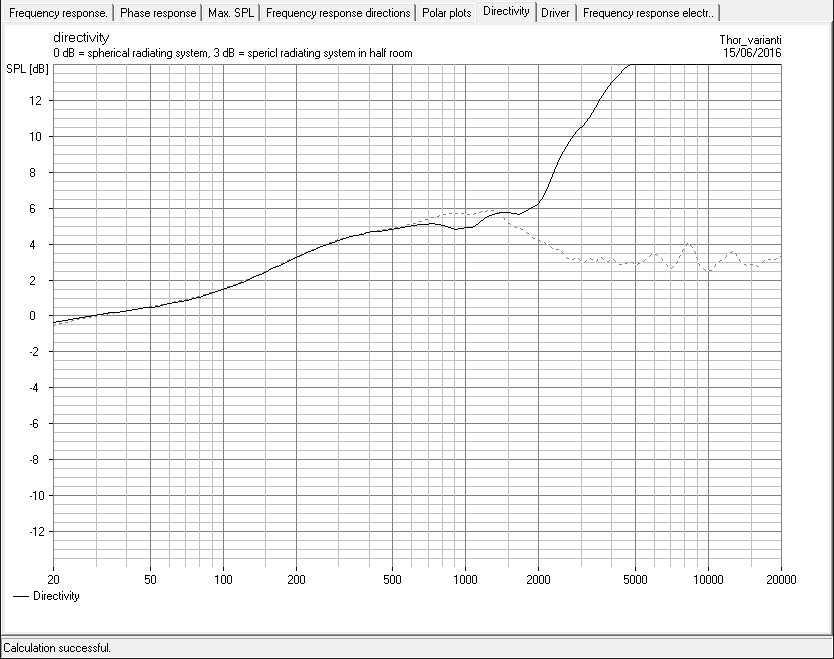

A question about directivity in Boxsim simulation

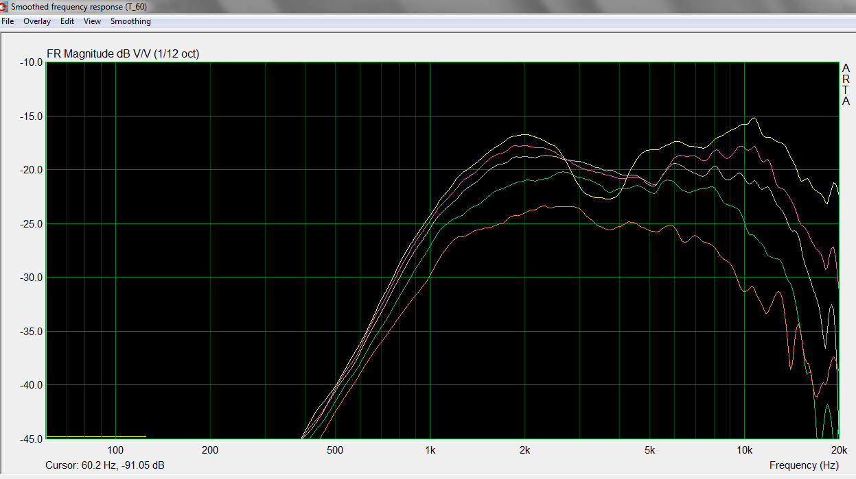

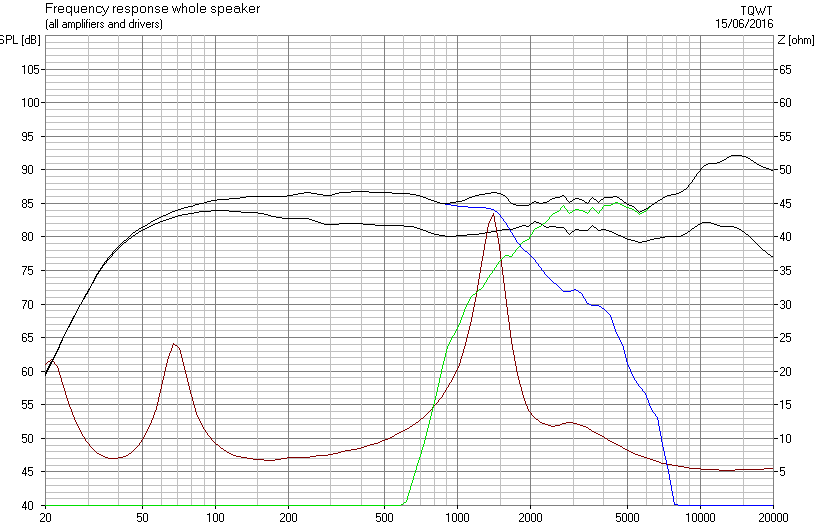

If you draw a curve through the three lines I put on the woofer response it will make a smooth curve with a crossover point around 2kHz. I haven't checked anything, it is the direction of the changes I was hinting at.
It doesn't matter much if you use a notch filter or not, whether you make three changes or one change that affects all three regions, if you get the same end curve the result should be about the same.

Now if we align the loudspeaker for flat on-axis response, output power has been reduced by beaming but rises again, when the tweeter sets in. This is what GDO dislikes.
I aim for this too, hence the crossover suggestions (first two) were based on the directivity index plot.
Of course the power response will be different whether looking at the individual drivers response, after considering their interactions (lobing), adding diffraction, adding room reflections etc. Some of these are based on shape, eg. rooms aren't round, lobing is sometimes inevitable, diffraction is physically displaced, and not all reflections are created equal.
An optimal crossover can involve deconstructing these, prioritising them and reconstructing. There isn't a program that does this automatically that I know of.

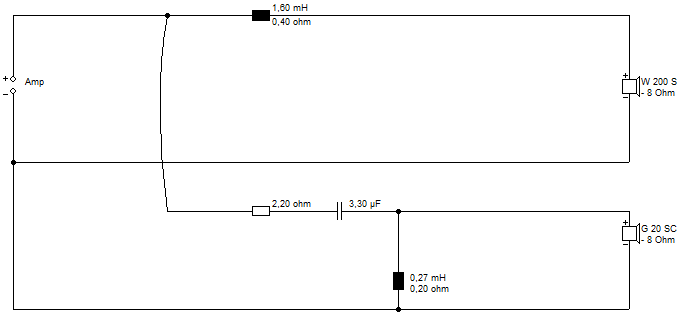

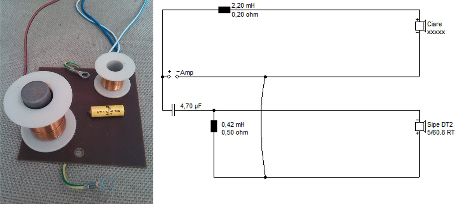

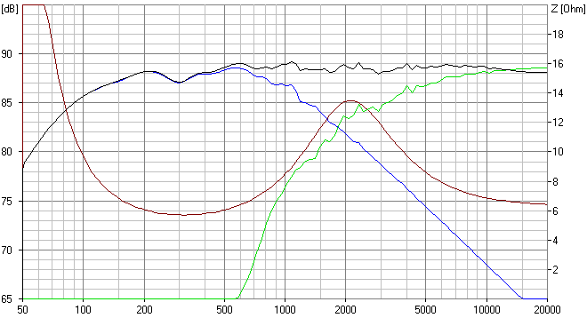

I have another proposal, build a crossover with less phase distortion, see:
attachment.php
...cut...
This will sound thin because of a deep and wide off-axis midrange gap (slip tweeter plate under woofer basket as far as possible in order to reduce distance) but also more impulsive because of less phase twist (and, if the amp is weak, because of higher sensitivity).

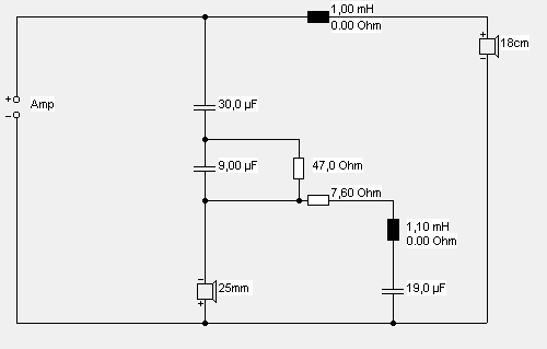

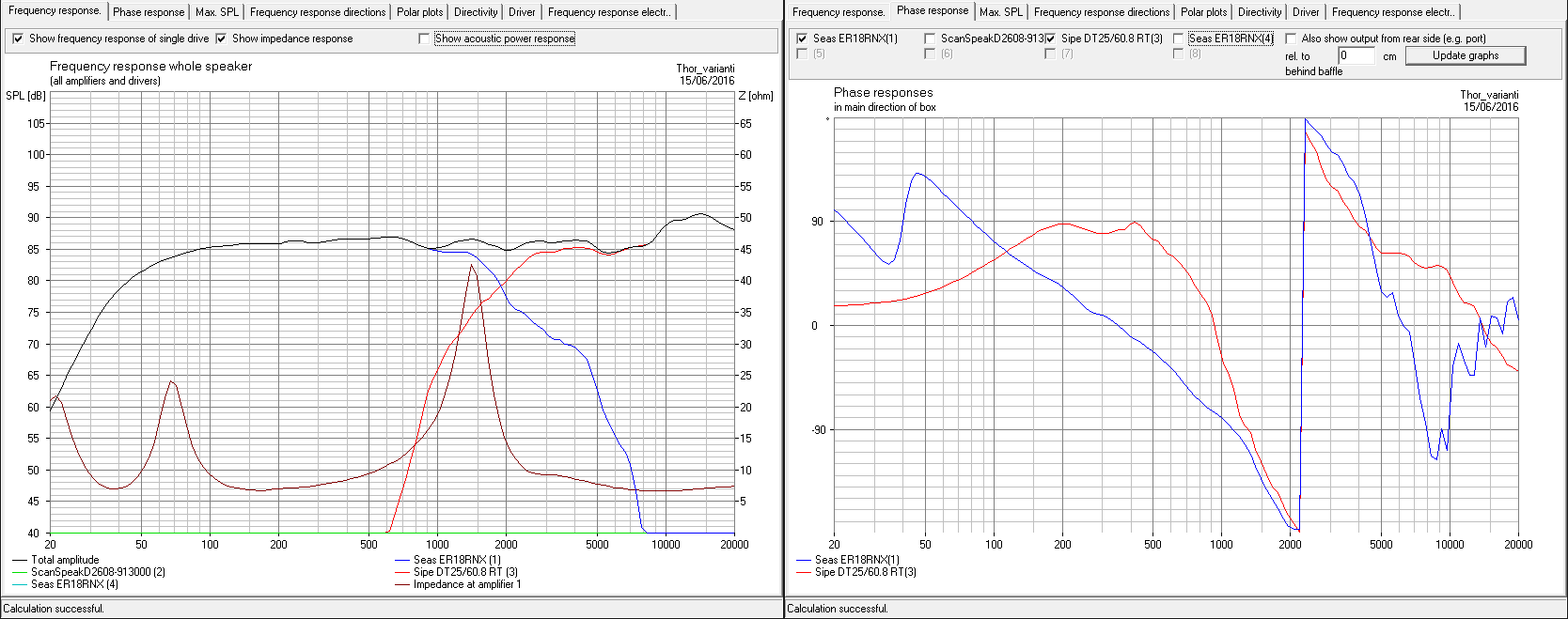

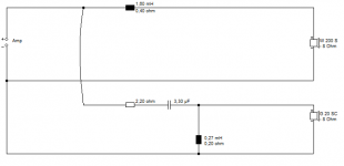

Excuse me Grasso789, I gave a try but there are some issues I can't explain, in response and in phase while directivity is about the same, you might have used different drivers. However my question is: does the off-axis improvement you said (deep and wide off-axis midrange gap) depend by filter order (1st) or by the change of the cross-point? As I understood from all these replies cross-point is the only factor which can affect the off-axis response..have I misunderstood?

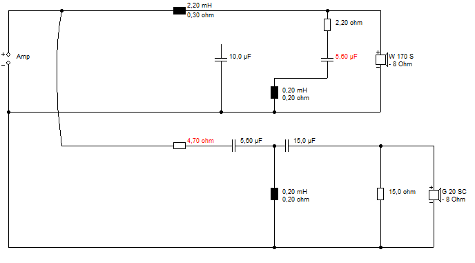

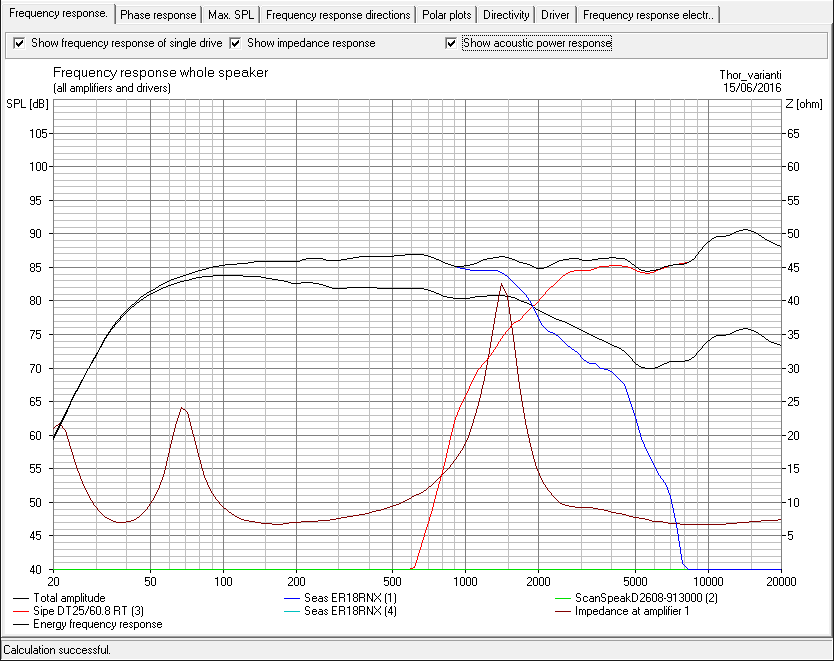

Here's my simulation (dotted my previous version):
Are you trying to get a flat power response? This does not sound any good, and also gives a rising response on axis that will oblige you to listen off axis.
What i personnaly do is similar, but with a monotonically falling power response similar to usual room curves used for dsp room correction.
Btw, the values of the components a very unusual. All the xovers used for similar designs use similar circuits with similar values. There's a nice collection of them at Troels Gravesen website to tweak/hack from. Nothing new under the sun...😉

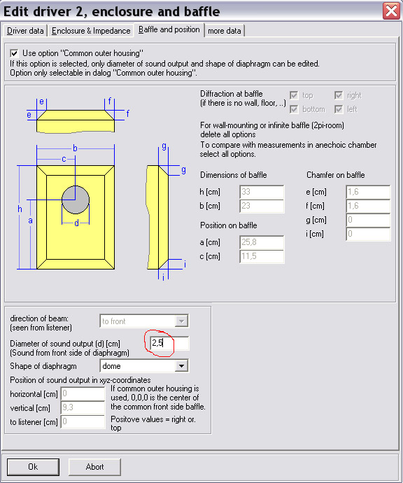

It is also critical to enter a realistic value for the woofer offset in order to get a realistic phase tracking too...

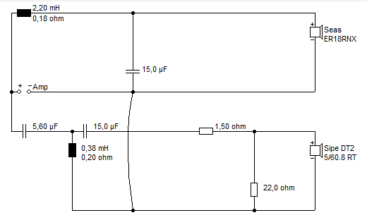

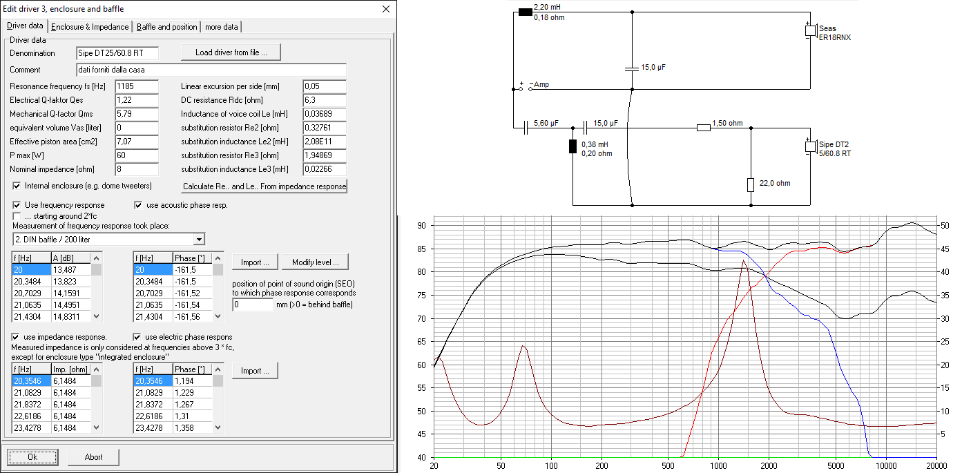

For the tweeter, add a series resistance and play around with values of the other components in order to give it a flat passband response and to reach my goals, which are * not too much level at and below fundamental resonance (else, it overloads) but * same phase for woofer and tweeter around and above crossover point. The woofer would profit from a resonance drain at 4500 Hz, of same topology as the one for the fundamental of the tweeter.
