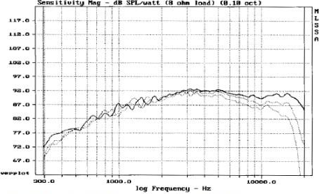

Hi, as wavelength shrinks to a certain size, a diaphragm of fixed size starts to beam. According to Boxsim, a round diaphragm built into an infinite baffle and with flat on-axis response has halved output power, say -3dB, when wavelength is twice of diaphragm diameter, due to beaming. That is what the woofer does in the midrange, where we put a lowpass on the woofer in order to cross to the tweeter. Now if we align the loudspeaker for flat on-axis response, output power has been reduced by beaming but rises again, when the tweeter sets in. This is what GDO dislikes. AllenB thinks, that early reflections are as important as output power is, as we can distinguish sound reflected just once by ground and ceiling from the fuzzy reverb tail reaching us later.
Btw, not all cones/domes behave the same above their pistonic range, and that's what makes simulators like Boxsim of limited ( theoretical) interest when it comes to model directivity.
In the case of woofers many of them behave as if their effective diameter were decreasing with increasing frequency, making the DI lower than predicted. All full rangers behave like this, and this helps to get a smoother transition to the tweeter, as well as allows to cross higher.
These are generally cones made of paper ( with all sorts of treatments...), or polypropylene, and have a clear rising response above 1khz which kind of extends the bafle step range. As this paper nextel coated 8' from SEAS:
Metal or ceramic cones have a much clearer pistonic behaviour and instead of smoothly rising their breakup zone is weird and unusable. As this aluminium 7' from SSpeak:
