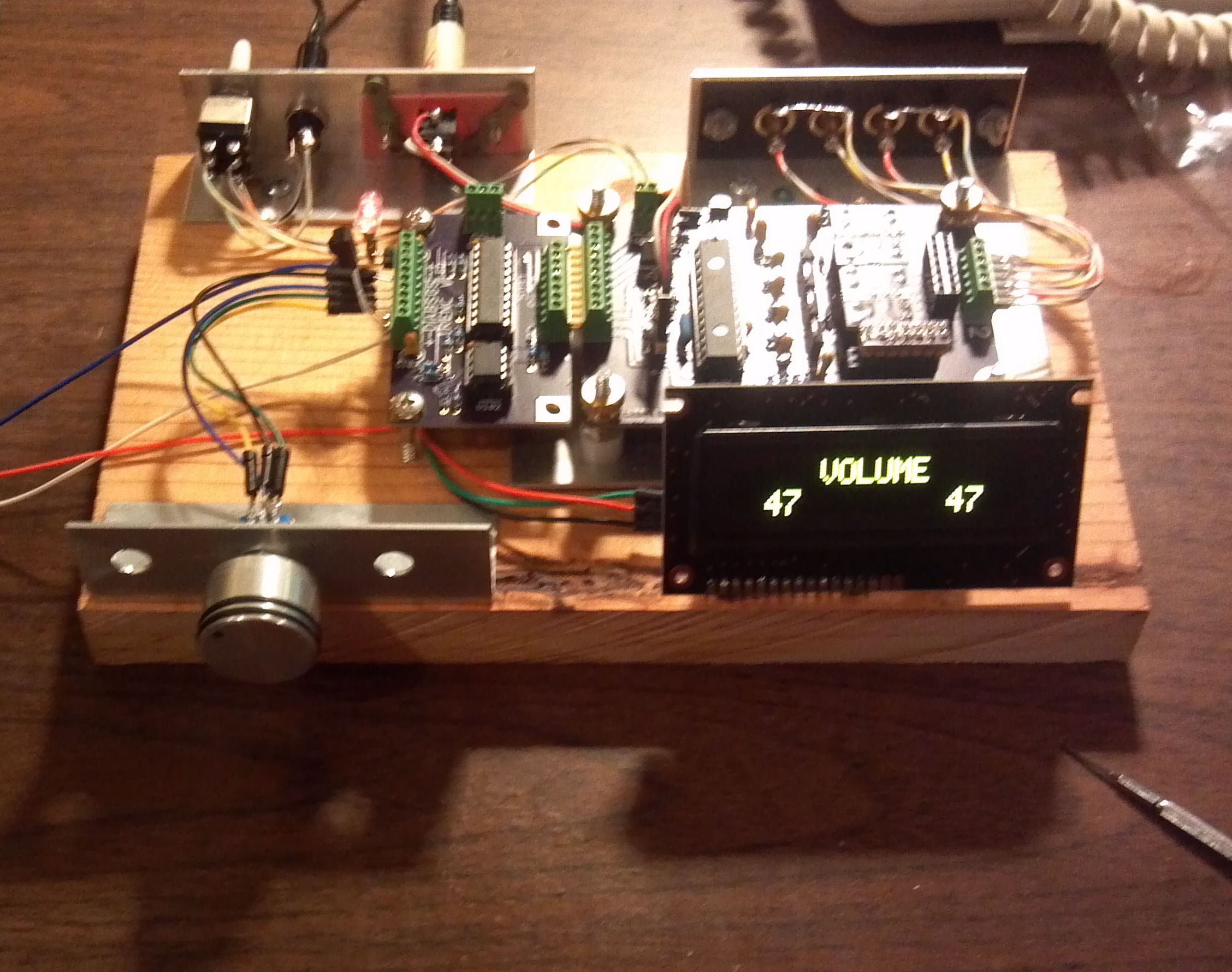

It's late but thought I'd just post a picture of what is pretty much the final pre-production board. I added a pull-down resistor and removed one of the same.
Now provides the control features I want -- control via I2C for IR and encoder and direct connection for potentiometer control. Motorized potentiometer is also possible for someone wishing to add a remote to their existing amp. The remote control board can be used stand-alone for back-fitting.
Works perfectly with older version of software, new software is much improved but has a glitch or two to clear up.
Picture is of latest test jig with all the parts needed for a full preamp. Sorry about the glare in the picture, it's late.

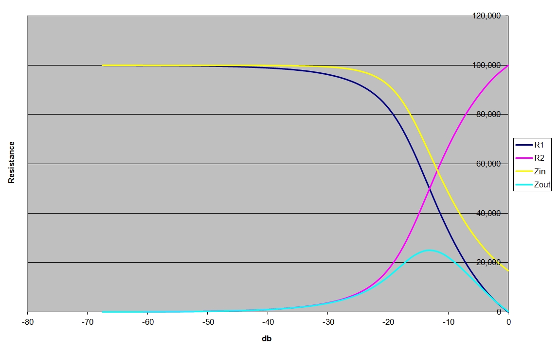

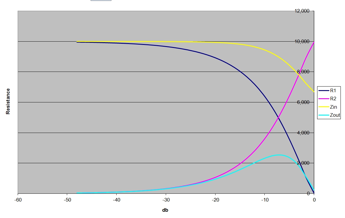

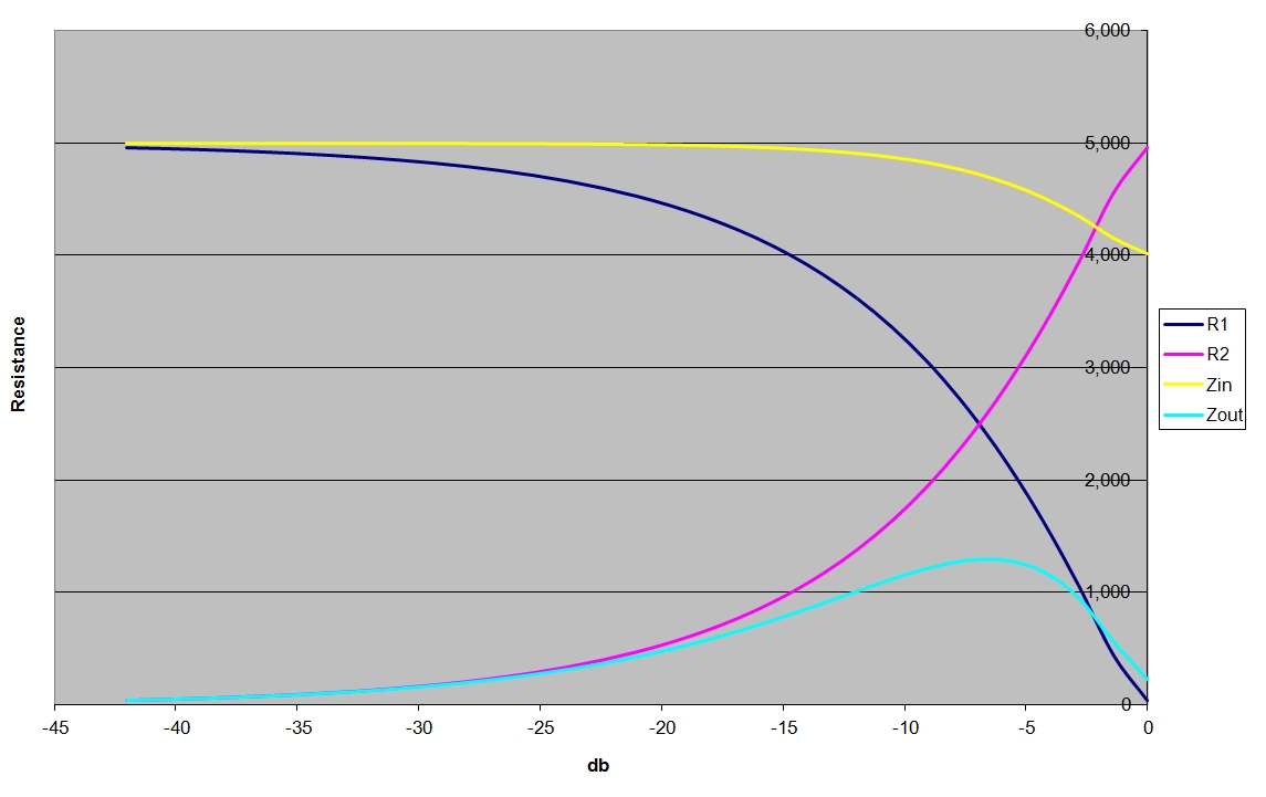

I've got my main board to the point where I can consistently program it to imitate any value pot I choose (with bottom end always starting at 40 ohms) and I'm going to install PICs and LDRs in two more boards to be sure that my methods work across several samples. When they're all working as expected it'll be time for that beta testing. So far I've played with 10K and 100K pot values and they seem to perform as expected with a maximum current of 10ma to the shunt LDRs and 2ma to the series LDRs at maximum attenuation and minimum attenuation which provides a respectable 48dB of attenuation at 10K and a good 68dB at 100K.
This morning when I turned the board on in a rather cold room the pot value had shrunk from 100K to 65K at the high end. This phenomenon does not affect channel-to-channel tracking nor does it affect in any appreciable way the lower half of the range that predominately controls attenuation so I'm not too concerned.
However, I don't know enough about how the difference between 100K and 65K might affect the interaction with the input impedance of a real-world amplifier to understand the implications in that regard -- either as immaterial or important.
Could some knowledgeable person or two please comment on what kind of impact that might have on the sound? I guess it is a characteristic common to all LDR-based pots and I haven't heard of any complaints over the issue. I just thought I'd ask.
BTW, for purposes of calculating R1 and R2 at various attenuations I've settled on assuming a 200 ohm source impedance and potvalue x 2 for the theoretical amplifier load (20K amp for 10K pot). If I've got it really wrong would someone please say something. Thanks.

I'm not quite clear about this part for purposes of calculating R1 and R2 at various attenuations, I've settled on ... a potvalue x 2 for the theoretical amplifier load (20K amp for 10K pot)
Not sure if this says the (amp) load has a 20kR impedance for the middle curves, yes?
Assuming this is correct, worst case Zout of the unit is about 2.5kR at about -8dB attenuation, again generally outside most 'normal' operating conditions, and nearly meets the 10:1 ratio anyway.
Input Z (max) about 2.5kR, so well above that 10:1 ratio.
If IRC (my very faulty memory) for a higher load impedance, say 100kR, this will push up the impedance shown to the source, especially at that 0dB point, and a similar thing happens when the source Z is also lower, but would be interesting to see this plotted accurately (source Z = 10R &/or 100kR amp load) with the same 10kR attenuator settings (as per middle plot above)
I think the 10kR version this will suit most people, me included.
IMO, 40+ attenuation should be more than enough in a home system if the other unit gains are reasonable - one of the curiosities of that Warpspeed version is that it has an amazing range of attenuation but again, rarely needed, so ...
Oh, yes. I remember that a number of those digital amps have an input Z down in the 3kR region, so this could be a problem - does make it a significant characteristic of the source to supply the necessary current but doubt it's a problem for the ldrs themselves ...
If one chooses a 1:10 ratio for Rs to Rin then we choose a 10k pot for a 1k Source impedance.
That 10k pot has a maximum output impedance of ¼(Rs+Vol pot) = ¼(1k+10k) = 2k75
The next stage needs 27k5 to match our target 1:10 impedance ratio.
If we take it as exactly 30k for Rin then when the vol pot is at - infinity the Source sees 10k
When the vol pot is set to -0dB, the source sees 10k||30k = 7k5
The impedance seen by the source changes with the setting of the vol pot.
This is normal.
If the "Wapo attenuator" does something similar then it would APPEAR as "normal"
But the reduction of 100k to <20k is not normal. That is too much of an impedance change.
In my opinion R1 (for the 100k) needs to be much higher.
James, those three graphs are all three based on 200R source and 100K amplifier input impedance per your earlier specification. These charts are customized that way, they do NOT represent my arbitrary decision to plan LDR control around the AmplifierLoad = PotValue X 2. And if that arbitrary standard is off base, I can easily change it to whatever is appropriate.
