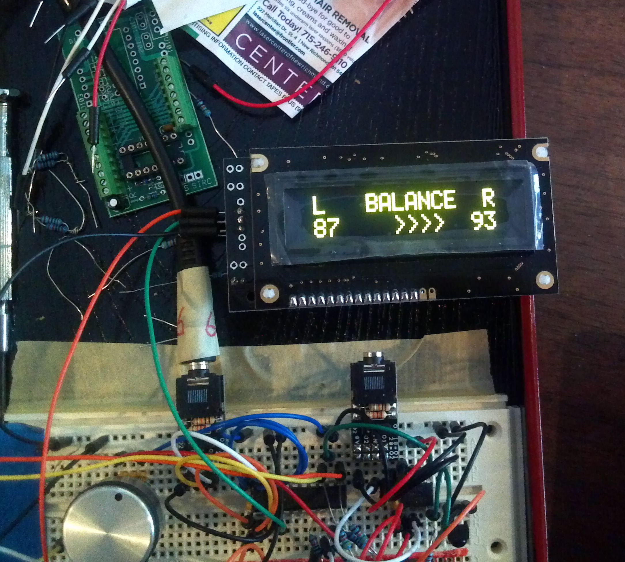

I think I have most of the software sorted out -- everything works except the display. That's next and is the last major component. Now have the LDR controller board, an IR & rotary encoder board, an IR & motorized pot board, plus LDR daughterboards. I think I can use an off-the-shelf OLED display if I can make certain issues go away with software . . .
This morning I woke up and figured out how to make the rotary encoder behave like a ballistic mouse -- nonlinear action. If you click it once, you move one count on the volume control. If you click it twice in a row, you move three counts, and so forth up to a maximum of nine counts. So from the same encoder you can get one count resolution (about .25 db) at a time, but if you want to move fast you can move about 10 db with one continuous twist of the knob. I was wondering how I was going to handle that . . .

Very cool idea about the variable step encoder, I don't think I've seen that done before. Might I suggest a slight variation:
A user may want to change the volume 1 step at a time, but several steps, maybe even back and forth and might find the 3 step jump undesirable. Would it make more sense to alter the step based on the speed of knob rather than just the second click? If the user wanted to change 1 step at a time, rotate the knob at a "normal" rate. If they wanted to go down fast, rotate the knob quicker. The faster they rotate, the higher the step. Just a thought.
That suggestion seems more like some other digital steppers I have (a very little) experience with.
A slow turn gives very small steps.
A fast turn gives big steps.
A change from fast to slow turn begins with big steps and reverts to small steps when the "speed change" is detected.
Well, your thought is right on, and it is where I headed first when I realized I needed to do something like that. Looked around, asked around, the answers I got were that any solution would involve measuring time betweeen clicks and be complicated to code.
The solution I came up with took about ten minutes to write and debug and involves maybe four lines of additional code - a simple, elegant solution in a sea of complex ideas. Unless someone shows me a different real-life working solution, I'm sticking with this.
Anyway, my solution does have a timing component -- as long as you turn the knob deliberately, it stays at .25 dB / click but, if you speed it up, it increases by .25dB at each new click so at the end you're moving quite rapidly. But to activate the increasing steps you have to move pretty fast between clicks. Casual rotation will keep you at .25 to .5 dB per click. I need to try it out for a while to see how well I like it.
Originally, my volume control had about 1000 steps -- .06 dB per step. When I tried to use it, I found that it was worse than pointless -- I could not take advantage of such resolution, and it took forever to change the volume in a meaningful way. So I made it 250 steps, and that's about right. Nevertheless, a .25 dB step is well below audible unless your system has crazy high gain, and this solution is not over reactive. You can still get .25 dB per step if you're deliberate, but you get an audible change with a serious twist of the knob, and you get a really audible change by making an effort to do so. It's pretty good, I think. 🙂
That's a reasonable solution, as long as there is a timer to differentiate between fast and slow movement of the knob. If it were possible to further refine it as Monte McGuire suggests, that would be a definite improvement and add true speed sensitive ratio to the step size.
I started by increasing by one count for every continuous click up to nine, and it was inconsistent because it was hard to get the rotation consistent.
I changed my approach to increasing by two to a maximum of six -- 1, 2, 4, 6,6,6,6,6 . . . etc.
Any unrushed rotation keeps the rate at one count per one click, and anything even slightly intentionally faster rapidly increases to six counts per click. Works well, I'm sticking with that.
That seems to be what my car stereo does. If you turn the selector dial fast, it jumps quickly, maybe 5-10 steps per mechanical click, and then when you turn more slowly, it goes back to 'normal', one step per mechanical click mode. This helps to slew through the 100-200 channels of satellite radio without thinking too much.

Got a display working -- it's a two-line OLED which can display Volume, Balance, and Mute information.
