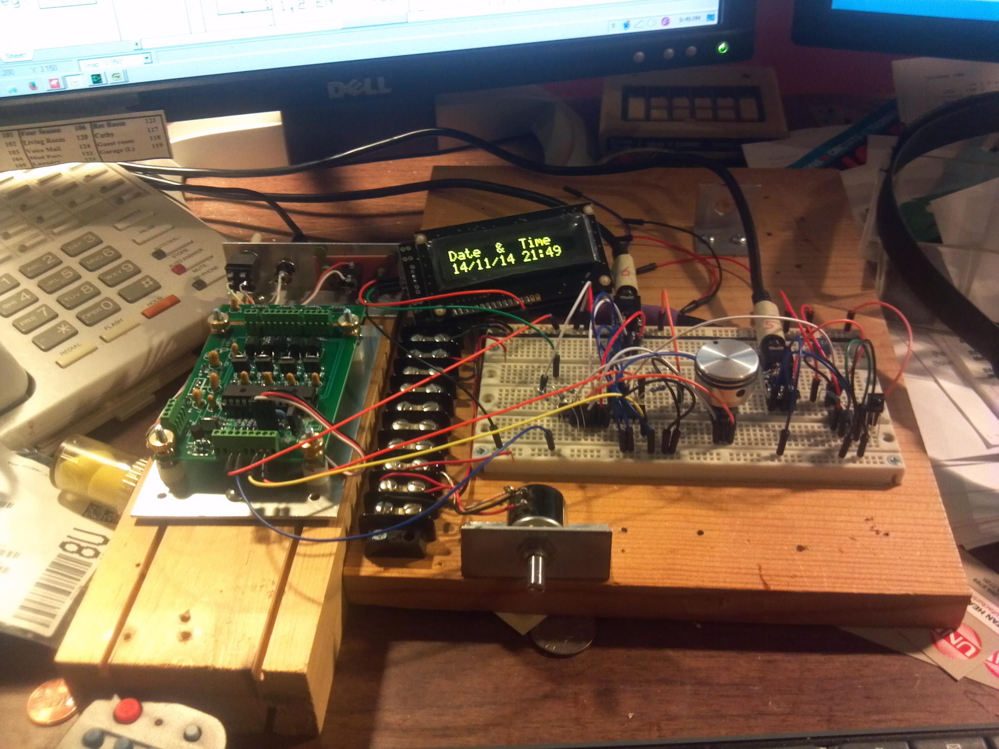

Making some headway now. For several weeks I was immersed in multiple new subjects -- IR control, rotary encoder software, controlling an OLED display, I2C communication -- and it felt like I was getting nowhere with anything. It all began to come together over the past few days, and now I can see forward.
Right now I've got the IR and rotary encoder working together and cooperating via interrupt-driven code, I've got the control chip talking to the OLED display, and I've got the LDR board responding to I2C commands from the controller that will be the heart of the system unless the LDR board is used by itself.
The LDR board can be a stand-alone with pots controlling volume and balance, or under remote control with a choice of IR plus pots or IR plus rotary encoder and display.
The picture is of the breadboard setup -- you can see the rotary encoder knob in the middle and the IR receiver at the extreme front right, the OLED isn't doing much yet except telling the time. But all that stuff is talking to each other and that was the hard part.

I'm not sure what language you are programming in, but a simple encoder routine written in 8051 assembly is attached. KNOB_I is the input from the encoder that is the steady state. KNOB_Q is the one that pulses when moved and either leads or lags the other in polarity. I and Q are bit locations that store the current values from KNOB_I and KNOB_Q respectively. MIN_VALUE, MAX_VALUE and CURR_VALUE should be self explanatory.
The only other thing you have to do is initialize the value of bit I (from KNOB_I) at power up reset.
The code resides in your main loop, it does not need to be interupt driven (unless your main loop is exceedingly slow).
