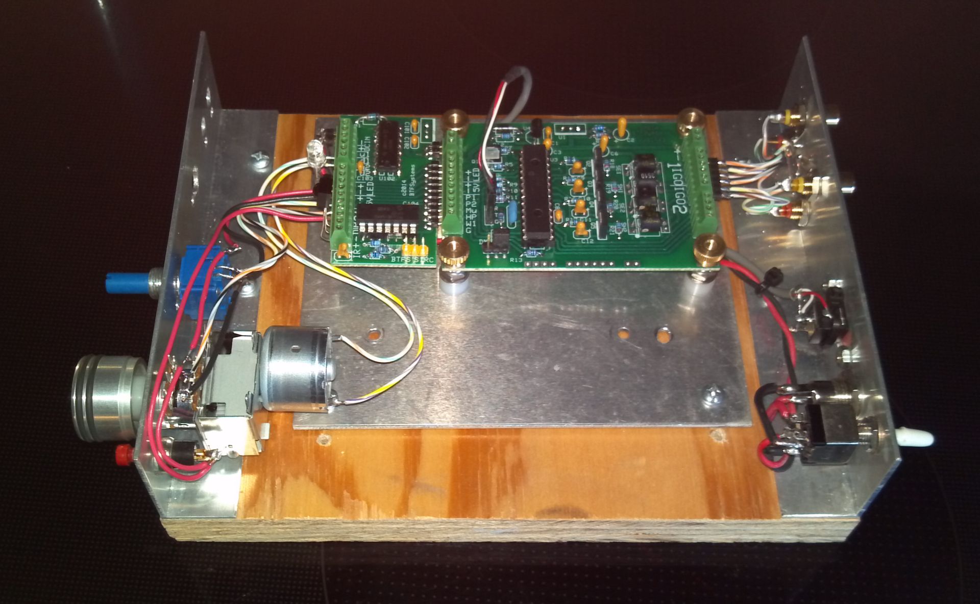

Over the past few days I've been working on making my external excel calculation tables more user friendly and accurate and matching them better to the way I use LDRs on the board. That part is done, and things are much better.
I have settled on a minimum resistance value for shunt of 40 ohms and a minimum resistance of 90 ohms for series. I will design the circuit to drive to a maximum of 10 milliamps but will select shunt LDRs so that they do not need that much current to achieve 40 ohms. Ergo, non of the LDRs will ever see 10 milliamps of drive in real life.
If my math is right (and no guarantee there!) 40 ohms shunt and 9960 ohms series should give me 48dB of attenuation. I hope that's good enough. Making it a 50K pot with the same 40 ohm minimum shunt it looks like a 61.5dB attenuation. If I've got this wrong will someone please point it out.
So far I've only checked ohmic accuracy indirectly using the chip, but it appears that at 40 ohms I have 1 ohm accuracy and at 10K ohms I have +/- 100 ohm accuracy most of the time. I do note that accuracy at 10K is best when the LDRs have been on for a while even at very low current. I think I would recommend that this circuit never be turned off, only "muted" which will be achieved with 2 milliamps to shunt and zero milliamps to series (about 85 ohms for shunt and 1 megaohm plus for series).
The second thing that's occupied me is value overflow at the extreme values of the pot when the 16 bit "word" I'm using is exceeded at either end and the chip wraps the value around to the other end of the value range. That's now fixed and I cannot find any problems with operation in either stereo or dual mono modes.
Next step is to replace my manual test pots with the two motorized pots I got from Mouser (which arrived without the mounting hardware that should have been there!). I had a choice -- almost $10 per nut purchased through Amazon third-party, or $5 for fifty pieces from Hong Kong. Guess which one I chose?
The temporary (without hardware) mounting of the pots won't look pretty but I hope by this afternoon I will be listening to my board for the very first time and and controlling it from across the room.
This is working (?) prototype #1. There wasn't enough space to motorize the balance control without a lot of hassle because the motor interfered with the IR card so only gain is remote controllable here.
This is not the final board design which will have the calibration circuit on the main board so no separate calibration board will be required. Also, the IR board will be connected to the main board with identical screw terminals so the IR board and the LDR board will be at the same height, and there are holes for standoffs at the front of the latest IR board for better stability.
I ran computer-controlled tests earlier and the numbers were excellent, now it's time to see if the numbers translate into good sound and hope to do that tonight.

Looking forward to your results; have you another LDR attenuator on-hand to compare your's with?
No, I don't have other LDR attenuators to compare to but James Hill appears to have several so I'm hoping he'll be willing to take that on. In fact, I don't have anything remotely like Golden Ears that I would trust to accurately discern subtle differences between LDR attenuators if the external factors are kept identical.

So, I tested the board. Actually, I just wanted to know if it worked and didn't much care how good it sounded, so quickly kluged together some stuff I had lying around -- speakers were modified dynaco A-25s (a very mediocre speaker) from 30 years ago, the amplifier was a chipamp that I had built a few years ago, and the source was CDs playing on an old DVD/VHS playback unit that hadn't been turned on in four or five years.
Results:
1. It works. Not perfectly -- I still have problems with the code because when the volume is turned almost all the way down the music suddenly gets very loud. I need to figure that one out and fix it. Also, I had to jiggle a wire to get the IR working but that was just a loose wire.
2. But the sound amazed me. I could not believe I was listening to crappy A25s. Some CDs sounded like they were recorded with too much treble boost, but some CDs sounded wonderfully more transparent than I had heard them before. I hate to say this because it'll sound phony, but the sound was noticeably clearer -- I could understand lyrics better than usual and some instruments had nuances that were new to me but sounded appropriate. I played parts of about fifteen CDs, everything from Air Supply to Yo-Yo Ma solo cello. Very nice, rather more treble than I am accustomed to hearing but there were no tone controls in the circuit and the A25s are not noted for bass. I think I was hearing the system as it truly sounds including lousy op-amps in the CD player and substandard bass from the speakers and everything. I won't say it turned my speakers into Magnepans, but while I was listening one of the thoughts I had was this system sound had moved somewhat in the direction of the full size Magnepans I listened to about a month ago.
The volume control was mostly at 12~3 o'clock and the level was quite loud; at lowest volume the level was very quiet but not silent. I did not try mute, I forgot to do that.
All in all, satisfied with the operation with caveats, and delighted to have found the pleasure of listening to a system with LDR controls.
Tomorrow back to work to figure out why the volume spikes high at minimum volume setting, that's the only remaining issue, I think. After that, connect it to some better equipment and do some extended listening.
All in all, good news, I think.
James, to answer your question re the plus and minus near the output terminal block, that was part of the circuit for the outboard calibration board. Since the calibration components are now all on the main board, the only terminal block at that end will be for the input and output wires for the audio -- one six screw terminal block.
The mute function is entirely internal to the PIC -- I simply command the shunt LDRs to be driven to about 90 ohms and I turn the series LDR power completely off and they go to above 1 megaohm. No external relay operation at all.

The problem with the jumping gain turned out to be in the balance control code. All is well now, smooth as silk from min volume to max, and the balance control works exactly as it should. FWIW, when I 'slam' the pot from one extreme to the other, it takes about two seconds for the sound level to get to the new setting. So, I think the pot's rate-of-change will not be a problem at all in normal operation.
With the system I'm using it in now, at max volume it's a little too loud for comfort, and at min volume it's at the very low end of quiet listening. Muted, I can still hear the music if I put my ear up against the speaker, but in the room it's silent.
I cannot tell you what kind of gain I have in my system, but I can say that having the volume level go from very low to beyond comfortable as the pot goes from min to max is a new experience for me -- I'm accustomed to a volume control that plays well between 8 o'clock and 12 o'clock and gets scary loud beyond that; I guess my systems have always had excessive gain up until this one.
The chip in the IR remote board seems to have lost some of it's marbles, or something -- it'll decrease volume but not increase it. I need to troubleshoot that . . .
It turned out the marbles were all there, it was operator error. I inadvertently reprogrammed the hand-held remote and when I reprogrammed it correctly, all was well.
