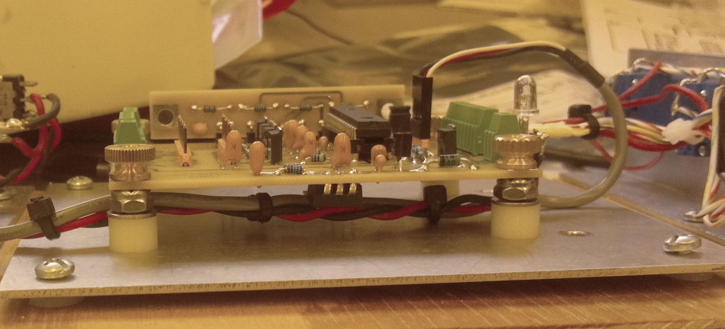

Here is an image of my latest prototype with James Hill's brilliant idea for calibration board storage implemented on the far side of the main board. The pins that connect the board to the LDR board fit into a set of holes that match the pattern.
Thank you, James, it's really useful!
Also note the location of the LM317T regulator -- under the board. The board is diminutive and the ugly 317 towers over it when placed on top. It only gets warm to the touch for about a minute during calibration and does not produce any heat at all during normal operation. It's perfectly safe underneath there. Final production will sport the plastic enclosed version of it -- pricier but no need for insulation of any kind, even under the board.
I tried to save some money by ordering a board without soldermask. Never again! Solder runs everywhere, you can't tell when you've applied enough. It works OK, but I don't like the look -- amateurish!

John Broskie sends out the Aikido preamp kits with small rubber O-rings/donuts to isolate the board from the standoff/screw (1 above the pcb, and 1 below it, 6 places) - I thought it a bit of overkill until I left them off one day - makes big difference - might be worth trying here even tho it seems a bit silly ...
[I found the Sorbathane material washers work better, made out of shoe inserts cushions]
The reason for the mention here is that I've been playing around with the suspension/isolation plate for my usb dac (Ayre Acoustic QB-9) - it's incredibly microphonic and you don't have to be a 'golden ears' to hear the difference in sound with different feet, plated, dampening blocks, etc - I notice a lot of other high quality dacs seem to exhibit this very same characteristic - no idea why a digital format system (dac)would be acoustically sensitive at all, but obviously something else is at work here.
Love that knurled knob on the pcb mount.
